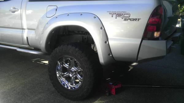

    hey guys,
    i got a 6" procomp db lift and aal/blocks in the rear. Trying to see if its possible to refurb the rear to my current set-up instead on buying new leaf packs. Has this been done yet? all feedback would help.
    thanks in advance.

    Haha, Hi Gary & hey at least you admit the DB lift part....:D
    Take a couple good pics of your current set up & let me see what we're working with & I'll come up with a recommendation for ya...

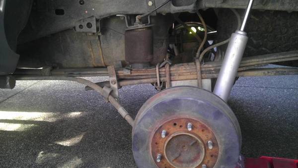

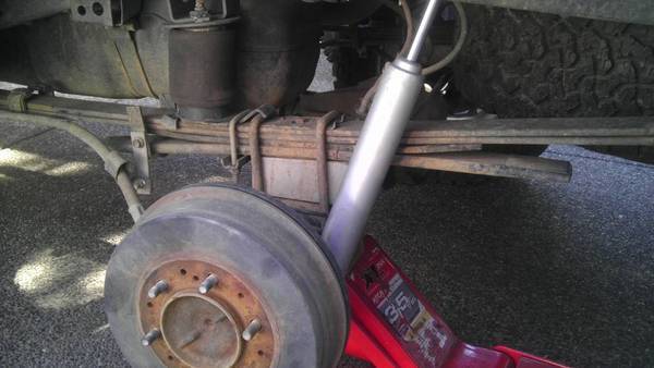

    here are the pics.

    Why are the air springs not a little further rearward and right over the axle?!?

    thats how the air ride ones sit, your thinking about firestone riderites, they sit over the axles. but those will be gone once i get new leafs

    Hey Gary from what i see your leafs are actually not too bad, still have a little ARC to them, get rid of that AAL & put 3 Chevy springs to the existing leafs, this'll get you to about 4". BUT !! You'll have to get a flip kit for the rear shackles & you'll need ext. shackles for the 6" you desire
    It may not even get quite 6" but it'll be close
