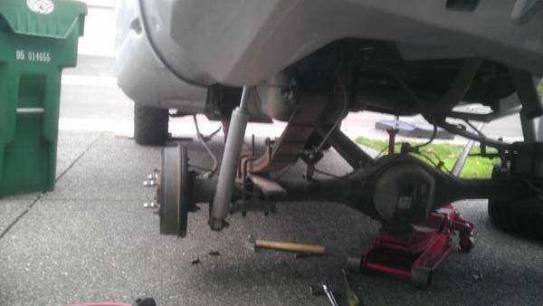

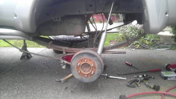

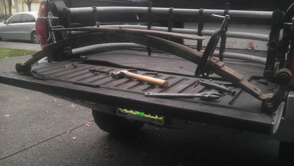

    Doug,
    i finally started my leaf packs, got some donors off a 78 k5 blazer. so when i started the second stock leaf was bent, so i just pulled it. now my current leaf is made up of the main, 3 chevy and the stock overload(for towing my boat). does this sound right? plus i installed a shackle flip kit.

    Hi Gary,
    The Blazer was a good choice, recently built some springs for a member using some off an '81.. got excellent results...Your config sounds like you'll be alright with that, POST some pics when done dude ...:thumbsup::thumbsup:

    doug,
    can i remove the overload spring and replace it with another leaf? i only tow the boat during summer months

    i don't think you'd need the overload.

    I was thinking the same thing. I was thinking of just adding another leaf for the extra weight. but on the other hand i dont want it to be too stiff

    Sure, most guys that do this MOD dump the overload, the only time I say not to is if you tow anything fairly heavy/& often....;)
