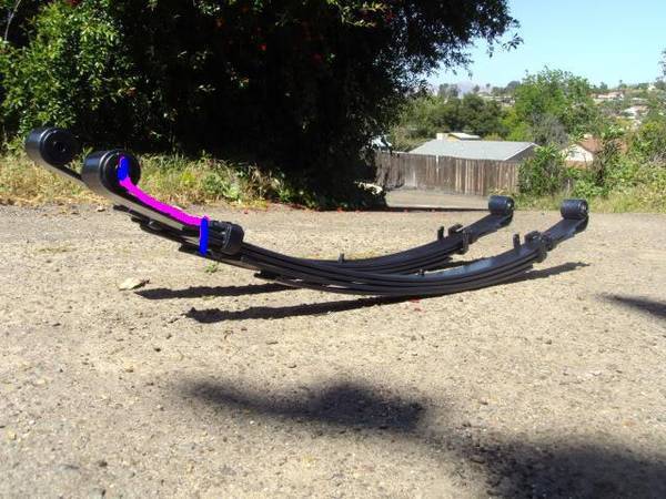

    Yeah Sean , I try to keep the secondary leaf as well but this whole process is key on re using the main leaf for sure.

    As long as the 10" from eyelett of main isn't actually bent, they're rebuildable see pic...
    that would be the area colored in violet, blue marks are star & end points for determining it

    i'll have to look again, but I think that part is fine. Last I looked it seemed like the front half of the pack is going upside down.

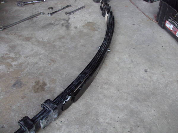

    did you guys put an anti-friction pad at the end of the new leaf that was added? ive been wanting to do this but dont want it to end up squeeking

    Your pretty much on target Sean, unfortunantly most all the AAL's are like slapping one POS on top of another, in fairness to Toyota I like the soft sprimg for the 1st inch of compression & thats it, they turn to mush after that, that was when my brain farted into action with incorporating that initial soft inch with the addition of some truly upgraded springs/steel for the results I've been getting
    heres a crappy pic but my front coils are set at max (2,5") & 3 " lift in rear

    THIS
    OR THIS
    Thanks Frank:D
    Yeah I add some anti squeeks too just waiting for Chris to come back in a day or 2 so I can re torque U bolts, I'll add them then

    u can get them from an auto part store correct? Don't u also put some thick grease in between the leafs as well?

    Yeah pretty sure you can, i dunno about the grease, seems it'd be ok for a bit but soon it'll start picking up dirt & STICKING, possibly working its way in between leafs.
    What I've been using is the sidewall off of a wheelbarrow tire, no shit... works like a dream, just cut into small pads
