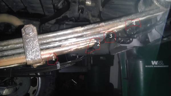

    the current set up is 1,2,4 are the 3 chevy springs added, #3 is the second yota spring i had to cut. Instead of taking a chevy spring out, shouldn't i just remove the second yota spring so the leaf pack is all sequential?

    Ahh I can see why your ride is like shit.. You need to trim those donors back some more, looks like no.#2 could use another 1.5" trimming off the end & while your at it maybe dog ear (infamous diamond cut)the ends that go to rear shackle, rule of thumb is at least 3.5"-4" between leaf ends..

    that would be right, if i didnt add the 2nd yota leaf(#3) dog ears on #4? why so?
    my first test on without #3 felt good, but my dumbass decided to add the second yota spring before i finished up everything.

    This gives ya an idea anyway, but if it felt ok to ya without the 3rd then I'd dump the 3rd. You still got lift out of it correct ??

    As far as dog-earing the ends , it's supposed to take a little harshness out of a stiff spring . (less steel on ends means less compressional force to cycle the leaf(s)..

    yes i still got the lift needed without the 3rd, actually as we speak i have a rack with the 3rd.
    as for your pic, did you just grind down the ends on the 3rd and 4th?

    No, those are progressive springs in this order
    1. -main
    2.-progressive
    3.- Linear
    4.-prog.
    5.-prog.
    The Linear spring is dog eared facing the rear shackle

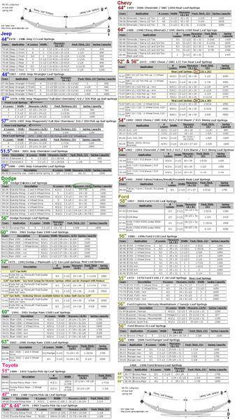

    Doug, Have you found any magic number for thickness of an individual leaf? Looking at the tables would indicate somewhere around 1/2 inch if I allow 1 inch for the overloads.

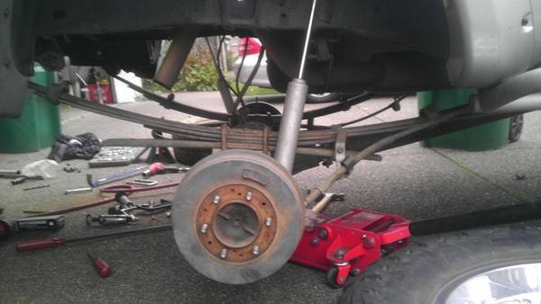

    i took out the 2nd yota spring and it rides waaayyy better. i didnt do the dog ears as i was short on time. would it be a good thing to do the dog ears later?
    before and after shot.
    front is with aal/block vs rear omd refurb. with shackle flip

    Hi Rick long time man how ya been ?? No real magic number & I'm not 100% on that spec. sheet , theres a few discrepincies in it, 1/2" is too thick IMO....:)

    Good to hear Gary !! ARC looks right & if you're happy with ride I'd forget the dog earring for now......:thumbsup::thumbsup:
