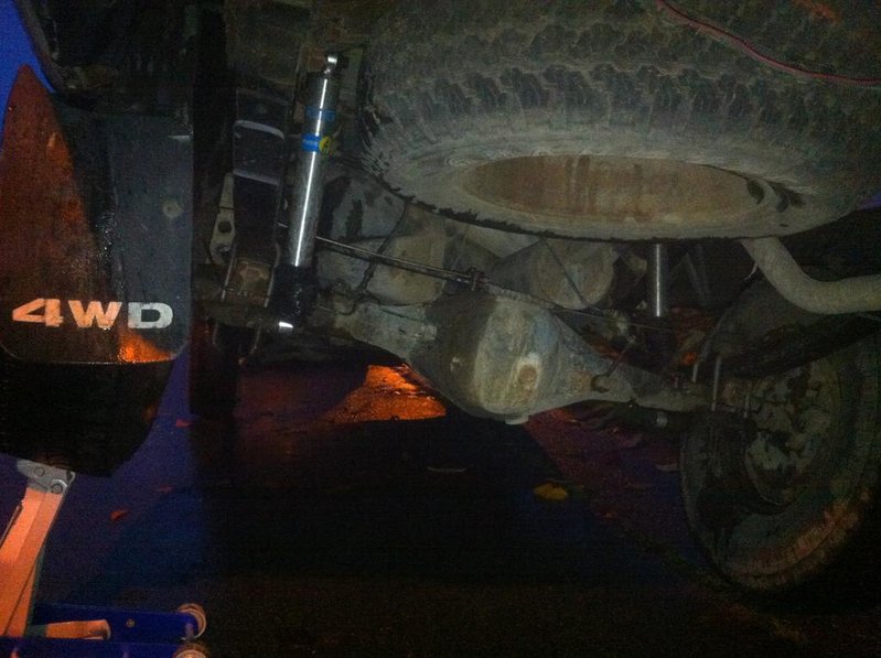

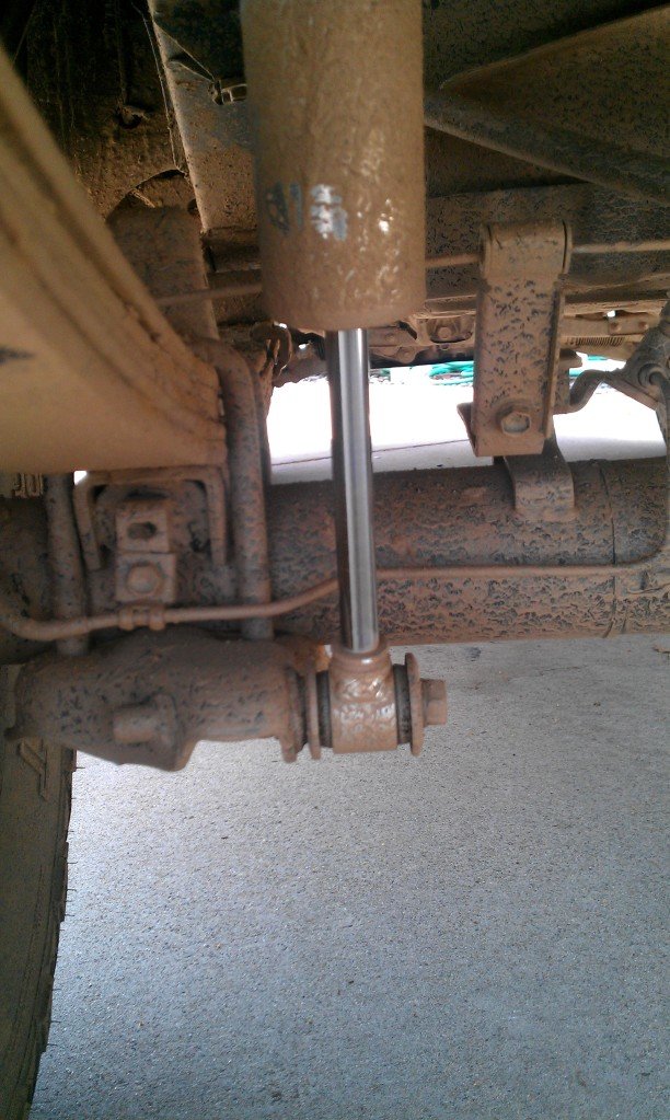

    Hey guys, great great mod! I just added two Chevy springs into my first gen pack, I kept the main and secondary with the mil wrap and then two stiff curved Chevys below, gave me good lift and way improved ride and capacity!
    One question though.
    I bought bil 5125s in 10" rear length as the shop said they would be fine for what I wanted.. As it sits with my lift the struts are half compressed! So I would only have 4-5 inches of up travel, more droop though.
    Will I have to make taller bump stops to avoid bottoming out and destroying the strut?
    Or should I get custom upper strut mounts the make them at wider angle and or higher up? I would like as much articulation as I can from the stock length main leaf. I can get pictures if you would like!

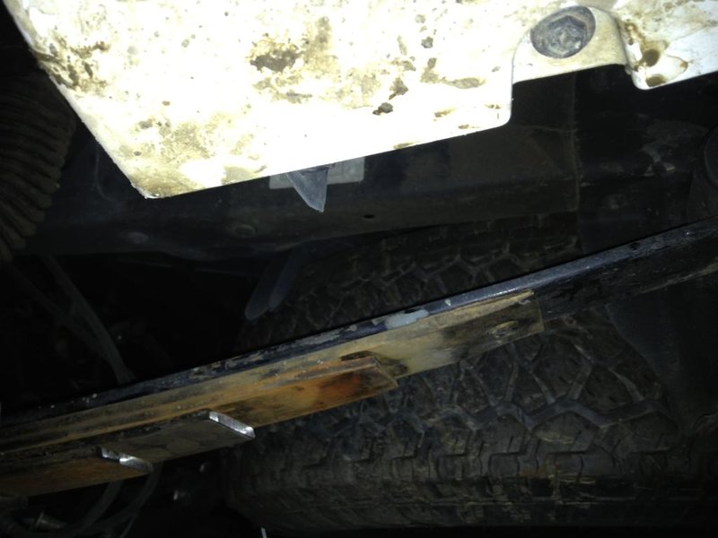

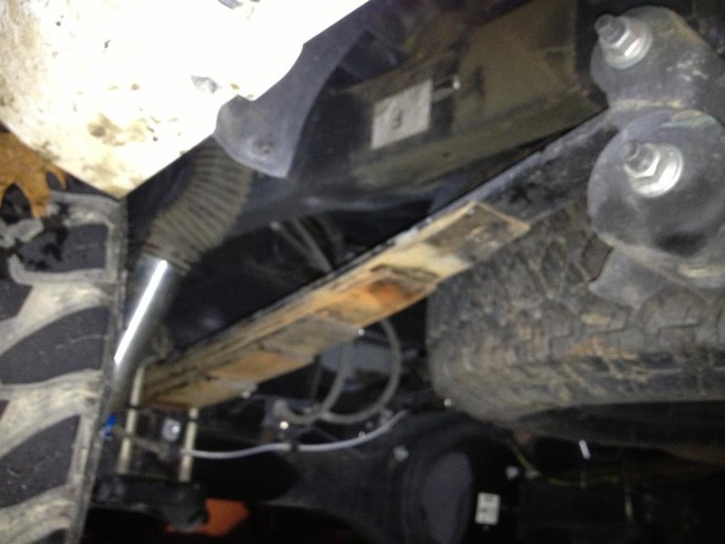

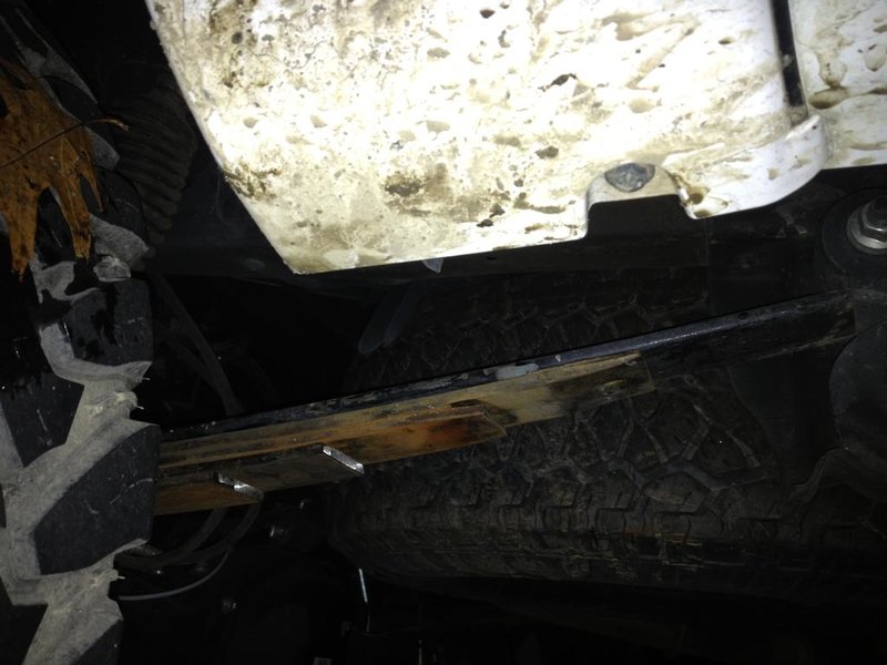

    Here's my shackle flip Doug.

    Can you get a picture? I did the same exact thing, 2 chevy springs and 10" 5125s. I had to get new shocks, the 5125s wer bottoming out. They make 9" 5125s, those would work great.

    Extended bump stops would fix that. That is what I will be doing on mine.

    Yea I'm sure the best thing to do is get the shorter shocks, a waste of another 200$ :(
    But I jacked up my one side rear tire with a floor jack about 1.5' and they still did not bottom out. That gives me hope that with longer bump stops for protection I will probibly rarely bottom them out. My rear end is pretty stiff now though, a waste of a 10" shock though.
    It's not rock crawler flex, and was not designed to be. I wanted a stiffer taller ride for a full load of camping gear and work stuff!
    (There is still approx 1inch+ inside the boot on the shock)
    And about 5inches when sitting level
    Thanks guys!

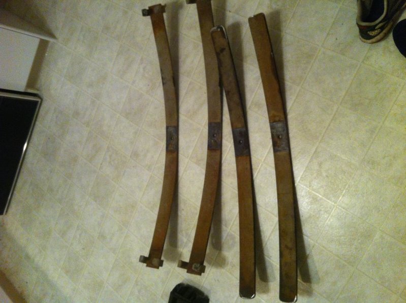

    Just finished the springs for the first round to see how they ride. definitely more stiff but not bad. There are 6 springs total including the stock toyota upper leaf. I have not yet cut the edges of each spring yet either. The donor springs are from an early 80's Chevy 3/4 ton 4x4. The axle wraps a little (probably 1.5 inches up approximatly) on a hard take off. I plan to add some straps to keep the leaves from shifting.
    Some issues I have are:
    The front end of the top donor spring is close to the eyelet and the rear of it is about 6-7 inches from the rear eyelet. Not sure if that will be an issue where the top is in relation to the toyota spring.
    any other criticism to make these better is appreciated.
    Edit: I set the lower leaves to be 3.5-4 inches shorter than the one above it on each end for all the donor springs

    Did you cut your donors equal distance from the center pin hole? Second gens are not offset like first gens. For example, for a 34" donor, you should center off of the original center pin hole 17"s each side.

    You defintely need to take your leaf packs out and cut the longer side down to the same length as the shorter side.
