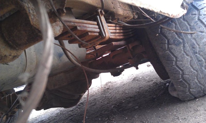

    Doug, is my pack worth saving? Not the greatest pic but the only one I have.
    I'm looking for 2.5-3 inches out back to go with the billies/eibachs i'll be ordering for the front.
    Was gonna go with a dakar pack for the rear but for the price of a refurb I've gotta give it a try. If my pack is good to refurbish then does it matter what model chevy to get them from? Do I keep my main and replace the others or just add chevy springs to my whole pack? Some of these might have been answered in here already so I apologize.

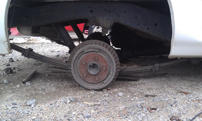

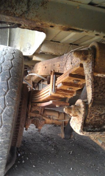

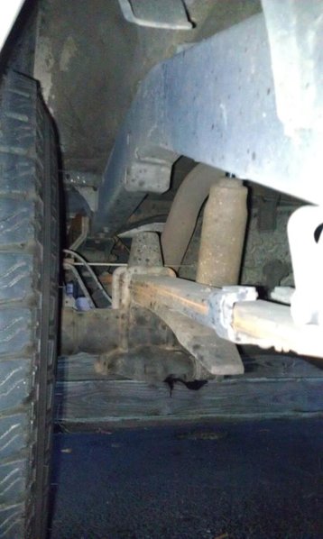

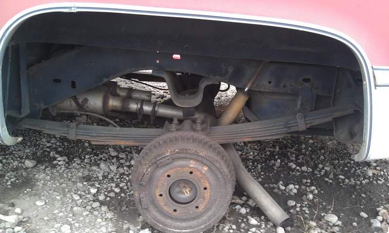

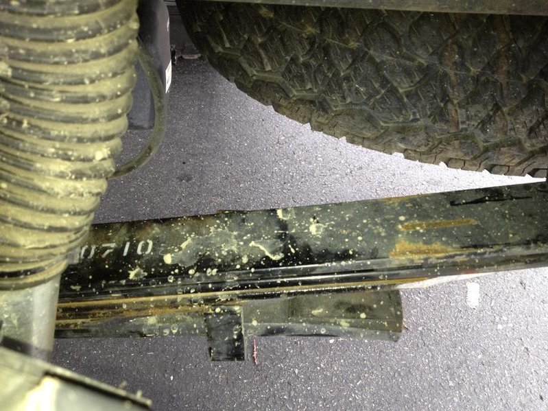

    Went to the junkyard today to take a look around. Took some pics to make sure I'm on the right track before I buy something. How do these look? All are chevy springs. First 3 are 1/2-3/4 ton trucks and the last is an s10.

    from what ive been hearing in this thread, you dont want 3/4 ton leafs because the ride will be way too stiff. the 1/2 will probably be a little too stiff also, but the s10 should work good.

    I used a leaf out of a '76 3/4 ton cut to 33"s and the ride is excellent, much better than stock. Got 2.25" of lift as well:thumbsup:

    Also the only S-10 pack referenced in this thread are the old 1 TON Spring under axle Dually that they used to make...

    Sorry for slow response Jacob, from what I see your stock pack is rebuildable, You can use either 1/2 or 3/4 ton springs as long as they're equal or very near same thickness, a little steel goes a long way.
    see above...:)
    :thumbsup::thumbsup: you get a dbl thumb....:)
    Exactly Chris, I tout the commercial 1 ton S-10 SUA as being the holy graille of OEM springs, still do but in the 2+ years I've been doing this I have only found 1 & i spend a fair amount of time in wrecking yards looking...

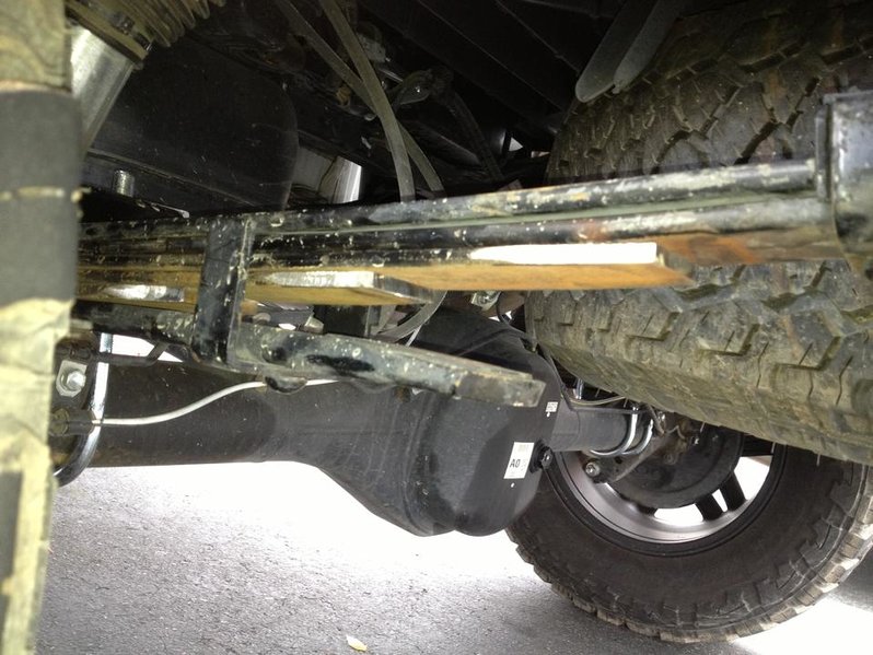

    Finished my springs over the weekend. I put the second stock toyota leaf back in and added 3 leafs. One at 34, one at 24, and one at 16. I also put the stock overload back in so that i could bolt up my E-Brake cable. All added leafs were diamond cut and a new center pin was added. The ride is much better than my first try at the refurbish.
    I was also able to find a used set of OME springs for a good deal that i will be testing side by side with my stock refurbished springs.

    Very nice Scott !!!...:thumbsup::thumbsup: Yeah sometimes ya gotta fine tune the MOD, the good thing about that I've found is the more I tweak it , the better the results, keep me posted with pics & results too, we ALL learn how this could be done better....:)
