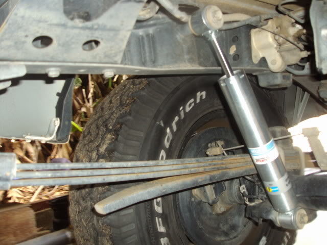

    Old pic right after the 5125's went on.....nice stock leaf pack too...:D

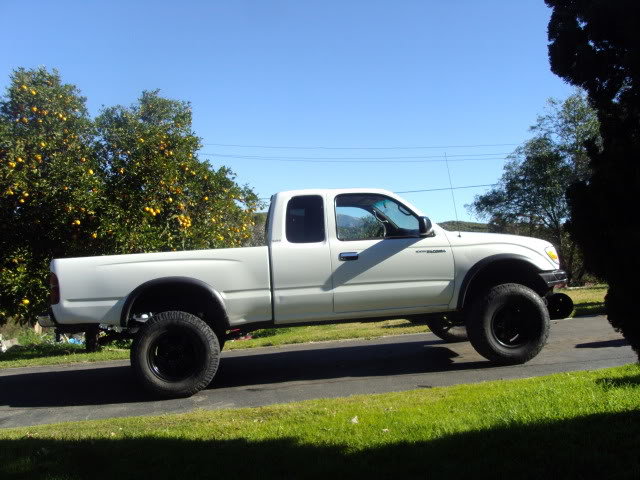

    Thanks man.. I like it better now tho' , I put on some 2nd gen. OME 883# coils so now I'm 3" in front & 3.15" in rear sits just about dead ass level finally...

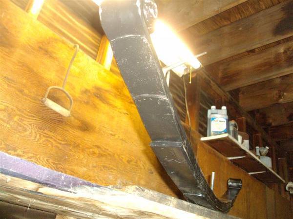

    A progressive spring is thick at the center holes & graduates to thin on leaf ends, a linear spring can be diff. lengths/ or dog eared but they remain linear because the thickness of leaf hasn't been disturbed, now popular belief from manufacturers seems to be to stack a number of thinner leafs onto one another & this becomes progressive, this is not correct & I've sent a couple emails to some un named spring manu. but have yet to hear anything back

    There are a couple good reasons to "diamond cut" or "dog ear" the springs. One is to reduce STATIC and SLIDING friction between the leaves and the other, and far more important is to basically "radius" or break the corners to increase fatigue life.
    And yet another reason to dog ear is to turn a constant thinkness spring, which is normally linear, into a non-linear or progressiver spring. Dog earing changes the strength in bending of the dog eared section of the spring.
    You understand when in use, the leaves slide on one another as the suspension goes up and down.
    The difference in "progressive" and "linear" is that in a progressive spring, the suspension gets progressively stiffer as the load increases, in a linear spring, the spring rate is constant and deflection can be calculated in inches of deflection/lbs of load. We can make a leaf spring in either configuration based on the relative arcs of the various leaves.
