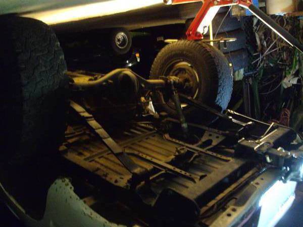

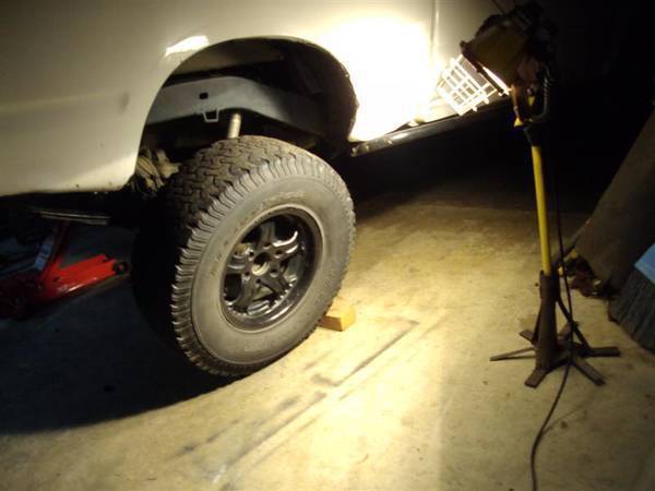

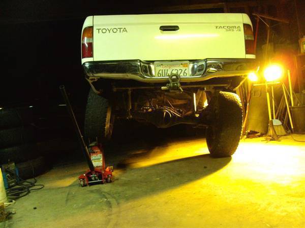

    Doug quit showing everyone how to be unsafe in the garage hahaha:D

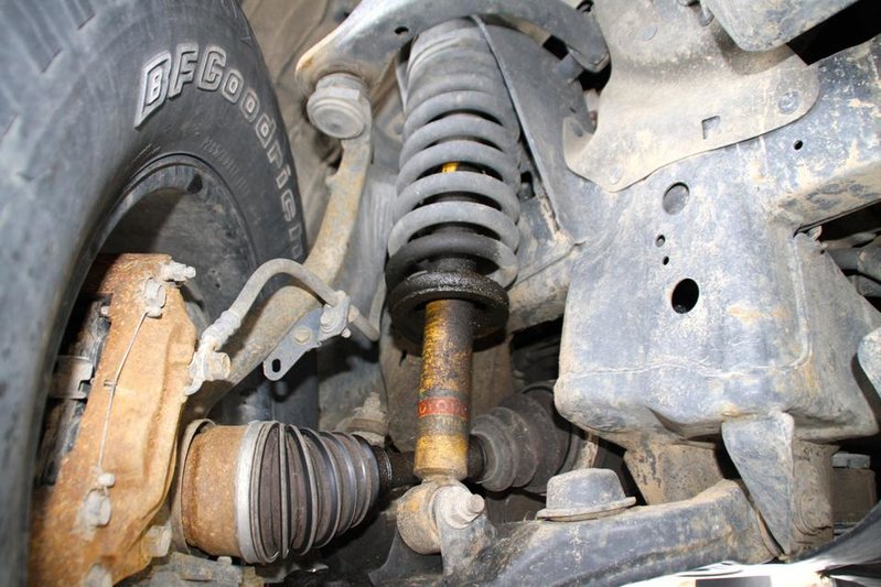

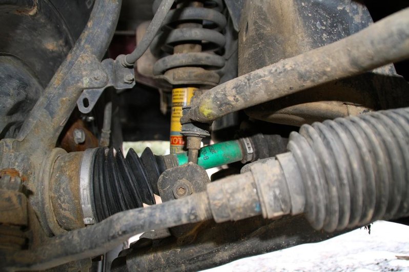

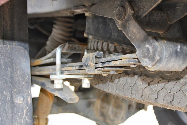

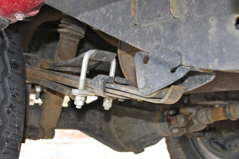

    So I've read damn near this entire thread now…i guess one good thing of being laid out with a bad back…and i cant wait to do this to my truck. Im new TW and very new to MODs and rear suspension, and have some questions.
    My truck is a 2000 TRD XtraCab SR5. It has P285/70R17 tires. 2.5" block in the rear and in-coil spacer in the front. I have helper springs on the rear so i can put more than a shovel in the bed without ridding bumpers. stock coils/struts front and rear but getting billies all round. Full time leer canopy.
    I am a farmer, and use my truck quite a lot (loads, pulling…). No wheeling, but lots off road. My leafs are sad as shit, and I am planning on rebuilding them OMD style, adding 2 chevs and dumping the over load.
    Since my truck already has 2.5" lift (with shitty blocks) will i still need to get things like extended brake line and BPV bracket? My brake line now is 17" and BPV bracket is 4 5/8" What about axle shims? I don't have any vibes now.
    Ill throw some pics up so you can see what im dealing with.

    Yes you should have no issues re using..:)
    Your suspension looks a little sacked, especially in front.We'll address that, if your doing the front with Bilstein 5100's I'd advise throwing a little more at it & get either the Toytec/Eibach coils or get some OME 883's for a 2nd gen. (thats what I run, match up perfectly, gives me 3" in front & nice firm ride, something you want to think about seeing how you load your truck..) 2 nicely ARC'd Chevy springs for the rear , get rid of blocks & those helper springs , they're doing more harm than good really..;)
