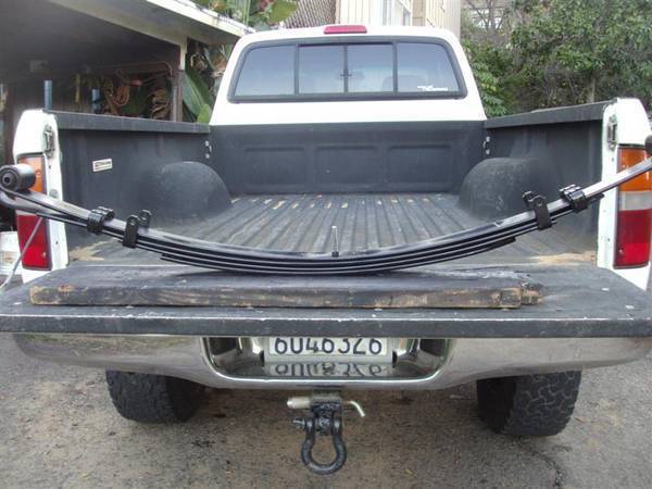

    This is 2 Chevy springs on stock 2nd gen. 2-leaf/non TSB/no overload...
    Chevy donor springs after surfacing/wire wheeled/painted...

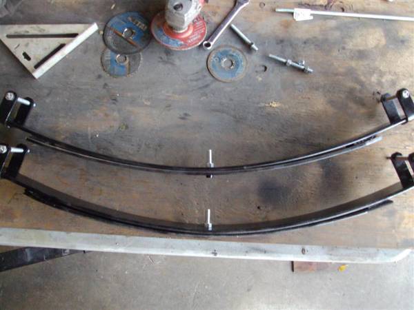

    Haha..:) Thanks Judy, yeah I do a little more than just slap on some diff. steel, after I decide on a donor leaf pack I break them down,inspect, break out the angle grinder with cut off wheels & grind disc & go to town on them....;)

    I got a quick question about removing the 2nd leaf on the 2nd gen packs. I am reading that the extra length on the front that wraps partially around bushing is to reduce axel wrap. Is this true and is it going to be bad to remove that to put a chevy leaf in?

    When you replace that leaf with the stronger Chevy steel axle wrap is a distant memory.

    Keep the second leaf, the one with the bushing wrap. Start adding under it, and keep your donor pretty long, around 33-34"s. Being out of a 3/4 ton, the longer length will give you a much better ride. Center off of the existing hole when you cut.

    And get ready for some pretty good lift! When putting your packs back in, do the end closest to the cab first and go ahead and put the pin through and nut it on the back, and then wrestle the rear into place. I used an Irwin Extra Power quick clamp to help pull it back into the shackle.

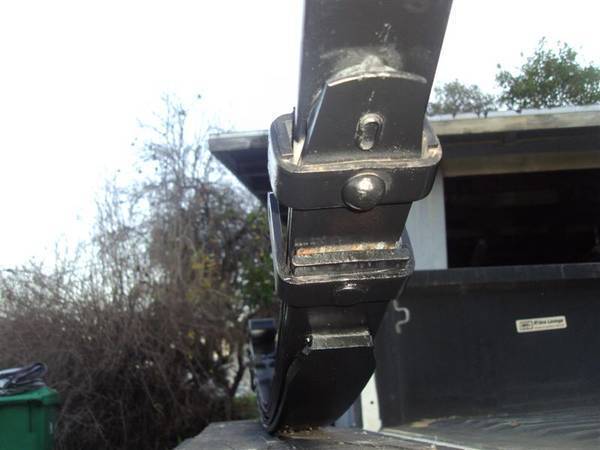

    Last question about the secondary leaf, is there any way to get those "guards" off the leaf and them be reusable? Or is there a way to get that leaf off the main without cutting them? Looks like I'll be doing this Saturday. It's my DD so I wanna get it done right as quickly as I can.
