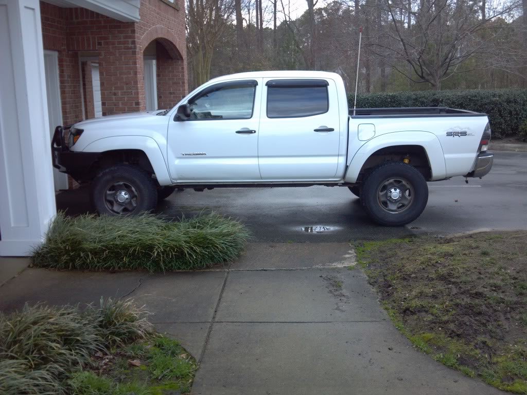

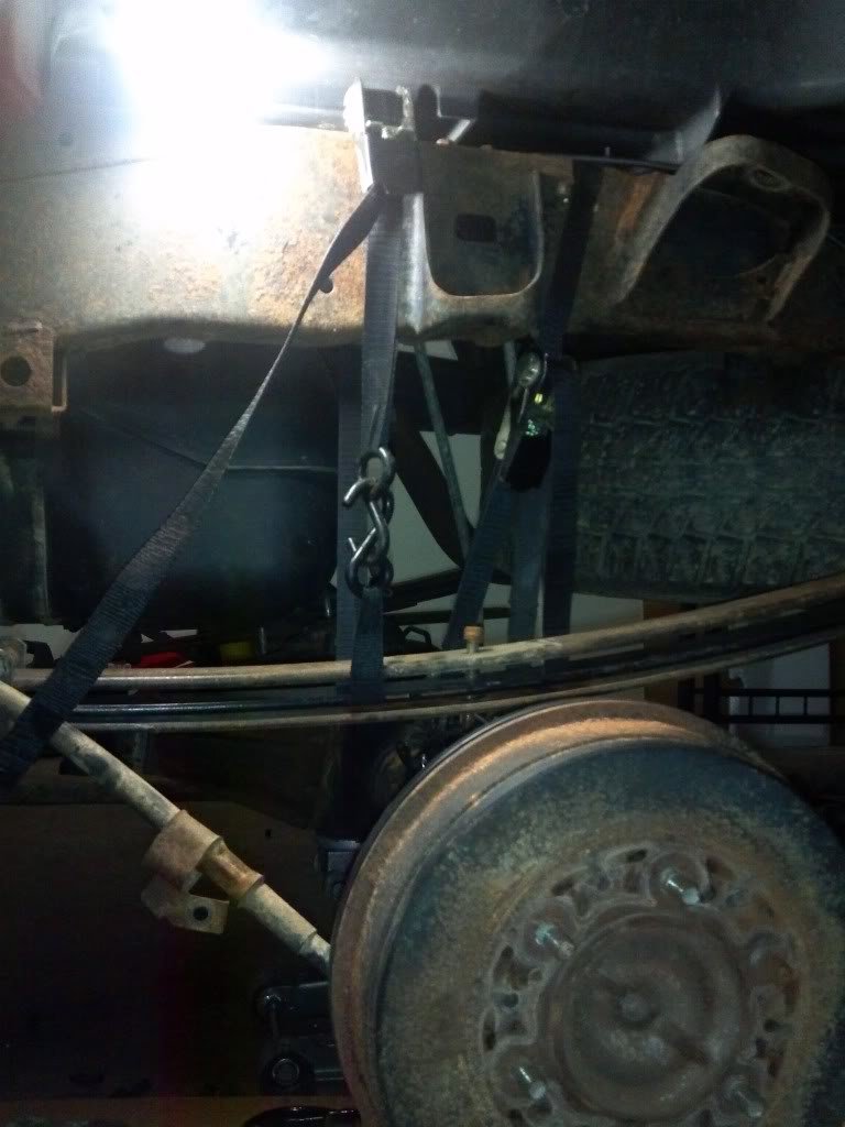

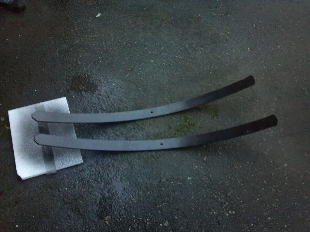

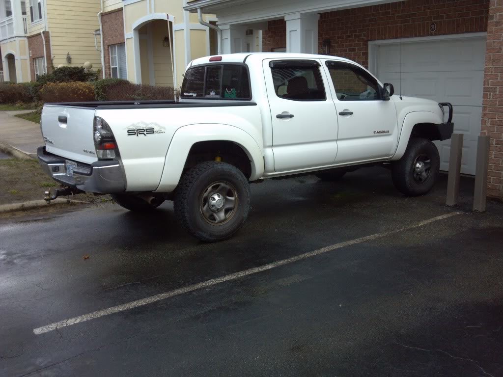

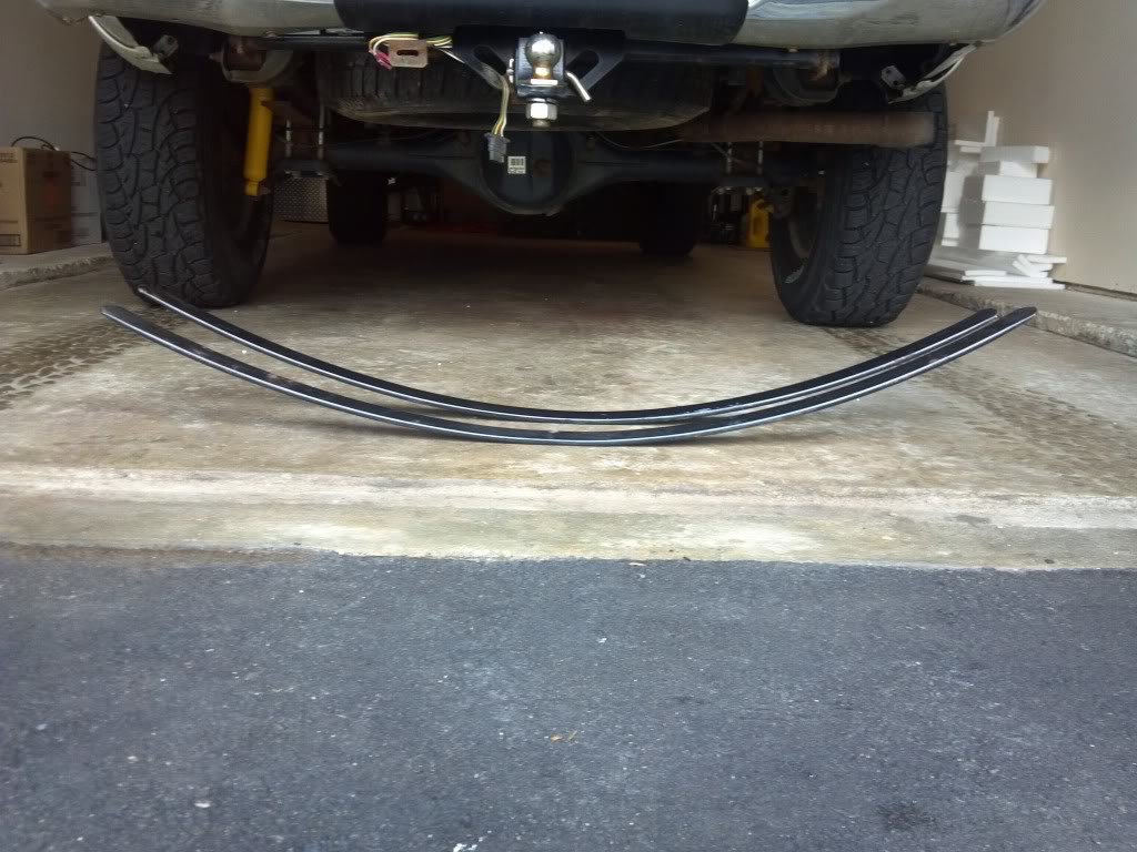

    Replaced the secondary Toyota leaf with a 50" 1976 Chevy 3/4 ton leaf cut to size. From front to Center 23 3/4, from center to rear 22 1/2.
    Rear Driver:................Rear Passenger:
    Stock - 21 3/4".........21 3/8"
    Before(Factory1 + Factory2 + 1.5" 3 leaf AAL) - 23 1/8".........Before - 23 3/8"
    After(Factory1 + Chevy + 1.5" 3 leaf AAL) - 23 3/8"...........After - 23 3/4"
    New Leafs

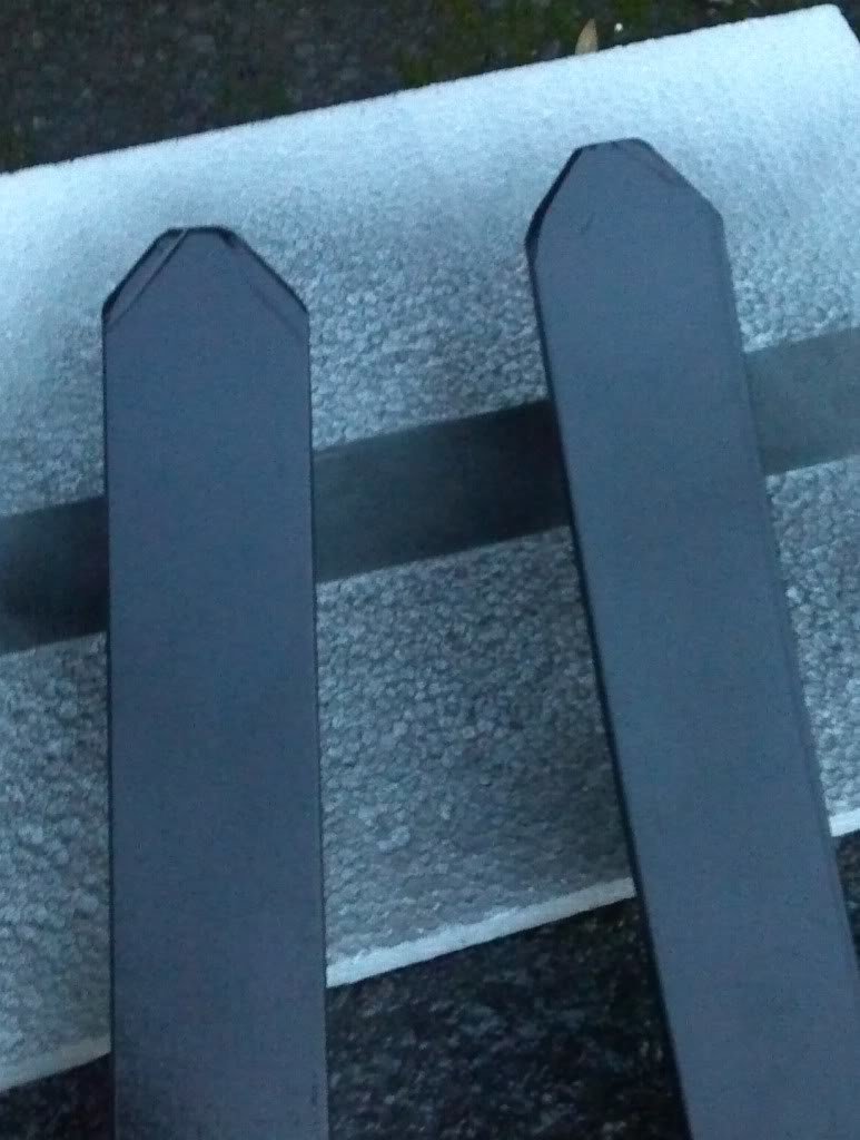

    Comparing new and old. Cut off one side of the "guards" and had to twist the leaf to get it off the main.
    My buddy doing the diamond cut
    Cut, painted and drying
    Diamond cut, used Engine Enamel and a heat gun to dry

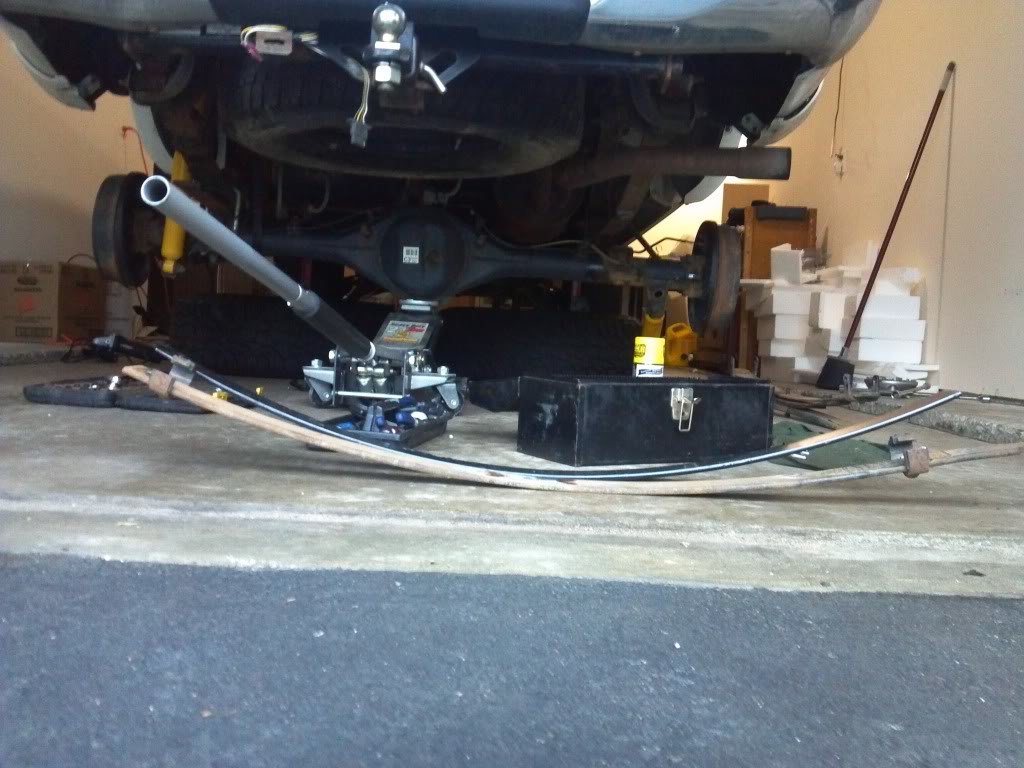

    Stacking the leafs, the driver side is harder. Got the one ratchet strap set to the max length of the Brake lines.
