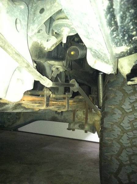

    good job !! & I like your diamond cuts too... but i'm a little confused, did you leave out the AAL ? (I only count 3 leafs total in pic) But your numbers are almost exactly what I have, & what I have is 3" lift over all, is this about what you figured ??
    Looks like you are almost level, maybe a slight rake in rear am I seeing this correctly ?

    I don't have all the leaves in that pic, I was just showing the straps I used. I've got:
    1. Toyo main
    2. Chevy custom
    3. Three
    4. Leaf
    5. AAL
    6. Overload

    Ok, if you find you don't like the ride, I'd dump the overload & the AAL (I'm very suspect of any 3 leaf AAL, especially if sold as a progressive)
    Just seems like a lot of shit on your axle for 3" gain, I just R&R'd my springs back to a linear leaf pack w/4 leafs total & have 3" lift... Keep me posted...

    I'm going to Shoe Creek in 2 weeks. I'll see how it does there, but just driving around town it feels fine.

    Cool, yeah hit a few trails that'll speak volumes...;)
