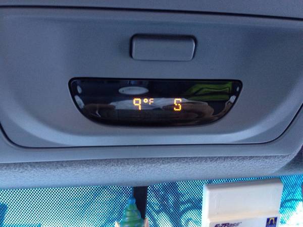

    I agree, this truck will never be a 3/4 ton. But as you know, it was never designed to be....
    Like you said any improvement would be better. I mean the remaining 10 leafs I didn't use from the pictures below and a single 60 lbs. bag of sand was enough to cause my rear end to ride the overloads and hit the bump stops. I guess an AAL would have done the job but where is the fun/challenge in that. Anyone can buy one and pay someone to put it in.
    I didn't get a chance to install this weekend. The weather didn't want to cooperate. Snow and to cold to work on the truck uncovered.
    However I did pull apart the leafs and cut them down. Then I cut some "ghetto" pads from a 10" tire. :D
    I didn't do to much because it was chilly.
