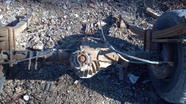

    I have been wanting to pull the trigger on this mod for months. I found these leafs on Craigslist. They are from a 98 Silverado. I know it has been suggested to use the leafs of earlier models. Is there any reason why I should not use these? Im looking to get 3" out of it and get rid of my 2" blocks.

    Ok this is what you'll need in no particular order: Ext. brake line, ext. shocks, Ubolts (especially in rust belt) new axle centerpins, maybe a BPV relocation bracket (if applicable) & have 2 -3/4" spacers for carrier bearing drop if vibration occurs after lift..

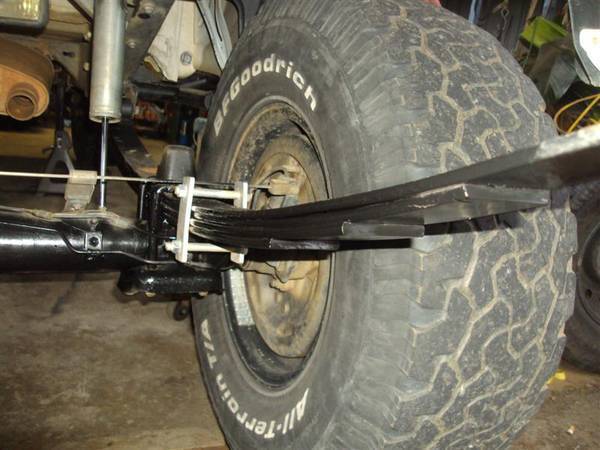

    3" lift leafpack (Linear).....

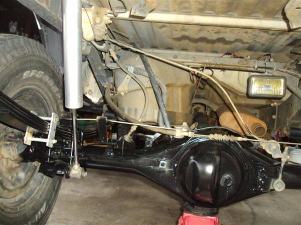

    Your shaft on that shock looks so skinny... No wonder you keep breaking them. :rofl:

    I know right...
    Damned 2nd gen billies !!!....:anonymous:

    Theres absolutely no reason NOT to use them if their the same width (or real close anyway)
    Those springs look like good donors to me...:thumbsup:

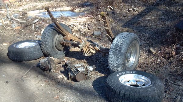

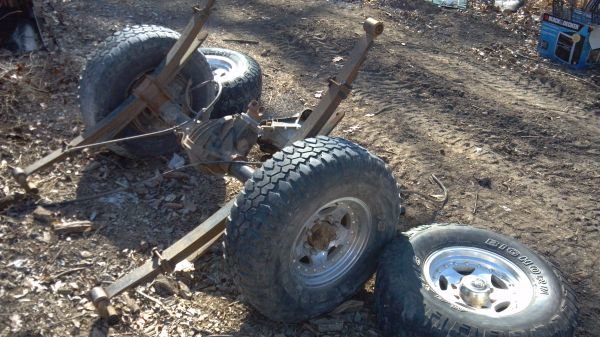

    Time for the "other guys" to take a back seat, damn this was a good score...
    These springs are flawless
