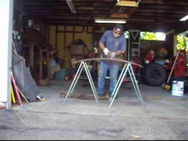

    De-scaling leafs...
    Scaled leafs ready for wire wheel, then measure/cut/dogear/paint...

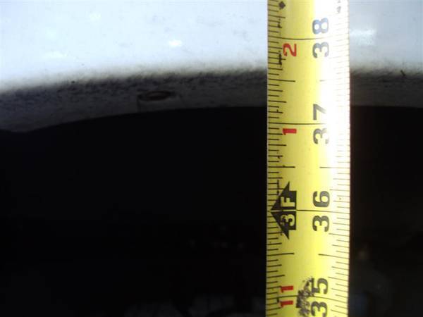

    someone grew about 3" today...
    Actually it was about half an inch higher than in this pic after re measuring...
