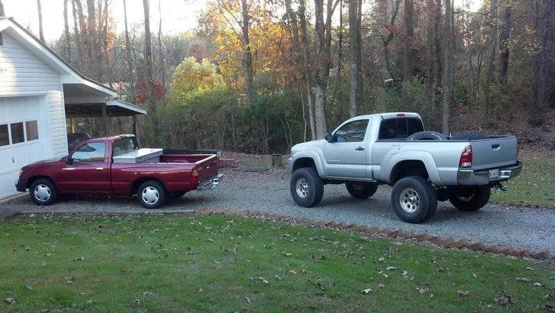

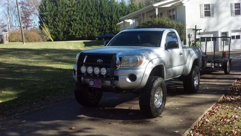

    Hey man thanks for the info. And you can add me to the list. I took off my crapped out aal and got a set of non tow package S10 leaf springs. I even cut the eyes off the main leqf and used it. It rides like a truck and doesn't squat down when I haul wood now.. I didn't measure the before and after but my dad has a truck like mine but alot newer and my springs are about 2 1/4 higer then his stock. I dont have a pic of my springs but ill take some tomarow. Heres a few pics of my truck

    Holy crap man... What the hell do you have going on in front? That looks closer to a 4-5" lift than anything.

    Yea I have 4 inch lift spindles and 5100's at 2.5 inches
