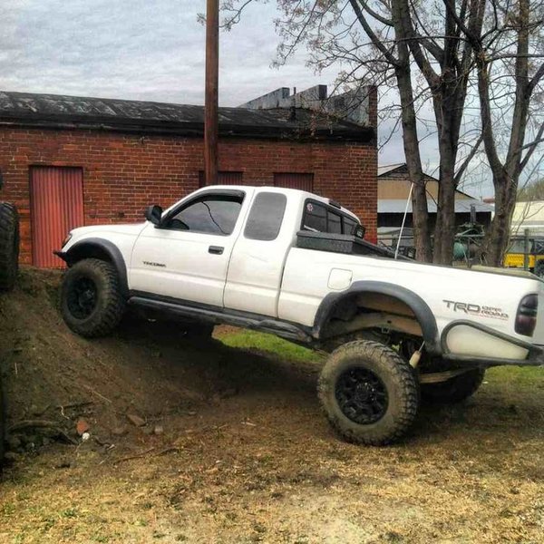

    Flexed the 7 packs on a hill at work. Still got a lot more in them if it weren't for my shocks limiting them. These seem to flex a helluva lot better than the old 5 packs I made a while back while also having a lot of load carrying ability and around 5 1/2" lift.
