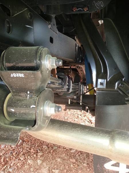

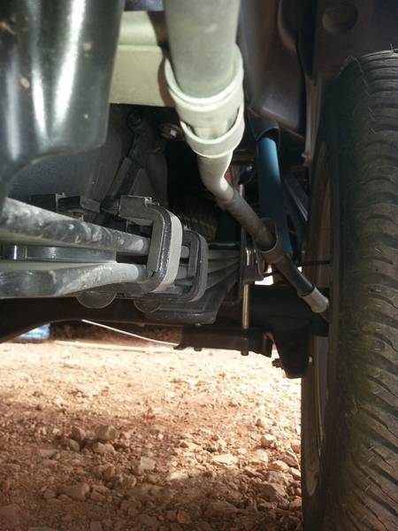

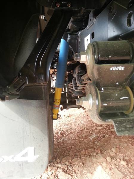

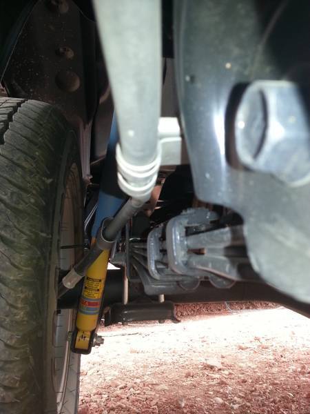

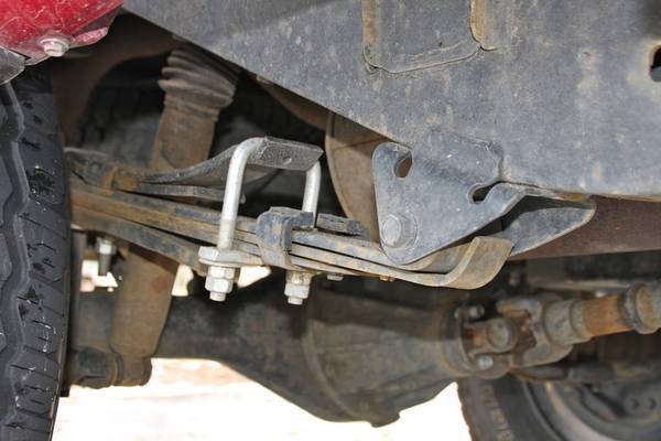

    Howdy ya'll. Finally pulled trigger on this, and couldn't be happier. Had it put together for about a month now, and its far exceeded my expectations. I was coming from factory springs which were shot, blocked with a 3" lift block, and then helper springs to try and save them before i found this mod.
    I found a bad ass set of leafs off an older 1-ton chev that were 2 1/2" wide. Broke em apart, cut em down, slapped em in. I put nitro chargers all around, 881's up front, and my truck is the real deal now. Only concern i have is the space between leafs. As suggested by doug, i used wheelbarrow tire chunks as pads, and they are really thick and keep the springs apart except for where the pads touch leaving a gap running all the way between each leaf from the axle U bolt to the pad on end of leafs. Is this an issue? Do springs need to be together, supporting each other the whole way out? Loaded it with 600lb+ of cement and with my 250lb canopy i still had arch...though it was getting down there. I may throw in one more chev. what the hell right.
    Cheers for all the great info!
    Heres before springs
    and after with OMD springs

    Can you take a side pic? Is it stock top 2 and chevy bottom 3 you did wright? and how much lift did you end up with?

    Going to try to get to a yard this weekend.
    How do you figure how much lift will be attained by the spring you get?

    My first Post, so please go easy. After reading through this entire thread, I must say thank you to Doug. You sir are certainly a 'trend setter'. And everyone else for feedback on how great this mod is. I will one way or another do this mod soon; depending on the results of this post, will determine how soon.
    So on to it. Would my leafs be considered normal for stock or are they bad already? It's pretty bouncy for me at 80 mph on the highway. Thanks in advance.

    Mike welcome to TW.
    Yes your leafs are normal stock leafs.
    in fact those have the TSB 3rd leaf it appears.

    Yep, he has the TSB leaf pack. They weren't designed for a truck...
    Now if you want to do this mod, make sure you don't get lift leafs unless you want the lift. If you lift it, make sure you get new shocks.
