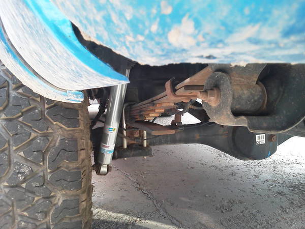

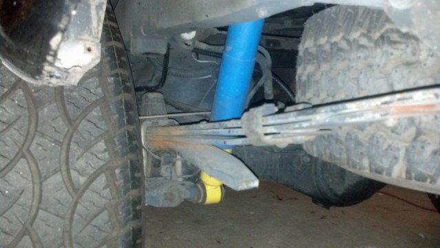

    Think I can bring these back to life? Planning on moving this weekend and then getting to the JY the following to get some new packs.

    Hi Clifford, yeah yours have same old warp, but rebuildable....

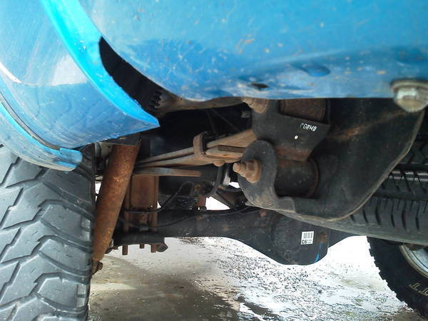

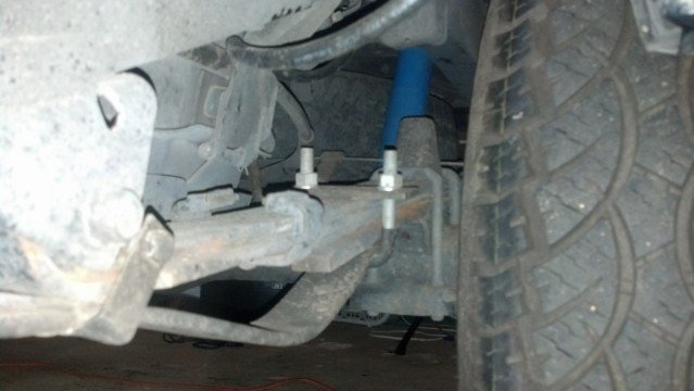

    As requested, side on pics of the front ends of the springs...
    Sorry for the crappy pics. It was almost dark so I was kinda guessing on the shots.
    That left spring looks like a tilde (~). :eek:

    Nice..... personally i like a firm ride, always have, my stock susp was to the point that my hyundai or my saturn took bumps better, thats what prompted me to start this thread...:)
    Oh no worries Lee.....
    I dont have to say this much luckily but your mainsprings are door stops, done, its a very gentle neg ARC , unusual.. usually they bend with a "hump" so its easy to spot, your not so much... I'm sorry man..:(
