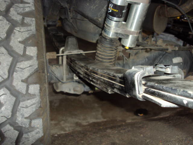

    I was reading all of this and wondered what/how to get 1-1.5" of lift? My TSB springs are not flat (yet) and I want to do this. Do you think adding one leaf to each side from a 63" GM pack would do the trick?

    Oh probably so, shoot me a couple good pics of your springs & I'll tell you what you need....;)

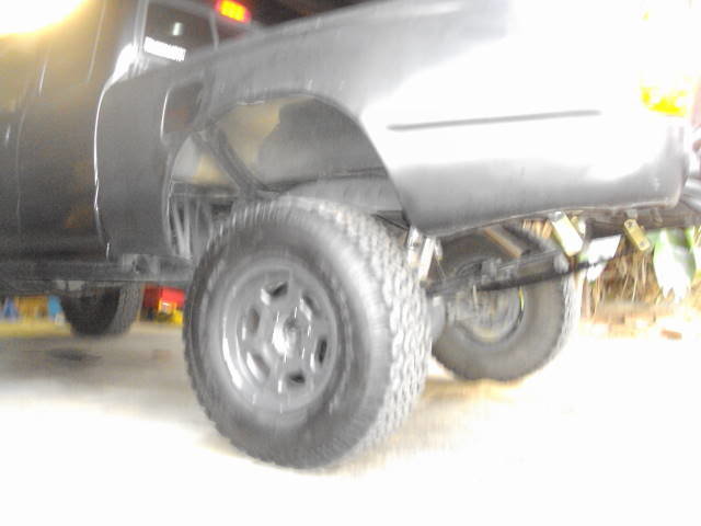

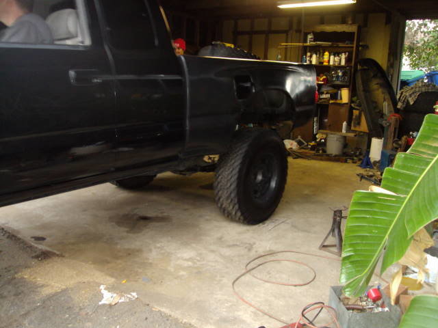

    Ok, so today I did Taco_me_elmo's (Micah) 1st gen, he had the usual neg. arc that Toyota has become famous for, so of course we had to turn a frown upside down & put a little spring in its step.......
    Sad little strips of metal ...:(:(

    But with a little help things started to change.....

    Don't piss yourself Connor , but you're gonna love this MOD dude..!!;)

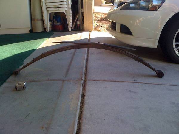

    i finally got a chance to go to the JY to find a leaf pack that would be suitable, i wanted good arc and nothing too thick that way my ride wont be too stiff. found this off of a ford. im planning on adding 2 leaves per side. i figured id try this mod first before buying a new leaf pack

    Wow, thats a nice looking set of leafs ya got Don !!!! Are they off of a Ranger ?? Or?? width ??
    give me some info.. very nice leafs... :thumbsup::thumbsup:
    I think yours is a center-to-eyelett config. (equal distance from eyeletts to center axle pin)

    i think they were off of an F100 but not sure cuz i was just going around the JY looking for good arc and thin leafs. theyre 2.5" wide and 1/4" thick per leaf. il be adding 2 leafs per pack, hopefully it wont be too stiff. i got them cut and cleaned today, hopefully they'll be installed by the end of the week.

    if these leaf pack turn out the way i like them, then il make a shackle flip and i may even reconfigure my shocks like this /\

    You def. nailed it on the arc & good idea on the shackle flip (I don't know WTF Toyota was thinking with the screwball config. on 2nd gens)
    Props to you man for pulling the trigger on this, with a few tools, couple floor jacks, a little mech. ability & very little out-of-pocket $$$ I promise you'll get high $$$$$$ name brand ride for a fraction of the cost....:thumbsup::thumbsup::thumbsup:
