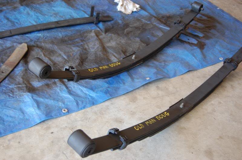

    716bloodhound.... bundled today, shipped tomorrow....

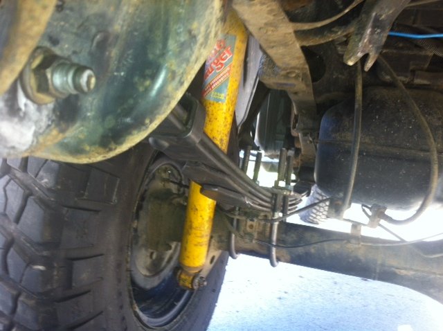

    Crappy pic but you get the idea.....

    I'm a convert! Ride is awesome, but - it was a mofo to get everything lined up just right again. Those new bushings on the driver end of things tend to be a pain in the ass to get into the spring hangers.
    Haven't had a chance to test flex yet, going to get my extended brake lines on tomorrow/weld bump stops/trim u-bolts...

    good job Jake !!...nice , even ARC.... good stance....:thumbsup::thumbsup:
    If you do this again, next time slightly spread your front hangers, it'll help tons....:)
