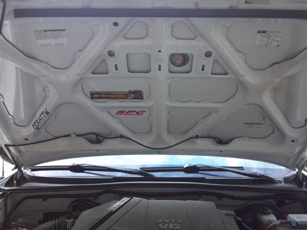

    I got plenty of room for stickers

    What was this about stickers?
