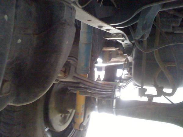

    This is some of Micah's feedback from this weekend.. let it rip buddy, givem the good/Bad/& the Ugly (if any)......;)

    csjumper2003's (Chris) 2nd gen spring rebuild...
    edit: these have the TSB springs already

    Matt does this on a regular basis, he's been running my rebuilts for about a year now with no fails......;)

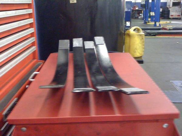

    960
    don
    las vegas
    07 dc 4x4 v6
    got them cut, painted and i put some rubber to prevent it from make noise. i cant wait to install these bad boys

    Very nice Don, looks like a decent shop you're at, are you a mech. by trade??
    haha , yeah I did a rush job on Micah's 1st gen springs in regards to the squeak pads, i slapped some adhesive on the ends , had some OEM pads that were , well, there stock 'yota crap, little pieces of thin plastic, think they lasted about a day out at Superstition...:laugh:
    So tomorrow I'll use some BF Goodrich sidewall off my donor wheel barrow.:D
    thats what I've been using since day one, no squeaks & haven't lost any yet...
  12. Jan 18, 2012 at 11:12 PM

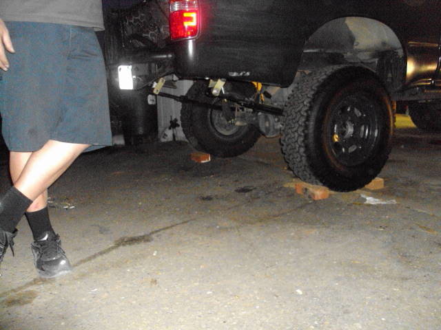

    yea im a tech, ive been working on this thing on my down time at the shop. im using truck tire inner tube, ive used it to quiet down my AAL and stock leaf pack and it worked well so far. how thick is the sidewall rubber you use?

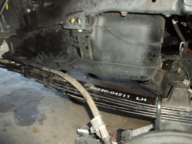

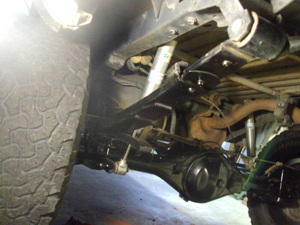

    finally got a chance to install the leafs, i left the overload leaf off and it gave me another 1 3/4" - 2" on top of my AAL.
    before: [​IMG]
    after: [​IMG]
    also installed u-bolt flip and tack welded the stock bump stops on the top plate. now i need to make a shackle flip kit and measure for longer shocks. thanks Doug for coming up with this cheap and amazing mod! :thumbsup:

    No problem Don & thanks for 2 things
    thanks for the MOD compliment
    & thanks for having the belief in what I've been preaching since last year
    & having the balls to pull the trigger on this upgrade !!..:thumbsup::thumbsup::thumbsup:
    & isn't the ride amazing now ??...:D
