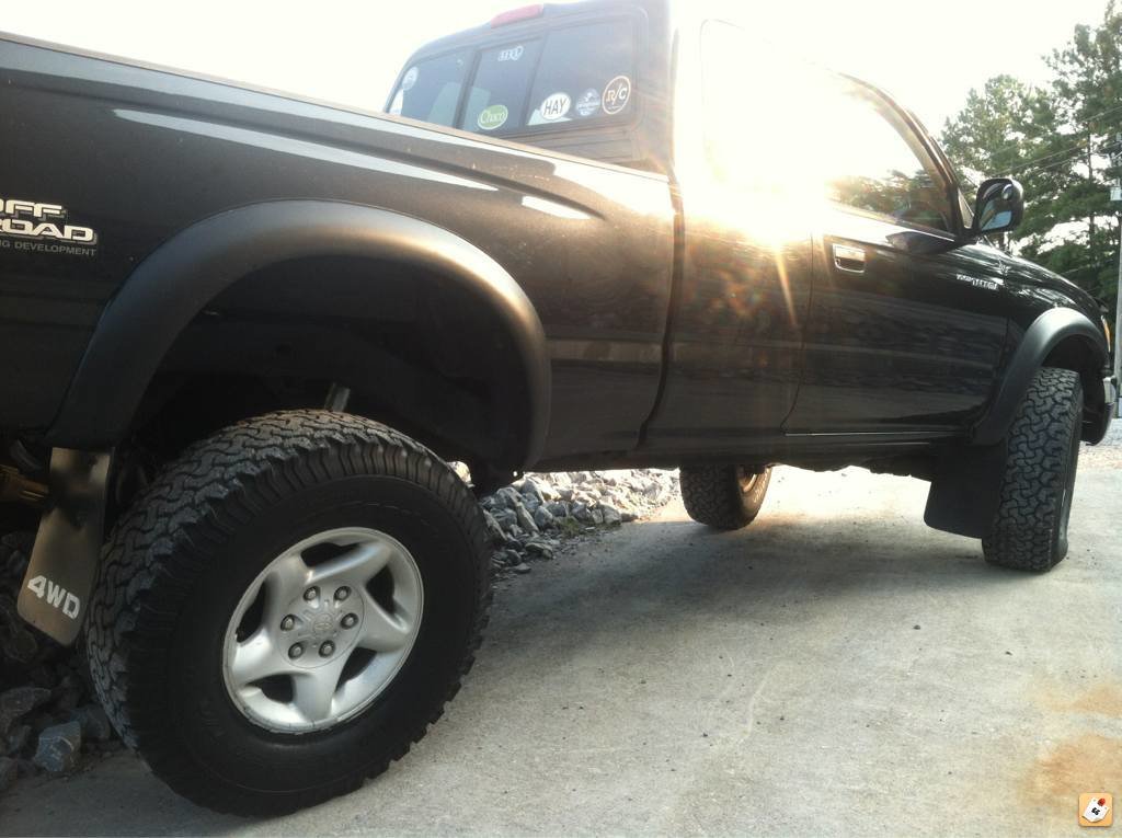

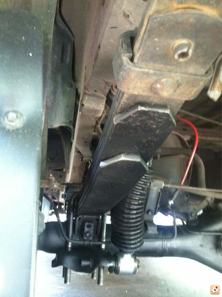

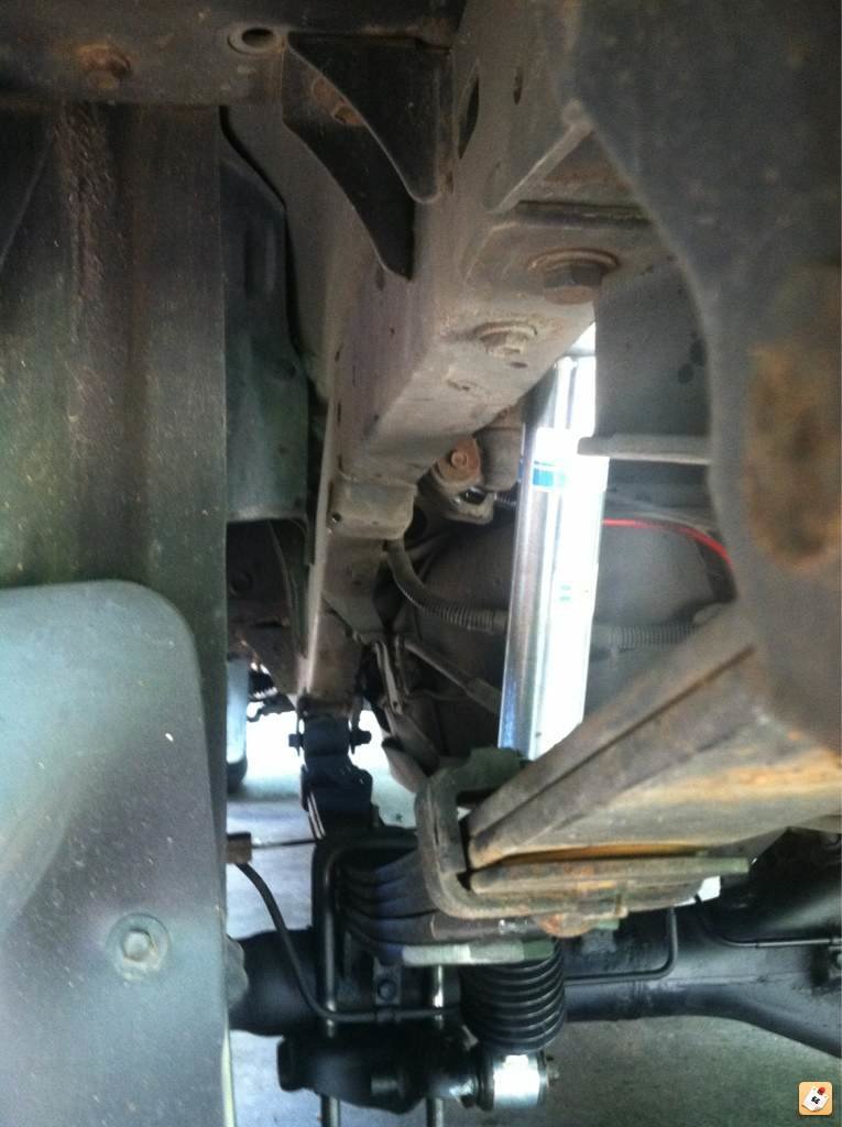

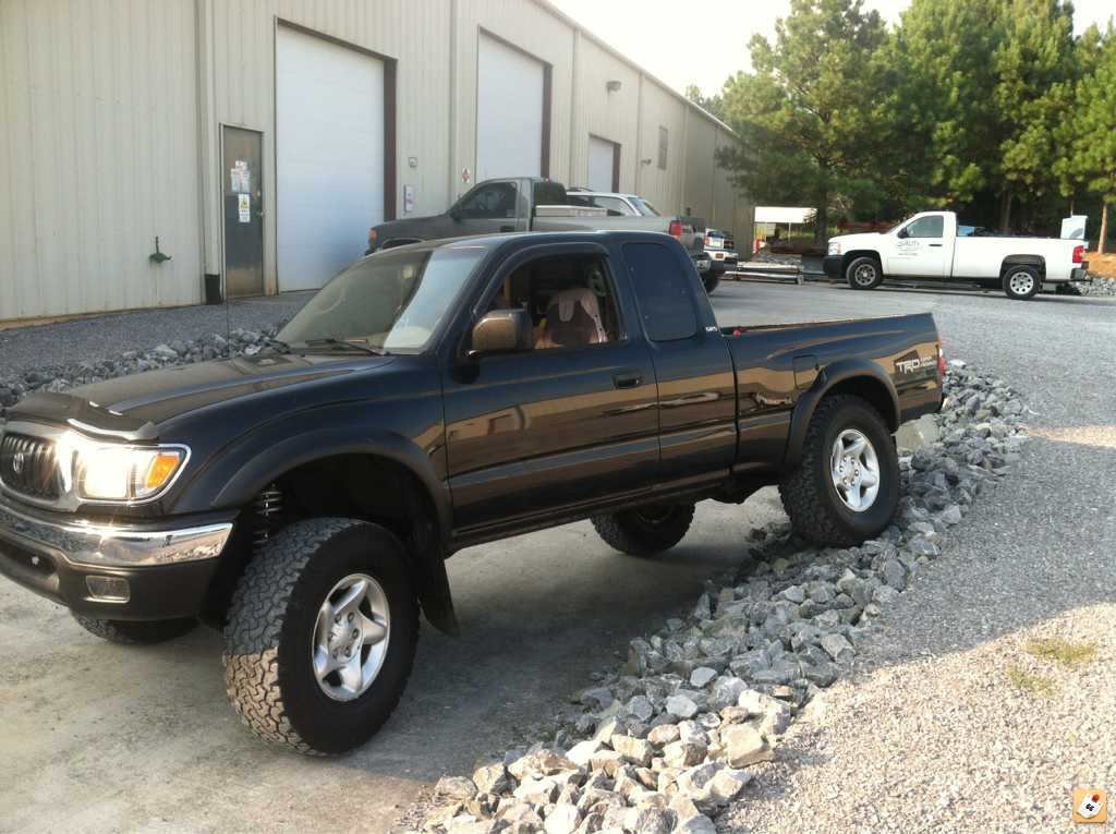

    So I have been workin on the lift this wknd I added the two chevy leafs to mine and got what seems to be a huge amount of lift. Seems really stiff too I might take the lower spring back out and see what happens2yzuraru_dcc8032791b8d85ae6a765e6c5ef9404ce378446.jpgysa5a9er_05c3daff5867e74a3b5649be467f8dc5b7a90b54.jpgzutyqade_64b4d9e54515286e896528d1338d02edf649ccaf.jpguse2ene7_82c8ceab056bda5bc11d5a759fbbbc3927a13d84.jpgeruda2y2_73dfa166c5f5b07f7fd833b3a0382e8a62cb4c5a.jpgyhetuqaz_cec0f38255f560c51b12cf3faeb6a01bb3917d4f.jpg

    Wow Andy, you def . got some ARC out of those but actually looks pretty Damned good, a suggestion tho'.. looks like you need to cut about another inch off each end of the upper donor & I'd take 1.5" off each end of the bottom donor, this should drop you down a little & calm the springs down some too...
    Your dog ears look good !!

    Those are long U bolts too, did you have a block in rear ?? Anyway consider trimming them up an inch or so....:)

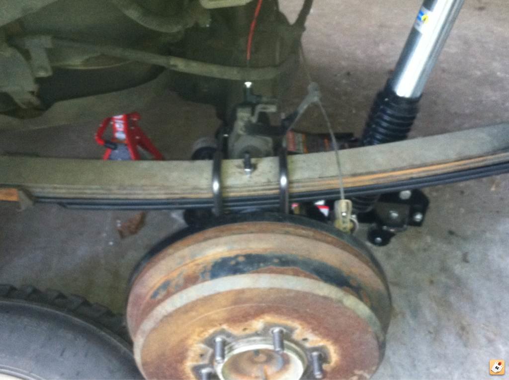

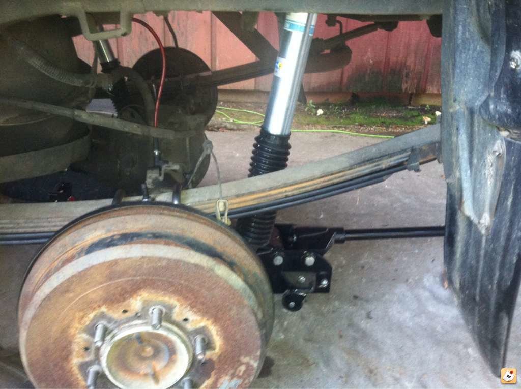

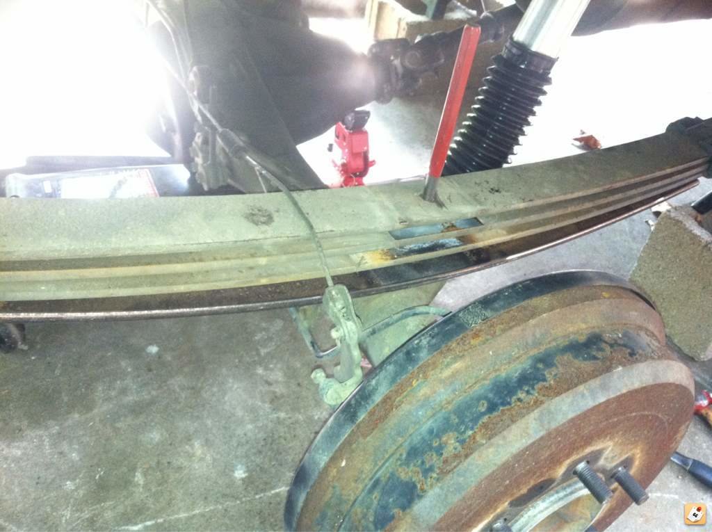

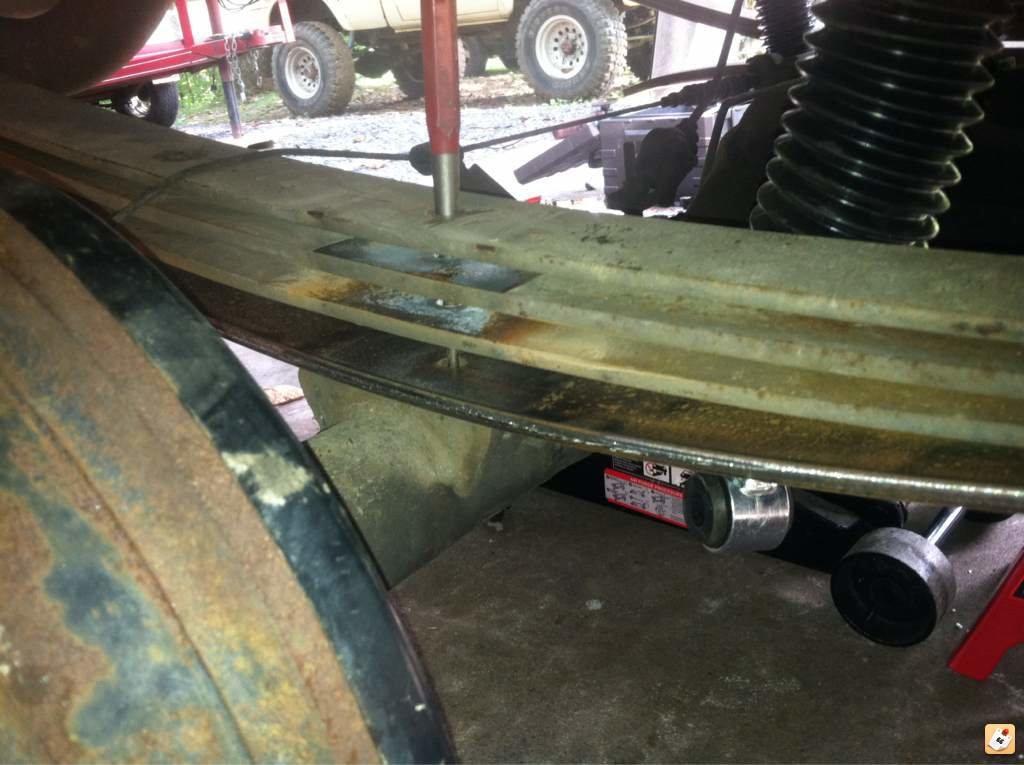

    a4a7y6en_9bd08a8ebffe2ecfb8551c92c9c86d9b2eb764c4.jpg3yzu7ymy_3535f2ee30d894f24947b1f6ef56e8e745b2920e.jpgedany8un_fb74d26efbb82502907325a2e2ba4a59d8ce1d96.jpg
    Took these today at work nothin special but I really wanted to see how the springs would flex. Everything seems to be ok just gotta he some bumpstops and figure out how to fix this vibration!!!!! I have tried CB drop shims to no avail guess axle shims are next . Thanks for the awesome rear end Doug!!

    No worries, looks great !! Heres an idea that'll probably work.. just flip the carrier bearing over & bolt up if you've done the drop with no results & do this before the shims,,, U bolts good & tight ??
