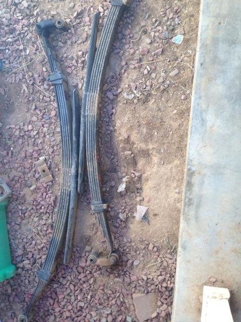

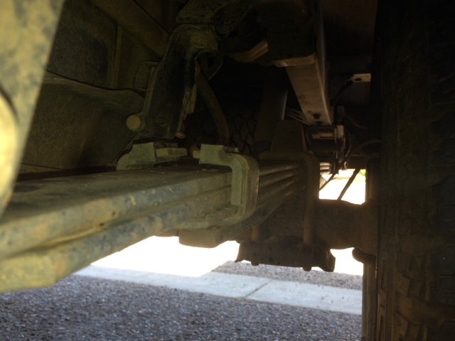

    Anyone looking to do this in the Phx area I have 2 pair of leafs sitting in my garage that I will donate to a great cause. Leafs came of a mid 70's Chevy.
    And if your reading this and dont know if you should do it or not just do it! 100x's better than my stock pack with aal.
