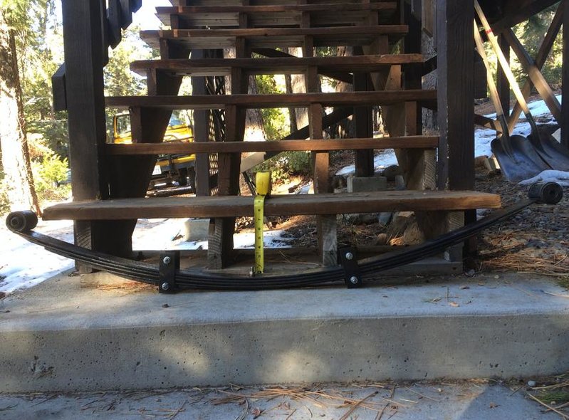

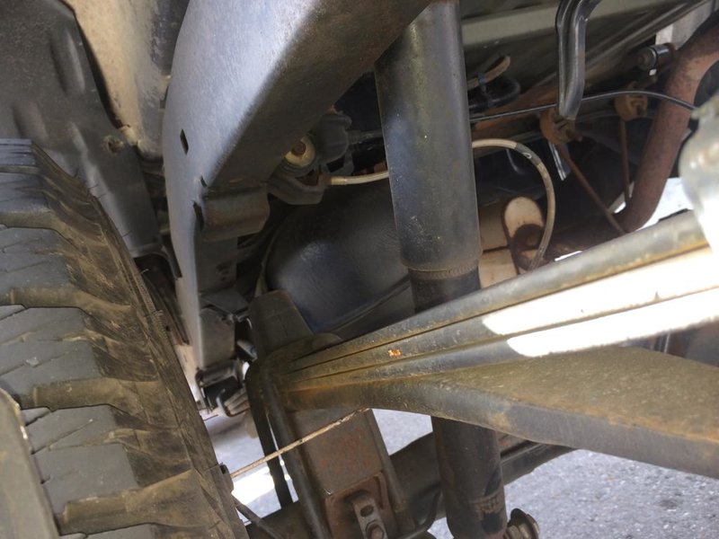

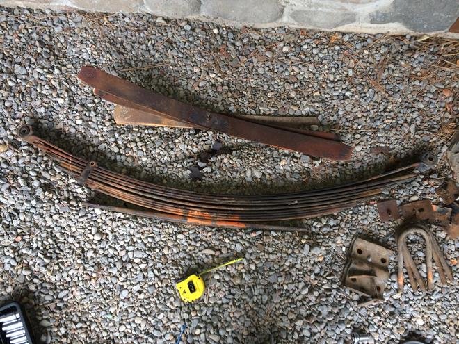

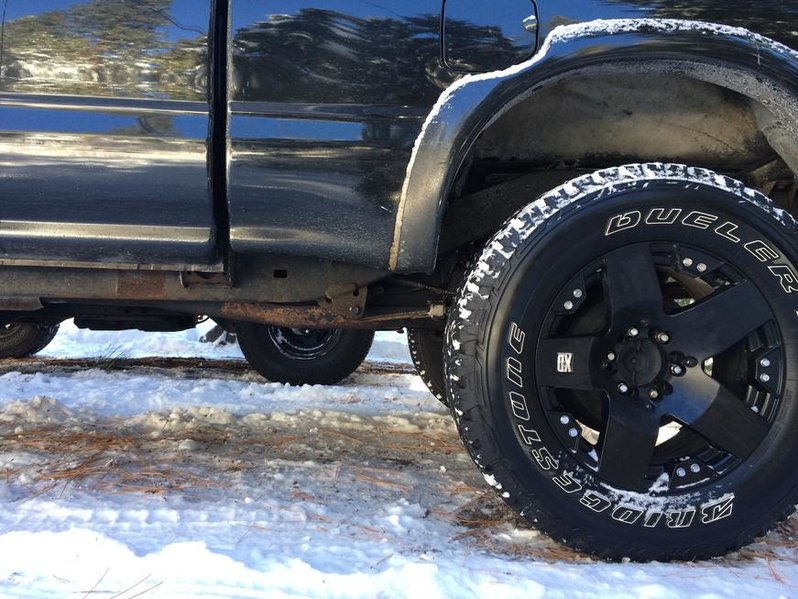

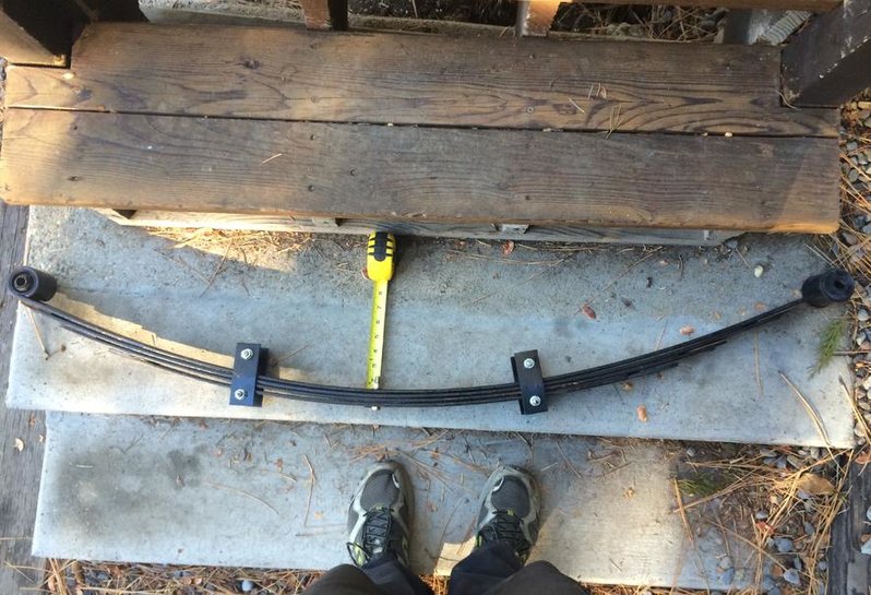

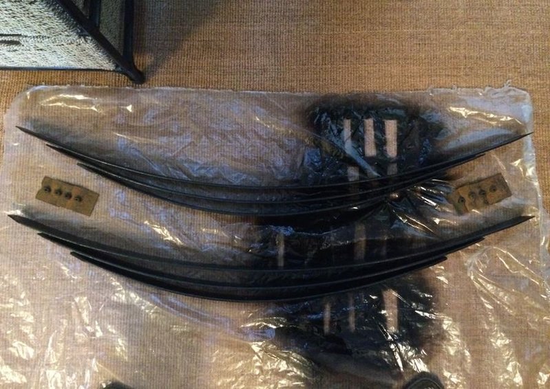

    Well, I finished the OMD refurb, and overall I am happy. The first two pics are before, the third is the leafpack (and a half) from a '91 Suburban (7 leafs + overload per side!) the fourth is after I set myself on fire with grinder sparks :D and the fifth is a pic of the three leafs that I'd use under the main leaf. The last two pics are a finished pack, ready to be installed.
    Beforehand, I had a 2.5" block lift that allowed for 285 tires. The refurb netted about the same overall lift, give or take and inch to account for lean that still exists. I didn't change the shocks (yet, because I wanted to measure the lift first) but the ride is much improved. Axle wrap was awful before, and is now GONE!
    In my case, I had so many leafs to choose from, that cutting them was unnecessary, in my mind. Beforehand, I had a "military wrap" secondary leaf that didn't seem to do much, because the main leaf was still sagging. With that in mind, I opted to use three GM leafs, and left metal on the second leaf right up underneath the (front) hanger.
    So, my only gripe is the "lean". From what I've read, this might be a Tacoma trait, due to the weight of the battery, driver and gas tank, etc. OME even seems to make their Dakar leafpacks with different heights to account for this lean. Anyone else still have the Tacoma lean after this mod? Mine is about 1" lower on the driver side. I forgot to measure beforehand, by the way.
    Maybe I should try swapping packs, side-to-side... Maybe the steel from 1991 GM leafs isn't as quality??... Maybe my shocks are shot..?? Maybe it doesn't matter??!!! Anyway...
    Again, the ride is much improved, so thanks Doug and everyone else for the knowledge and inspiration!

    I think your best bet would probably be a small shim under your drivers side leaf pack, or crank up your front end a bit. Standard Taco lean because of battery/fuel tank/driver on that side.

    The Taco lean is an interesting issue, eh? I have 1.5" in-coil spacer lift up front, and the front is level. It's just the driver's rear that is 1" lower. (The plan is to remove the spacers up front, too, since the front is a bit higher than the rear).
    I have some extra thicker and stiffer leafs that I could swap into the driver's side, but I'd imagine the solution, rather, would be more arched leafs on the driver's side in order to achieve 1" more lift, and keep equal flex. I might have one spare bottom leaf that could work; maybe that'll be another project after I fix a leaking differential seal tomorrow....

    An easy fix for the lean is spring matching, what i mean by this is if you have leafs you'll notice that some are slightly more ARC'd than others, take the slightly less ARC'd leafs & put them on the passenger side leaf pack, this will almost always result in a leveled out rear end if this is where your 'taco lean is.....;)
    Nice !!....:thumbsup::thumbsup: Be sure to post up some results....
