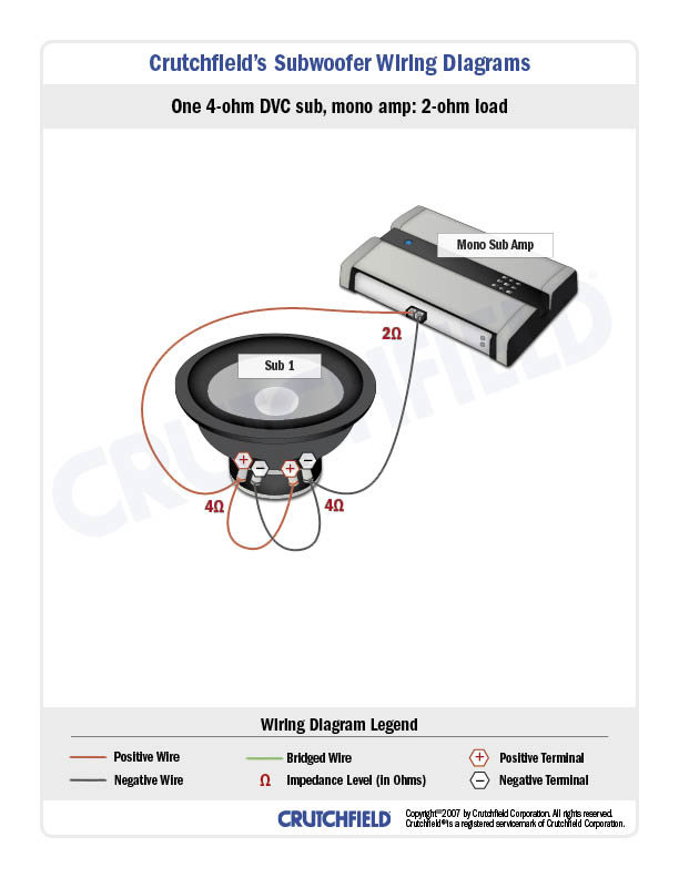

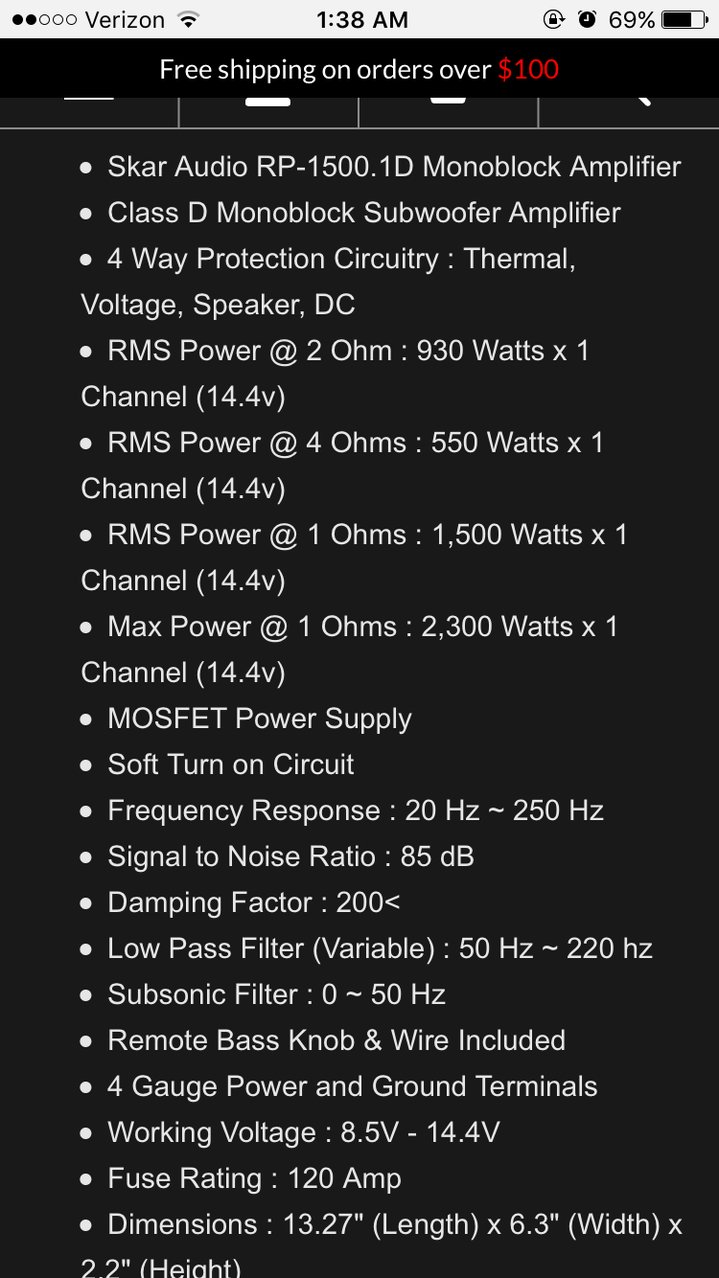

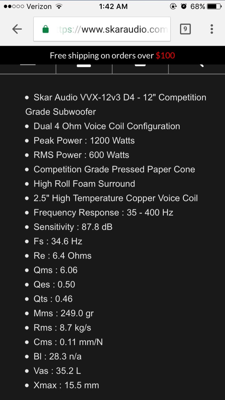

    Hey y'all! I just finished the box and the sub is securely mounted in its new home in my trucks back seats. Now a new problem arises. The amp has power, turns on just fine. Now the sub which is a Skar 12" vvx-v3 which is a 4 ohm sub with dual voice coils (will post stats below). It pushes 600 rms on 1200 watts here. The amp is also skar, does 1500 watts total. Now my friend told me to wire this 4 ohm sub to 2 ohm at the amp to make it run efficient. I will post the amp stats below because i am puzzled. I used 14 gauge speaker wire fron the amp to the sub if that makes a difference. But im pretty sure either i wired this sub incorrectly or the wires junk? I just want the damn thing to shake the truck and run efficiently.
    Amp stats:
    12" sub stats:
    Am i feeding it too much power it shuts off the amp or something? If its 550 rms at 4 ohms should i have wired it to straight 4??HELP!

    You can't wire this sub for a 4 ohm load...gonna be 2 or 8. 2 will give you the most output (supposedly), but will make the amp draw more current. Not sure which is more efficient - that figure isn't given (although could be figured given a few division exercises). I'd suspect a 4 (or 8) ohm load would be more efficient than 2 or 1. The amp literature is suggesting you're good to a 1 ohm load, so no concerns on the 2 ohm load (smaller is more difficult for amps) if the manufacturer is feeding you good info.
    Maybe you wired in series accidentally? That way the amp would see an 8 ohm load and would make maybe 300W. Did you put a meter on the cable to the amp?
    You didn't really say what the problem was though. Is the amp shutting down when you turn it up?
    Do consider though, 1500W and 1 ohm stable from a sub $200 amp is unlikely. Even the 930W @ 2 ohms figure is suspicious at such a low price.
    Probably should have written this first, but check all your power and ground connections. Your ground should be securely attached to an unpainted spot on the frame or body.

    Hey thanks for replying. Im re-scratching the ground at lunch time on break today to see if thats the issue. The amp is fine, gets full power, no turn off or anything. I rechecked the wires 3 times now and everythings where it should be at the right polarity. Now the true issue is that the sub does not move(so no power from the amp?) if i turn the bass all the way up on the remote and amp and put my head unit volume up high the sub begins to move A LITTLE but nothing near where it should be. This leads me to believe somethings not connected correctly...
    This is how i wired the sub up 100% accurate to this picture. Except my amp has 4 holes total for speaker input (two neg two pos) i feel like this si where my wiring is messed up at but im currently not able to trouble shoot so
