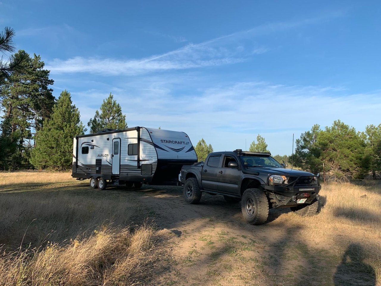

    It won't be that bad. I'm towing this travel trailer it's 23 ft long fully loaded with fresh water 6300lbs
