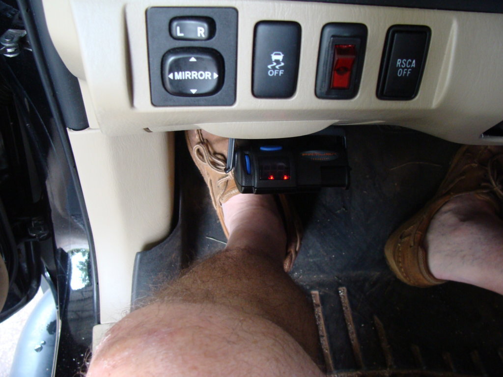

    Unless things changed since 3rd Gen trucks, if you have the tow package on your truck, it should have the brake controller pigtail already wired in. On my 2nd Gen 2011 it was hidden behind the kick panel next to the parking brake pedal. Dig it out, buy an aftermarket controller (I have a Tekonsha and love it) and figure out where to mount it so you can use the manual control easily if/when needed. Amazon has the correct connector adapter so it will plug right in to the Tacoma harness. I put mine between the small loose change compartment and the hood release, in front of where my left shin is when I'm seated.

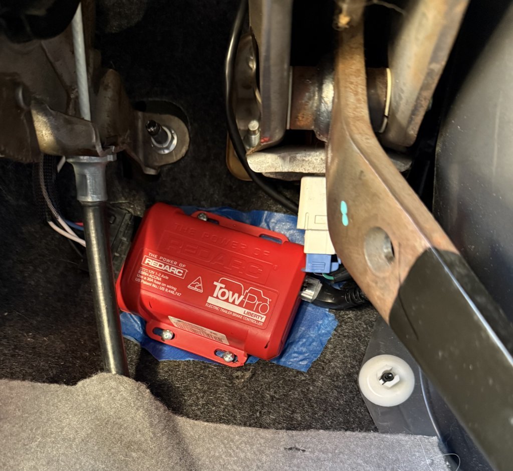

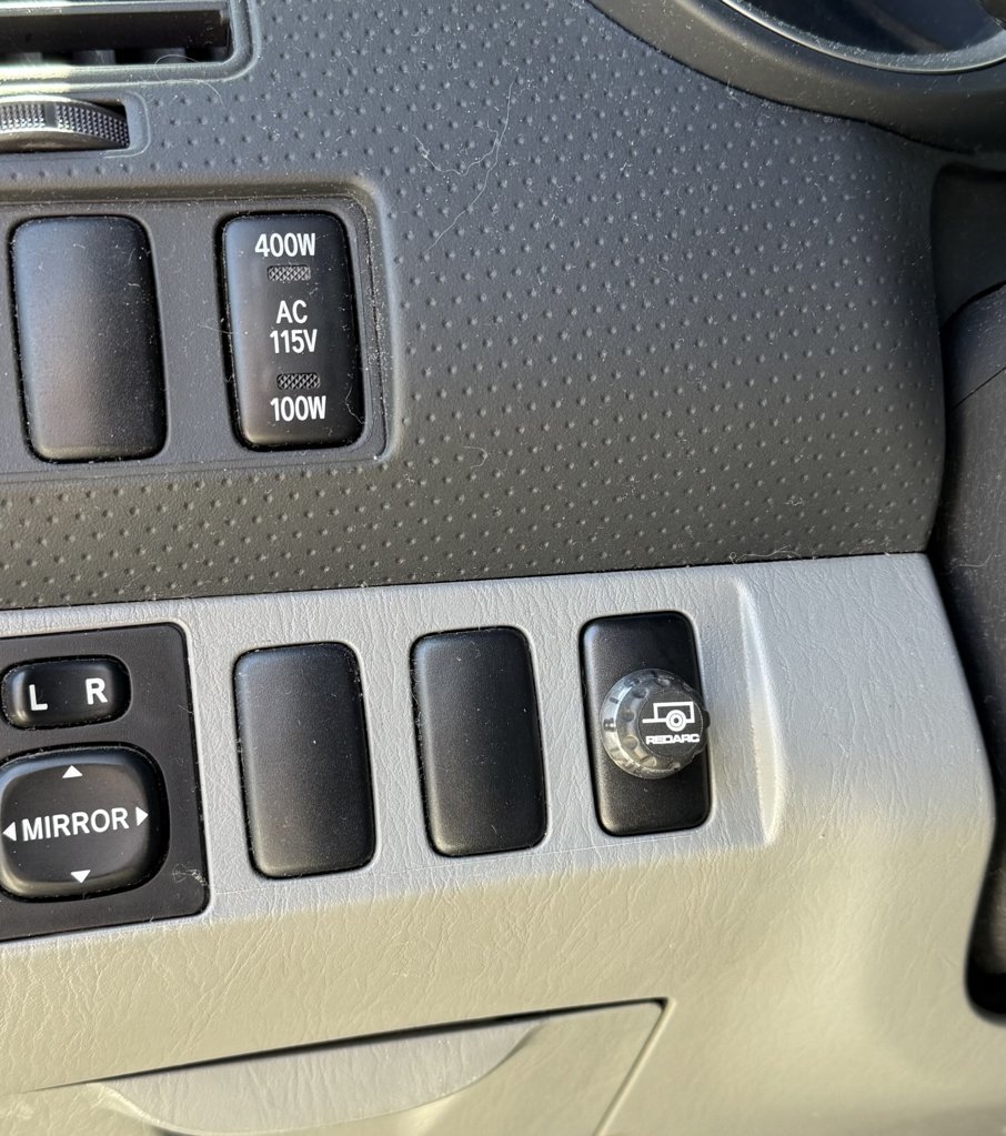

    Just installed a Redarc in my 2008. The only difficult part was finding a mounting place. PIA. Redarc sells a mounting bracket, but I didn't buy it. Short strip of cheap metal for $25-$30 - nope. I feel a mounting bracket should come with it. Anywho, screwed it to the firewall and called it done.
