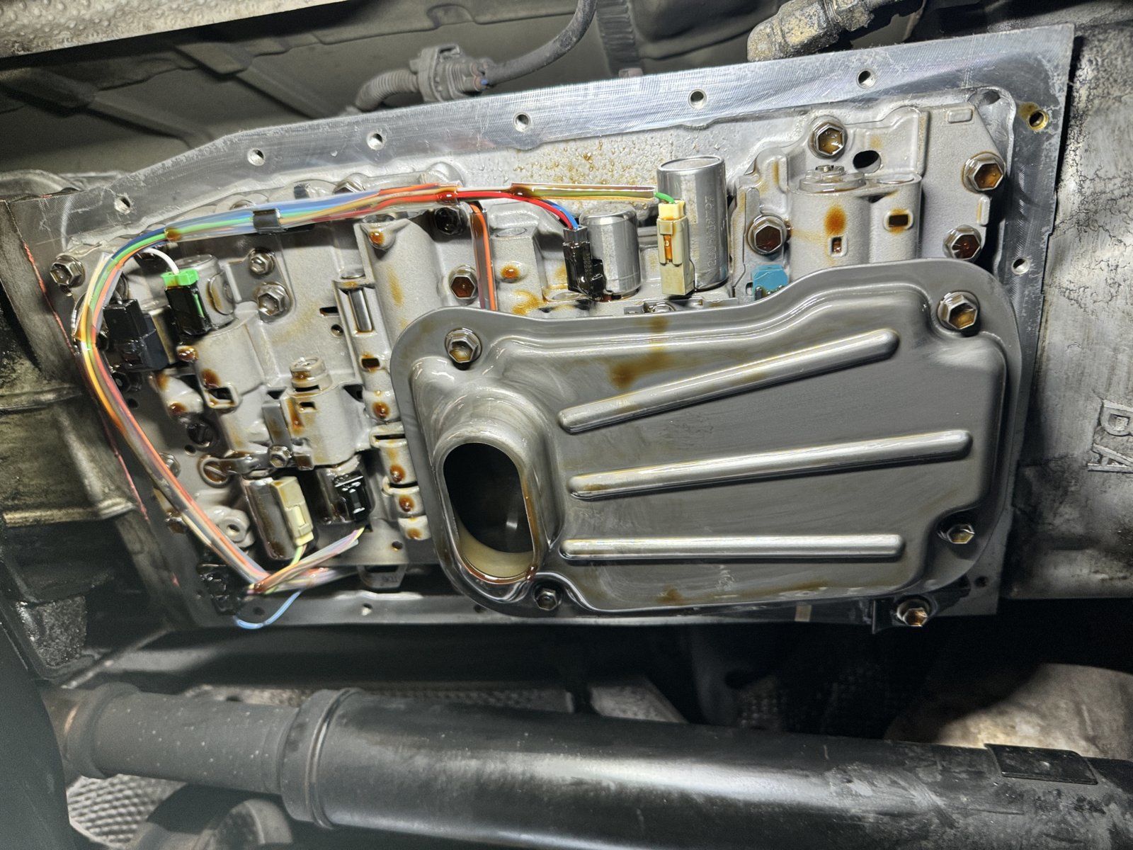

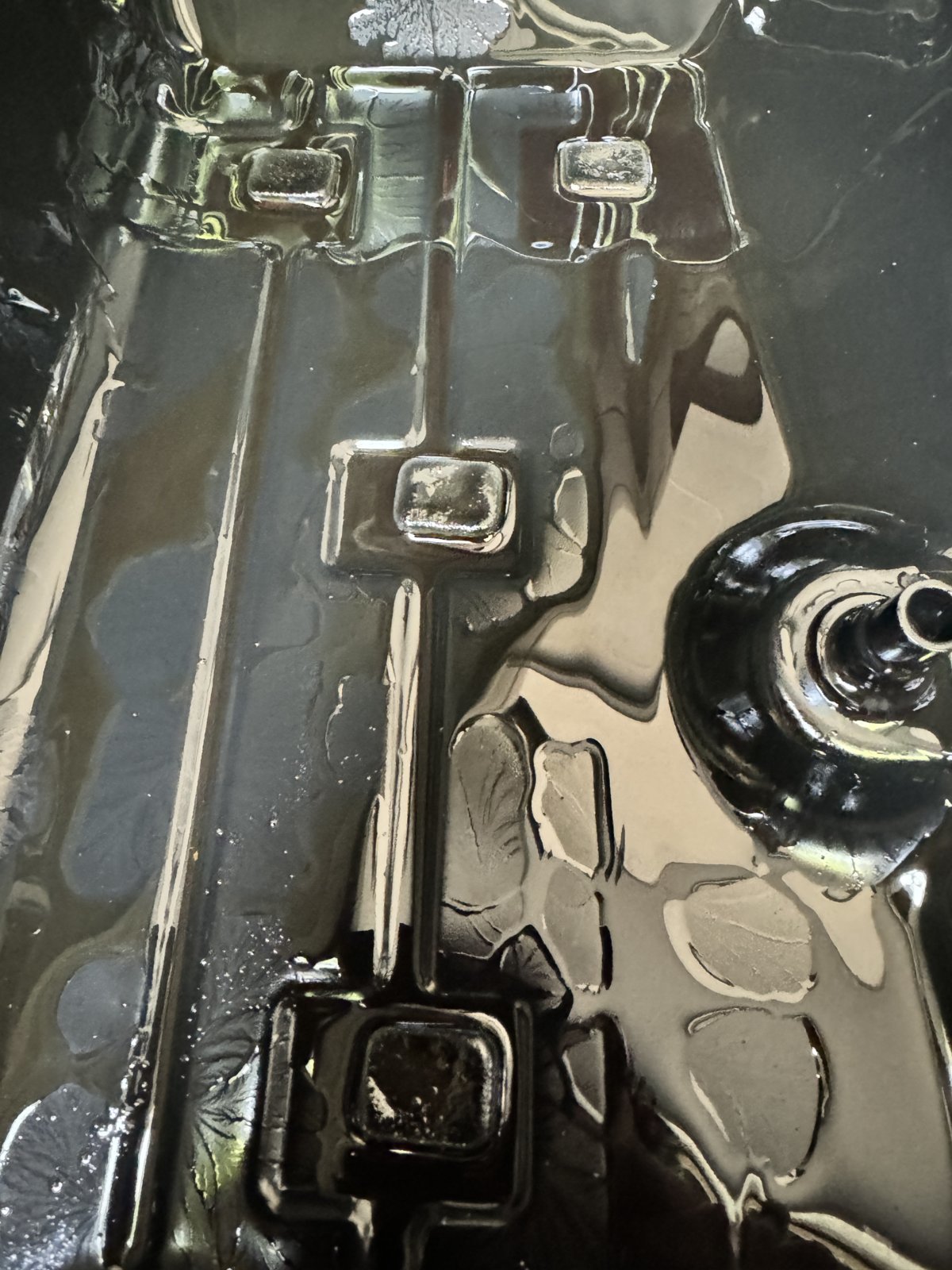

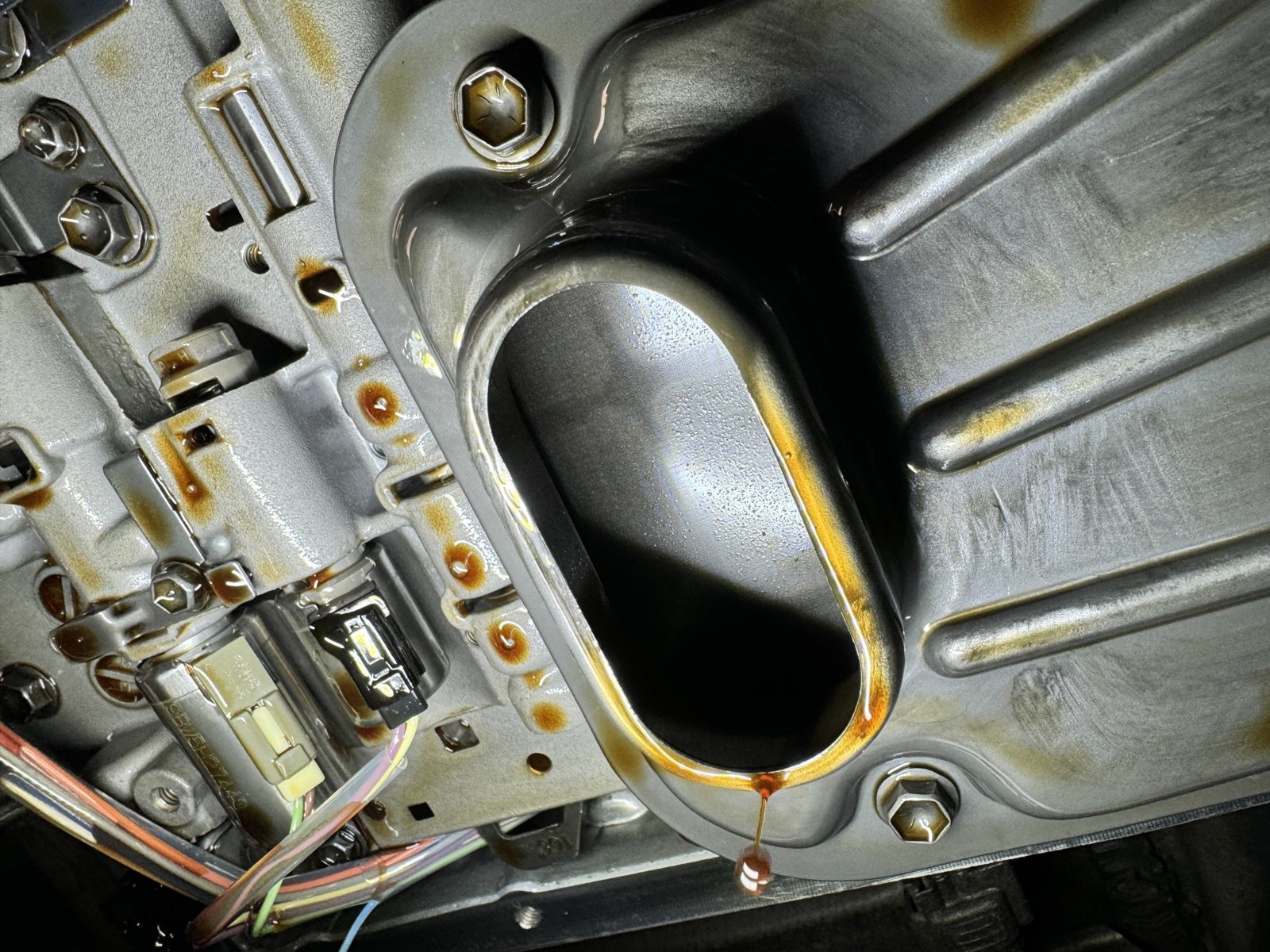

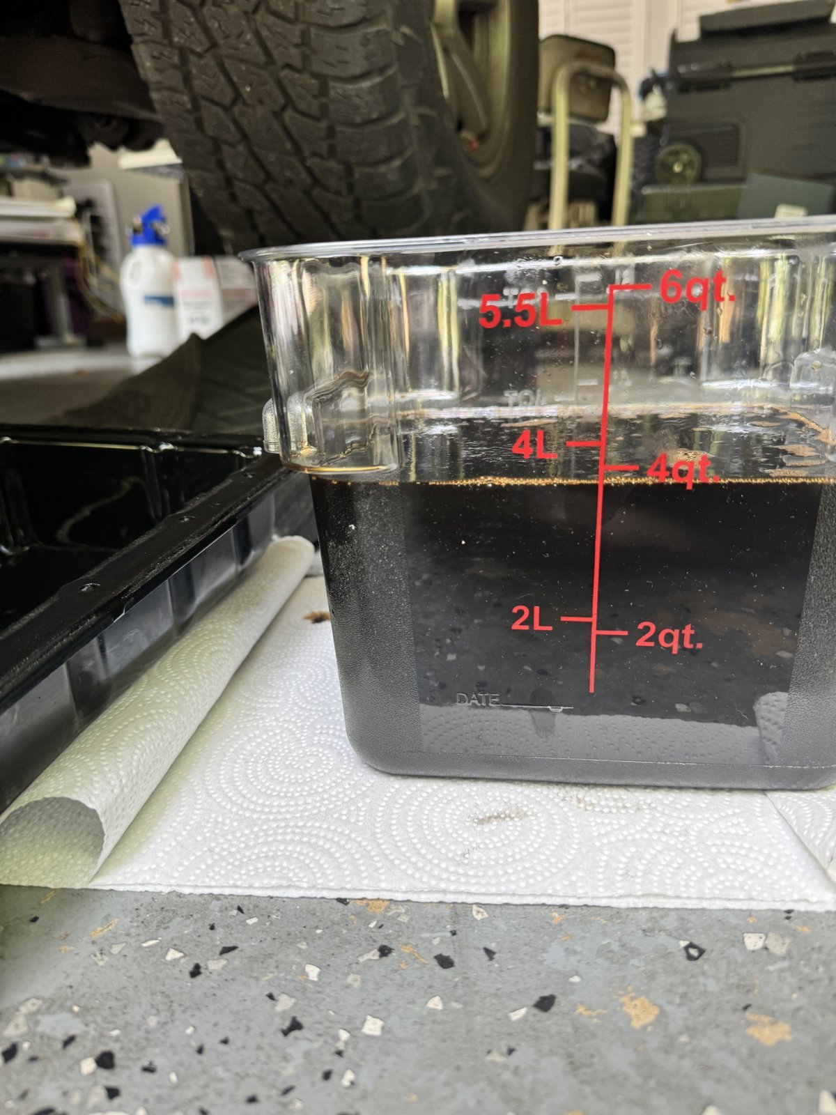

    I just did this on my GX 470 with 270,000 on the clock. The magnets, filter and the pan looked perfect. Fluid was still redish, magnets had a small amount of sludge. I have so much fluid left over and a new filter/gasket set I didn't use for the drain and fill. All for peace of mind. Pics of the GX trans.
    As for the Taco I had mine done at around 70,000 at the dealer. I asked if it was a real flush or a drain and fill. They confirmed it would be a flush. After I got home, I checked under the truck and I could see where they disconnected one of the hard lines. So at least there was some confirmation they didn't just empty the pan. I want to say it was in the $180 range.
