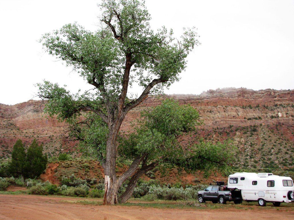

    Boondocking in southern Utah last May and planning a return trip this Spring. Over 5K miles RT from NC and the Scamp towed great. Camper weight is around 3,500 lbs plus another 1K of payload (genset, coolers, extra spare tires, recovery, etc.) in the Tacoma. 12-14 mpg

    Al.
    Huachuca
    I’m really impressed with your set up.
    Was looking how you did the hitch
    I can’t believe you pull that to Utah form North Carolina.

    Hi Don, thanks for the kind words. I’ve had a fondness for the southwest and for off-roading since my time as a young buck sergeant at Ft Huachuca in 69-70. We’d never relocate from NC but sure like visiting out that way as often as we can.
    The Tacoma/Scamp is a great combo. The fifth wheel hitch is much more stable than a bumper pull so the drive really isn’t all that bad. We can make it with two nights on the road without pushing too hard. If you ever make it to the southeast, give me a shout.

    How does the 5th wheel hitch mount in the taco bed? I've read it was a problem considering our plastic beds
  17. Jan 29, 2018 at 6:06 AM
    #77
    huachuca
    huachuca Well-Known Member
    Aug 6, 2011
    #61224
    311
    Al
    Tarboro, NC
    2012 4WD DC w/TRD offroad
    I've seen several different setups and all seem to work for the owners I know. Mine is actually pretty simple and came mostly from scraps I had from old farm equipment - I used the stock bed bolts and no additional holes, brackets or frame welding were necessary. Pictures and a brief write-up are available here https://www.tacomaworld.com/threads/modified-gooseneck-19-scamp.223474/ The pictures show it in my 05 and it was later transferred to the 12. Between the two trucks, I probably have 75-100K miles of towing the Scamp and no problems yet, Let me know if you need any more info.
    Scamp now offers a new design for their hitch that makes it easier to remove (mine takes five minutes for the cross bar or fifteen for the bar and towers). I've heard they were installing this on Tacomas but have no first hand experience with that https://www.scamptrailers.com/parts-store-cat-view/fifth-wheel-hitch-items.html or give em a call 800.346.4962 - they're usually glad to answer any questions.
