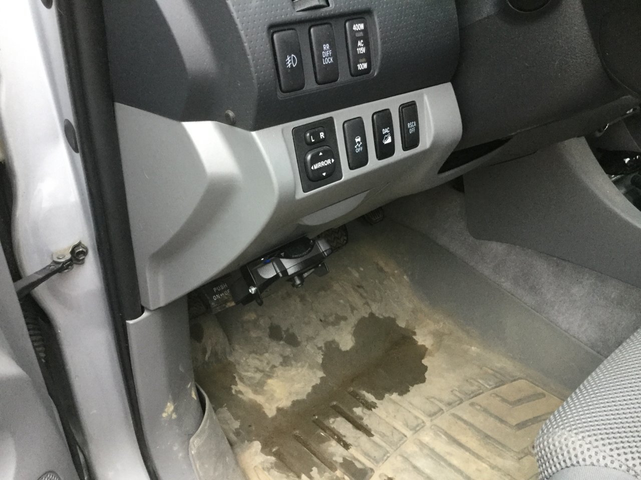

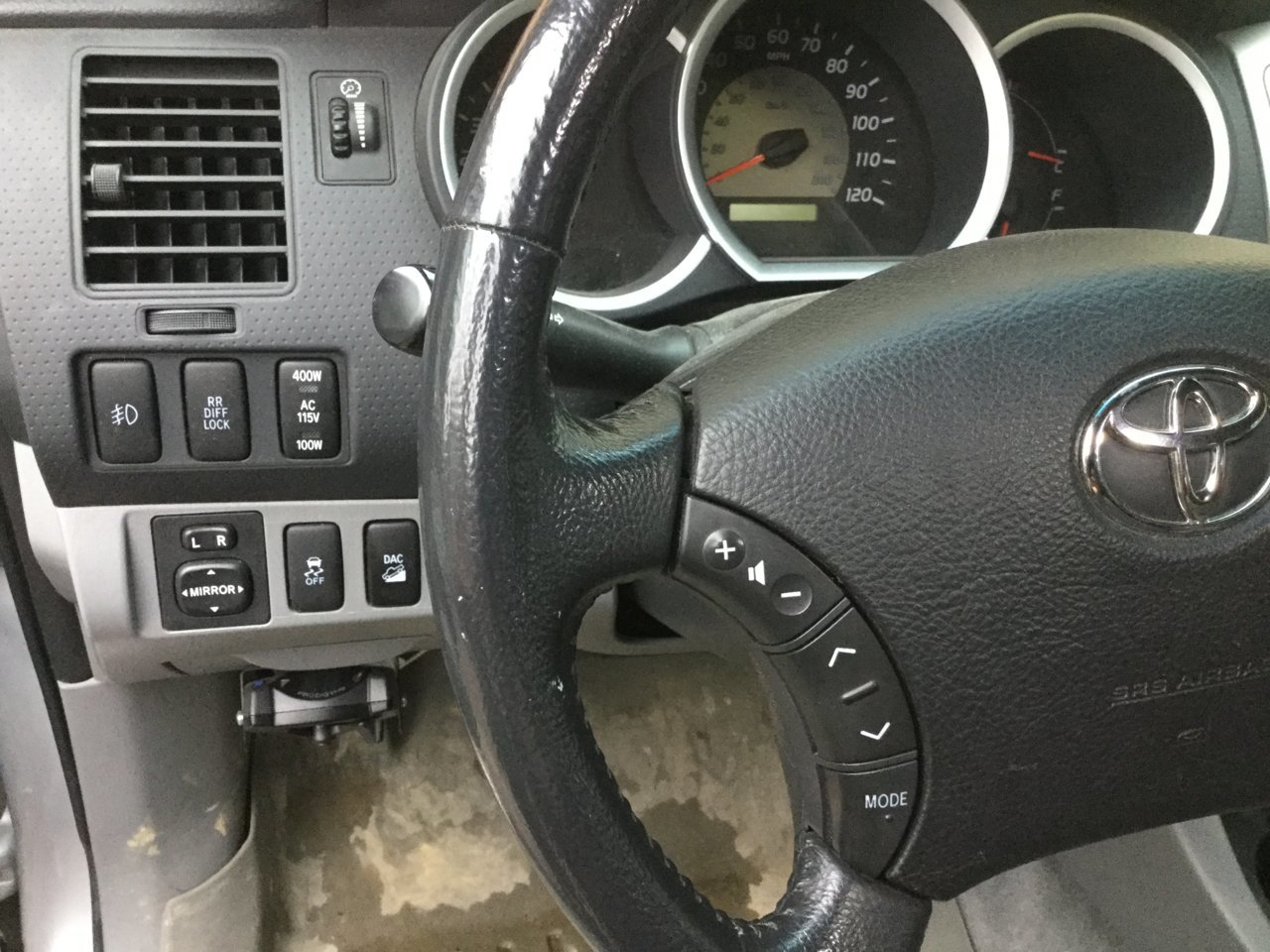

    Thats a pretty nice looking unit. Where are you guys mounting them in the truck? Im picky so Im going to have to make it look nice.

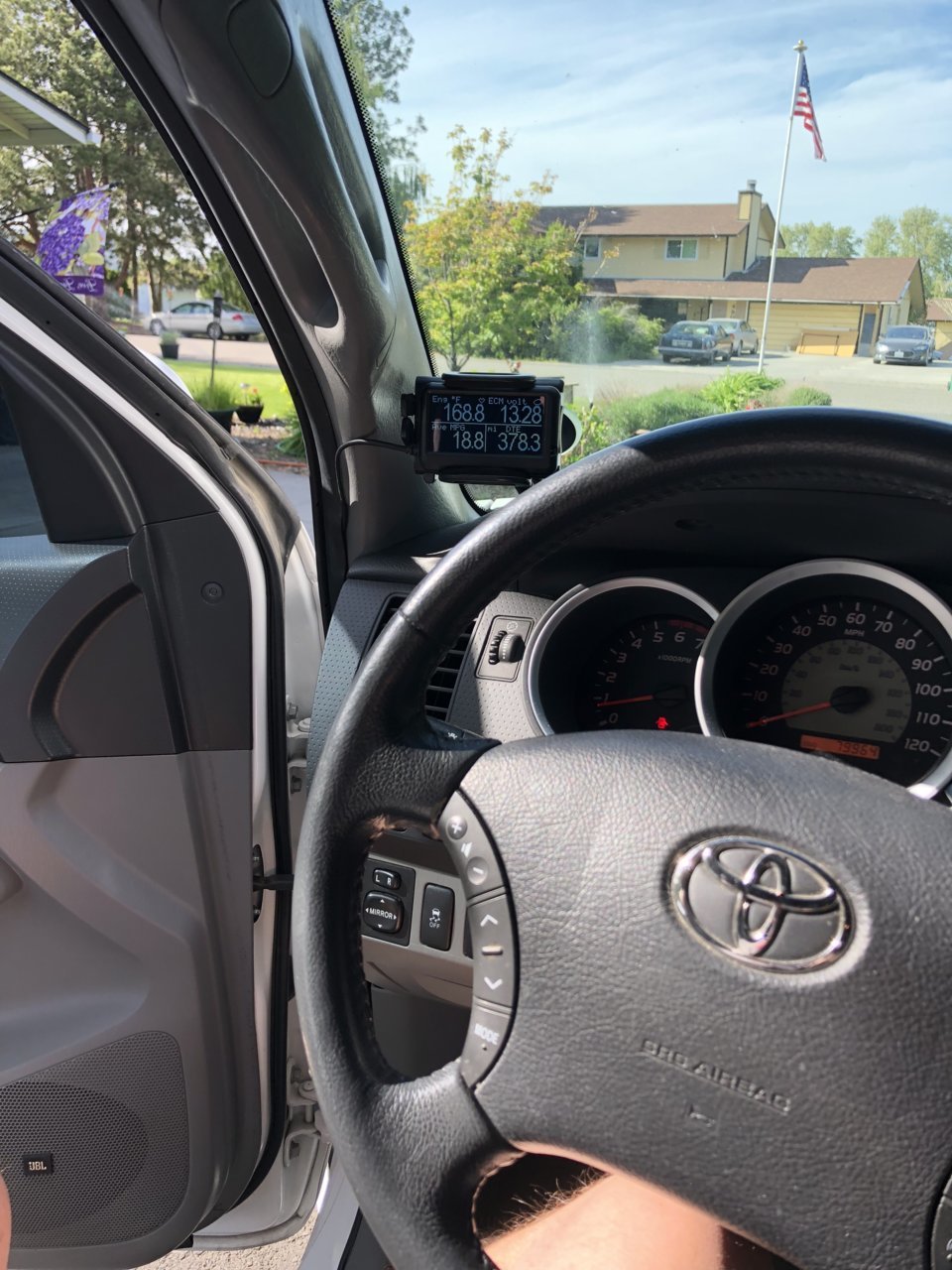

    I use a Ultragauge to watch trans temps /etc. I like the look better than the scan gauge. Just make sure to get the one that will monitor trans temps as there are different models. I have a “cheaper” brake controller and used for years with no issues but would get a Prodigy like above if I do it again. Pic of the ultragauge in window.

    I have the Prodigy P2 mounted on the lower left knee board in my 2nd gen. It’s tucked out the way enough to not be annoying but within easy reach for adjusting and monitoring if it’s working.
