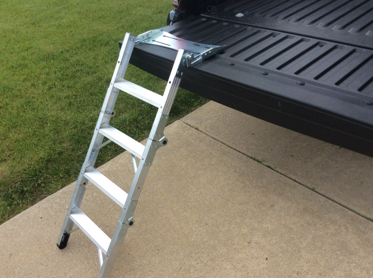

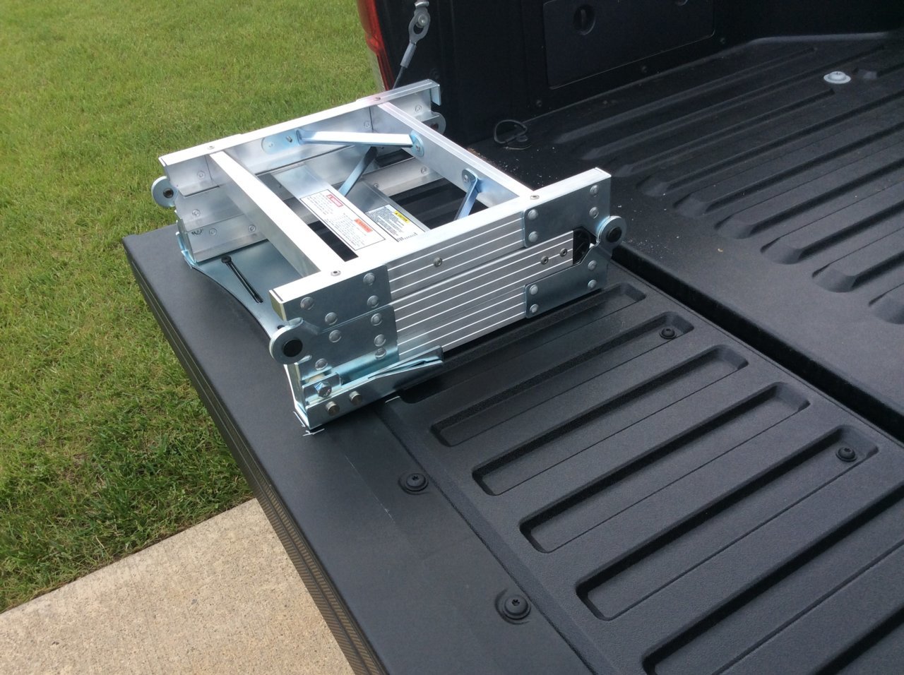

    Hey old guys.
    Yep.. older guy here.. bad knees and all. highly recommend this ladder.. i use it every time i drop the tailgate, works great when im loading up the bike too. find one that works for you, i wont go back. Dont have to get this one.. but at least browse for a cheap chinese one (or build your own!), it changed the way i use my truck bed.
    https://www.amazon.com/gp/product/B00180UVGO
    2018 trd off road long bed
    4wd - 6cyl

    That is nice. But I just bought the bed step and installed it under the left rear bumper. Works great for getting in and out of the bed. Also, don't need to have the tailgate down with the step and don't lose a good chunk of bed space. But this ladder is really nice.

    First of all 50 is not old.
    Does it detach from the tailgate or is it screwed in?
    I cant have that thing constantly in my way. It has to be removable when not in use.
    Me and my father in law have caps so you cant impede the ability to reach in and slide things out of the tailgate. (And we obviously cannot walk into the bed)
    Plus my FIL has a Ford. It has a built in step that comes out of the center of the tailgate.
    Would like them to make one of those for the Tacoma. That would be nice!
    This ladder doesn’t work with a lift either... which is an issue.

    I just posted it to share because it changed the way i use the bed. I dont have mobility issues... just super sore knees when getting up in the bed. Your idea of a mat might be a better solution. The ladder i have does NOT detach without removing the 4 screws that hold it in.

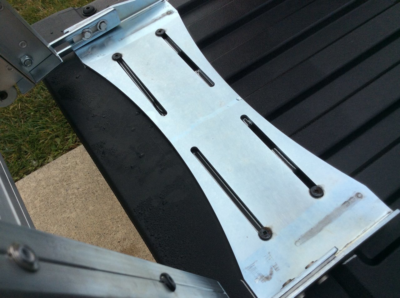

    Looks like it attaches to 4 OEM Bolt spots is this true?

    no sir,
    4 sheet metal screws that go into the tailgate. but you could use anything really. Im guessing the Mobtown skin would only help hold it, not hinder it from installing.

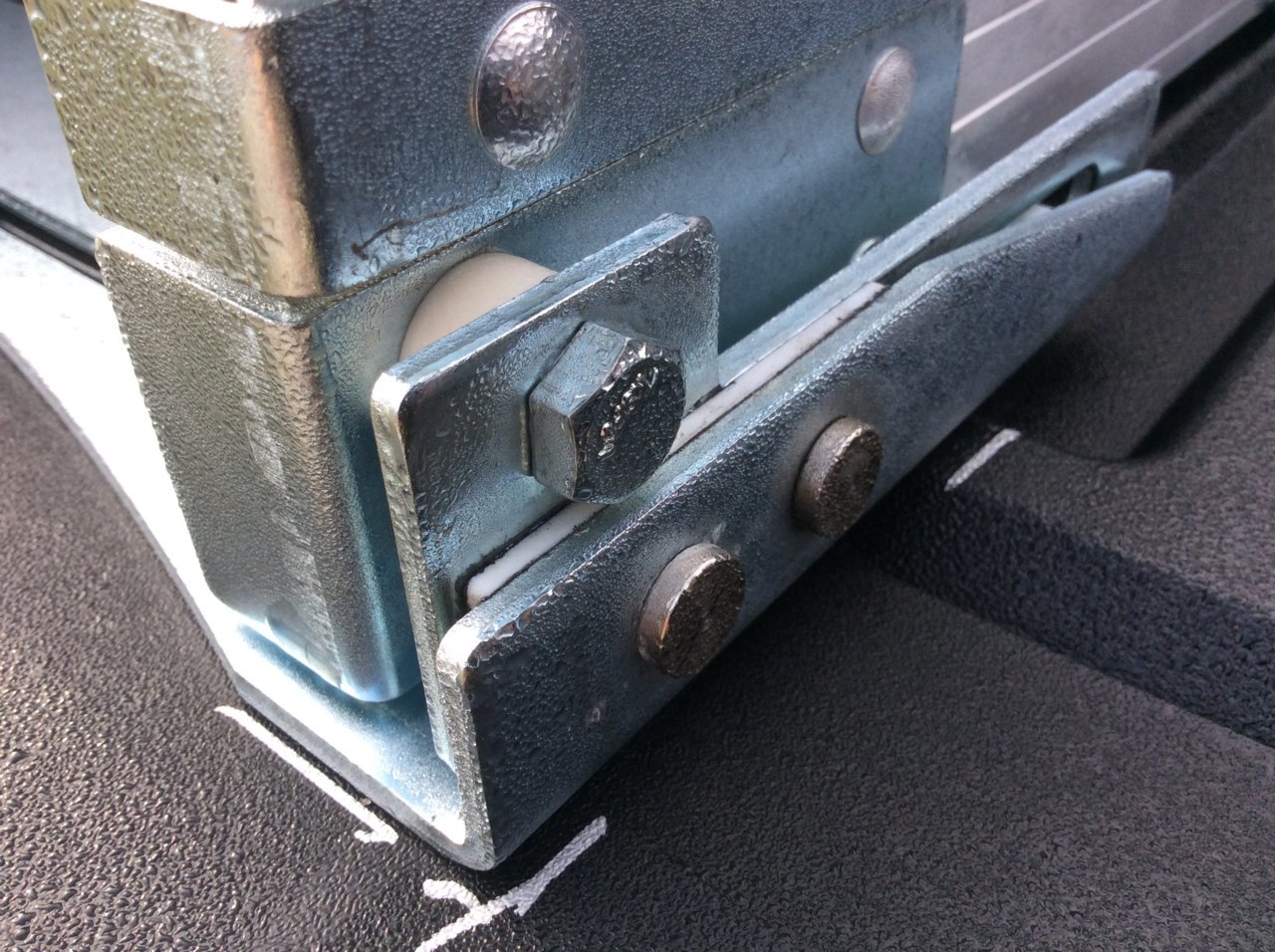

    It looks like you could replace the hinge bolt with a clevis pin for easy removal.

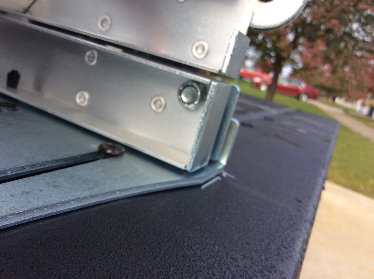

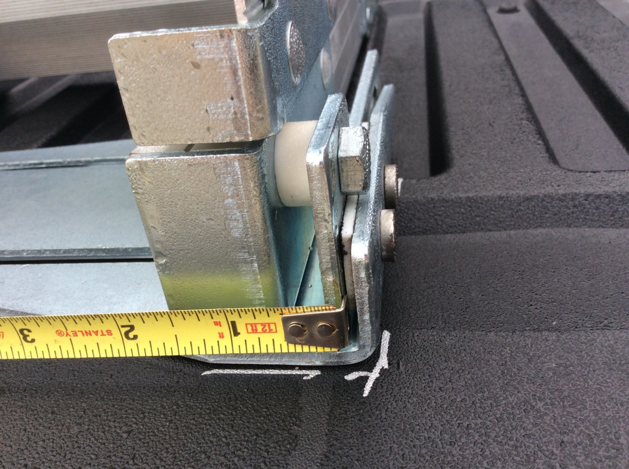

    There is a slider that sticks out a bit, but besides that, its got one bolt on each side with a bushing so it will pivot. Got some photos for you all here. I might approach it differently, use 4 rivet nuts in the bed of the truck, and just remove the 4 easy to access bolts everytime i wanted to pull it out.

    Unchained, hoping this helps.

    So 4 holes need to be drilled with fasteners on the other side? Helps a lot thank you
