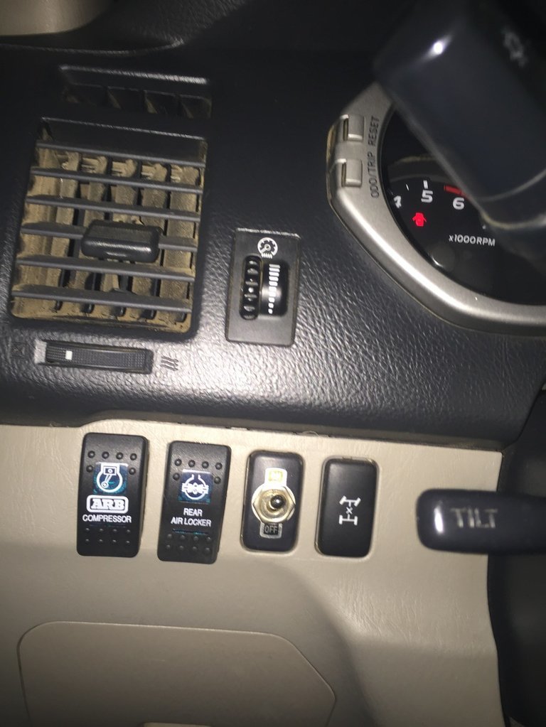

    I'm hoping someone can clarify this for me. I have a 14 Tacoma and my brother has a new to him 08 4Runner. I was explaining to him how to use the 4wd, as I thought it was just like my Tacoma. But after a little online research, some of the 4runners have some different types/options than the Tacomas. His 08 does have a knob with 2hi, 4hi, and 4lo. I haven't checked but he thinks it might have a button or two that my Tacoma doesn't have (maybe a diff lock?).
    So, is his 4hi actually an AWD? But then you can lock the diff with the button to for true 4hi?
    I don't know if I'm even asking the right question. And I had difficulty understanding all the jargon in my research. Can anyone explain this to me? And how his 4wd '08 differs from my '14 Tacoma?

    Center locker locks all wheels. Rear locker locks the rear wheels.
    So, a center locker would lock all 4 wheels so they spin the same. No slippage on any tire.
    Rear locker just locks the rear 2. They spin at the same rate.

    As Rock Lobster mentioned, the center locker takes you from open center diff (AWD) to regular part time 4wd, where power distribution is 50/50 front to rear. It does not lock 'all the wheels', left and right wheels can still turn independently on each axle. A rear locker in a Tacoma is already operating in 4wd and locks the rear axle so the left and right wheels turn at the same speed eliminating slip, so they are no longer independent.
    The advantage to the center locker is you can run AWD on the pavement in conditions not bad enough for 4wd, which cannot turn on the pavement unless there is sufficient ice/snow.

    My 2014 limited 4Runner is AWD with a locking center diff. It also had 4lo and ATRAC, But I traded it in for a trail.

    Correct, the v6 has selectable 2/4hi/lo, which mine does, they also all have the Torsen center diff.
    I believe, but am not sure as I don't have one and don't spend much time in their forums, in the 5th gens, the limited are the only ones with the Torsen.
