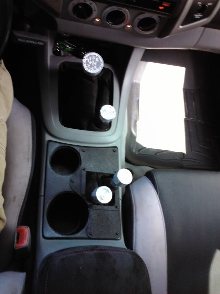

    This is such a great use of all of the extra cup holders!! why didn't I think of that :rolleyes:

    meh, mine looks better ;)

    not like there arent 8 other cup holders to use in a manual access cab. losing one aint gonna kill anyone
