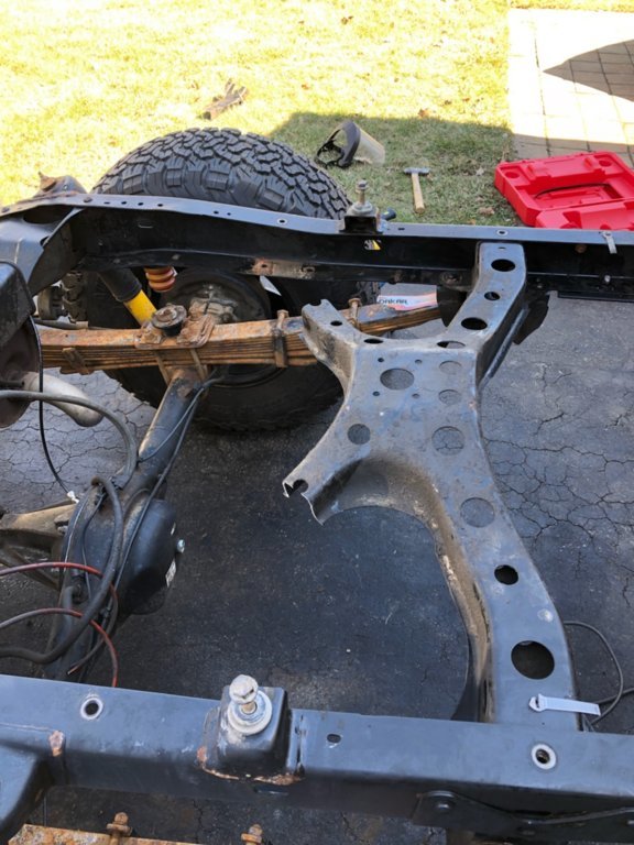

    Are you going to clean up your frame or tackle some rust spots while everything is apart or is that not a concern?

    Yes. Will be sanding, cleaning, galvanized paint, and then rustoleam on top of that.

    Get some POR 15 on there. Good God you have a lot ahead of you ahha.

    Used por15 on my sliders. Found it to peel off on some areas that had not rusted. So I’ll be trying the galvanized paint as a first coat.
    Yes. I know....hoping to get it down this week...

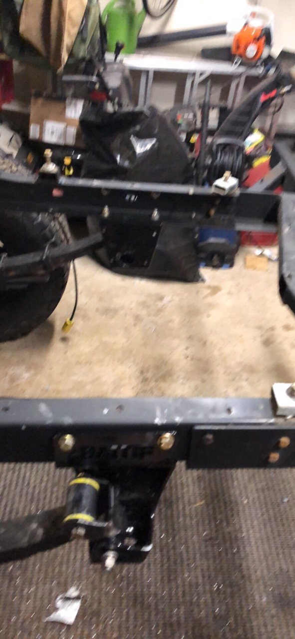

    But this is just... a big WOW!! Nice work!
    ... and what are those little bracket thingies hanging down off the axle on the outsides of the flip kit?

    FJ t-case with twin sticks and some other things :D
    You know the answer to your question, what piece of the rear suspension is missing?

    Haha. Those are the shock mounts. I have to do the driver side still so I left the old man emu shocks off. Plus I’ll be replacing them with billistien b110 when they come in.
    Kemosabe and llamasmurf[QUOTED] like this.

    Also no flip kit. I just got beefier hangers to replace the stock ones.

    I think he was referencing the U-bolt flip kit, hard to tell sometimes with these noobies :rofl:

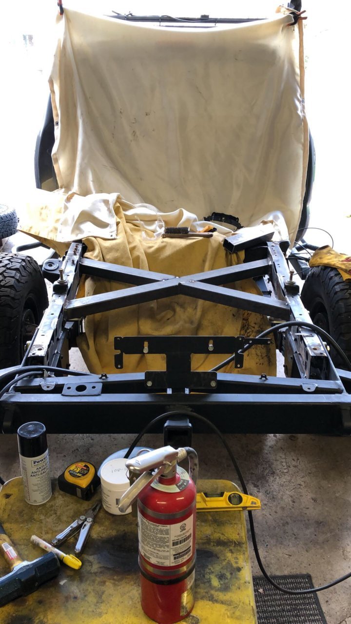

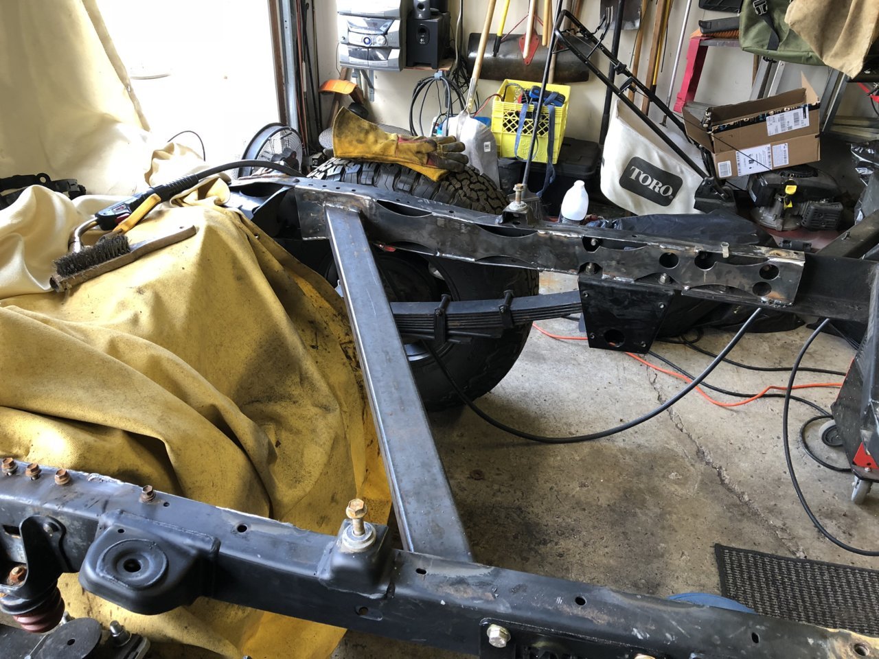

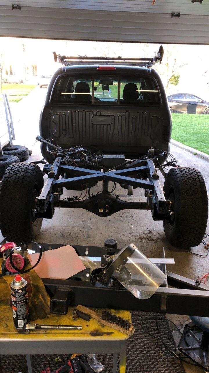

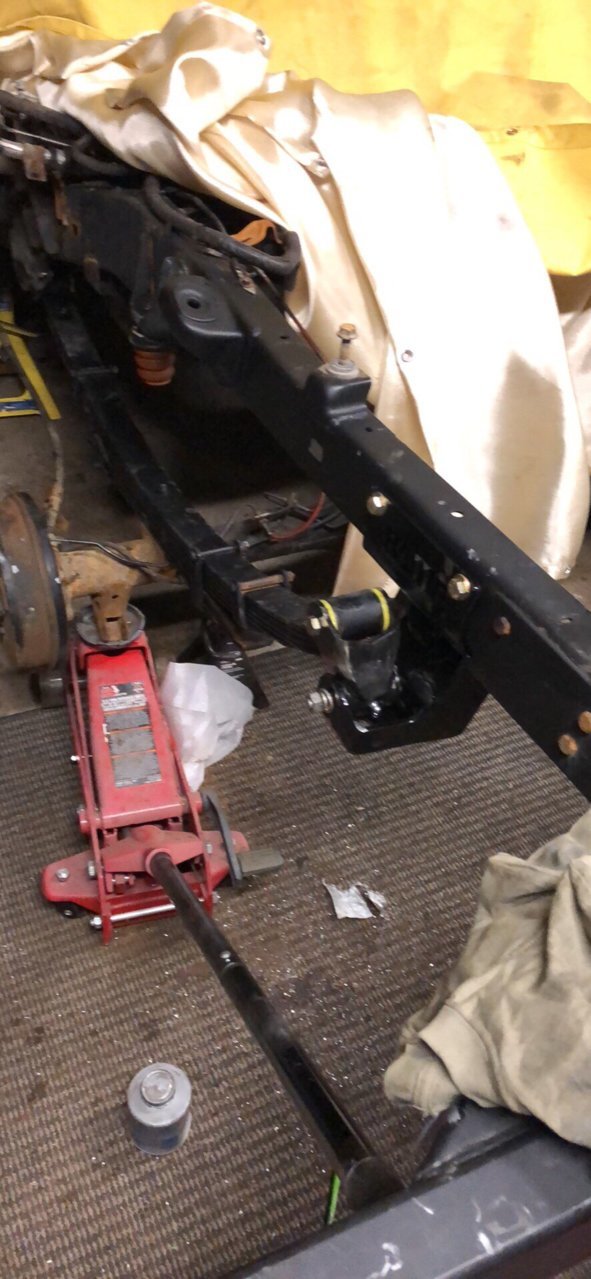

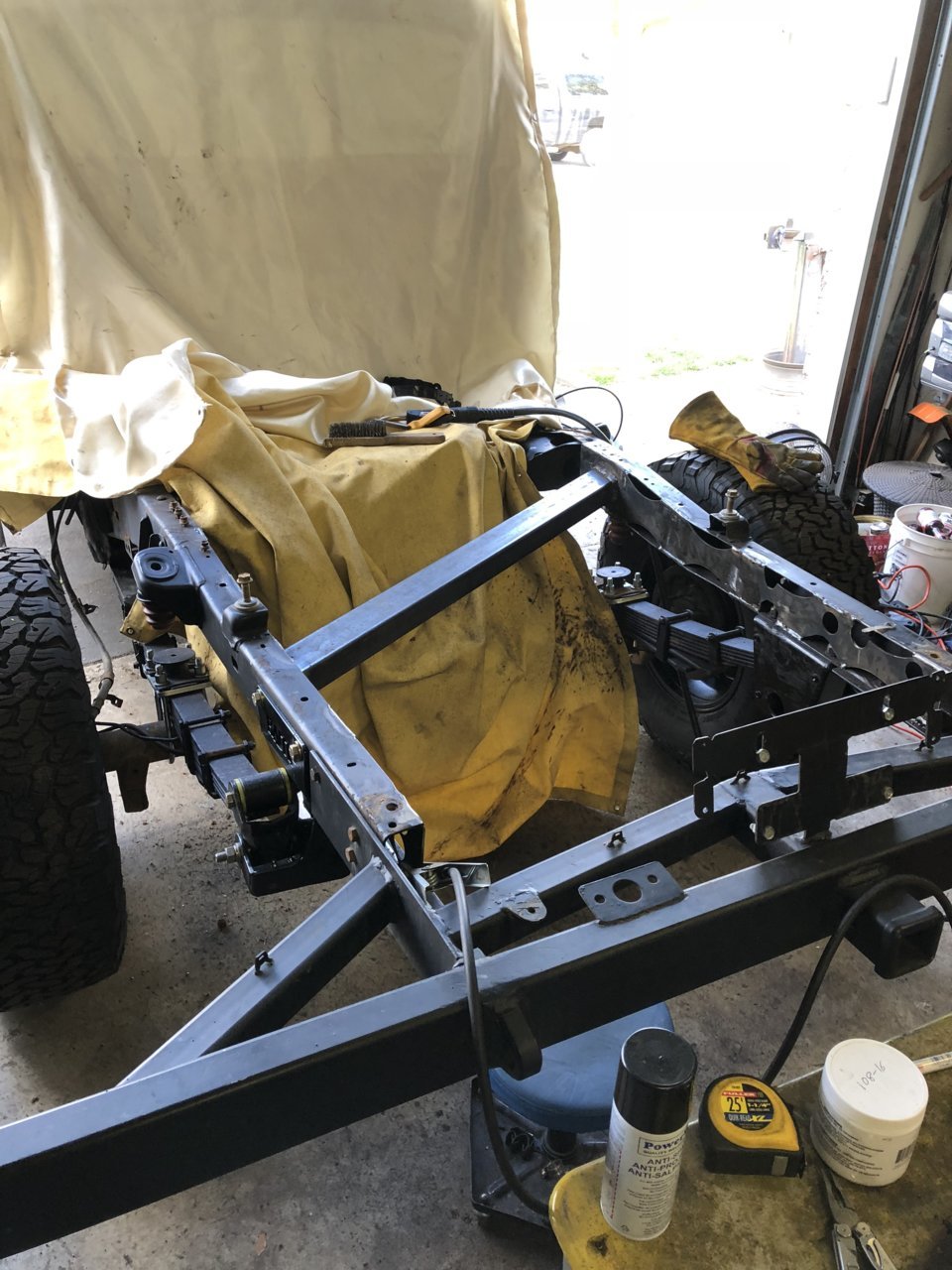

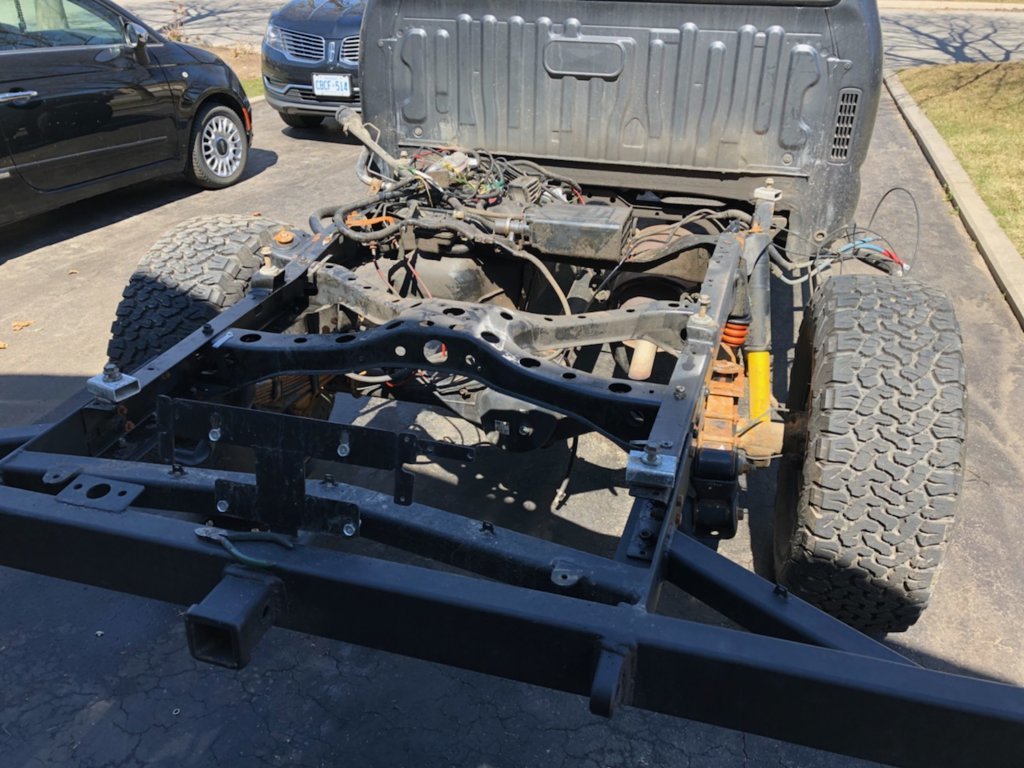

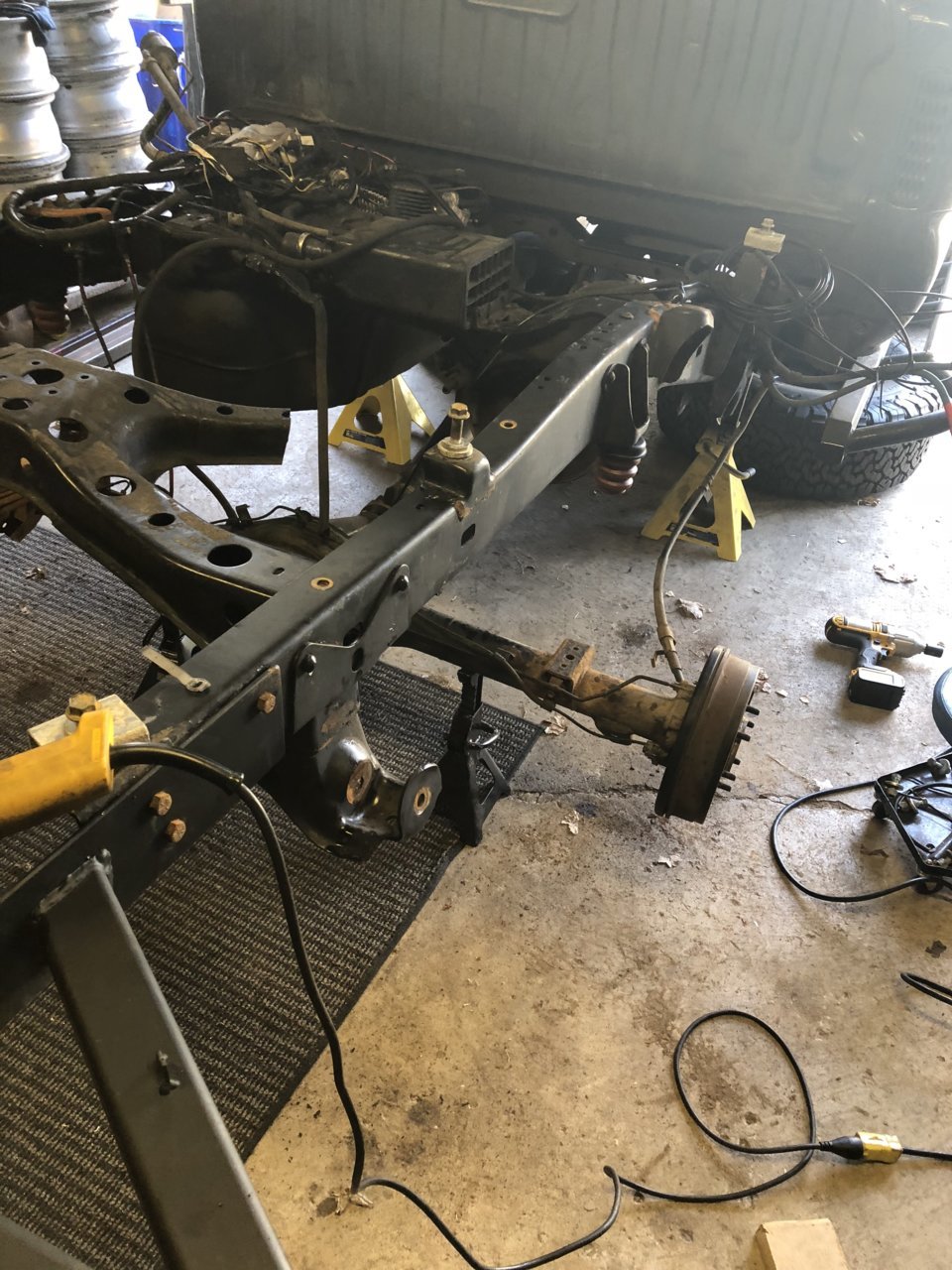

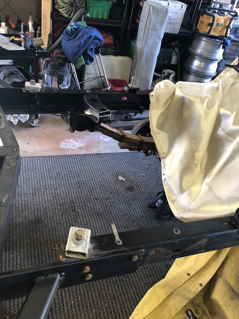

    Frame boxing
    So using some plates from tw I was able to box the frame. The rear end of the plates look like Swiss cheese so I could access bolts for the bumper and shackle hangers. Didn’t want to weld a bolt in case it got fubard.
    557D12A2-48A8-4629-87EB-6F6845063777.jpg 8DB890EA-F29F-4A85-951E-CA3C506A25C7.jpg 1D9536AD-9BD8-4DB1-A624-D3E8FFBCBB51.jpg 62FD8F12-DD51-4383-AA75-97AAC3BF3D4C.jpg
    Was a pain welding by the gas tank and brake lines. All in all this job took from 12:30-7:30. That also included a power outage for an hour or two which made welding hard. Fitting up the new crossmember sucked, a plasma cutter would have been nice but I used a Portaband which doesn’t like angle cuts too much.
