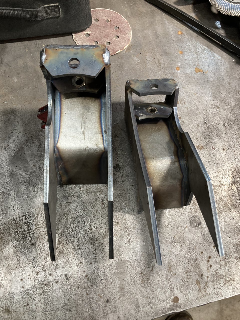

    I had a hell of a time trying to measure the gaps and guess the collapsed bushing height. See how she holds up.

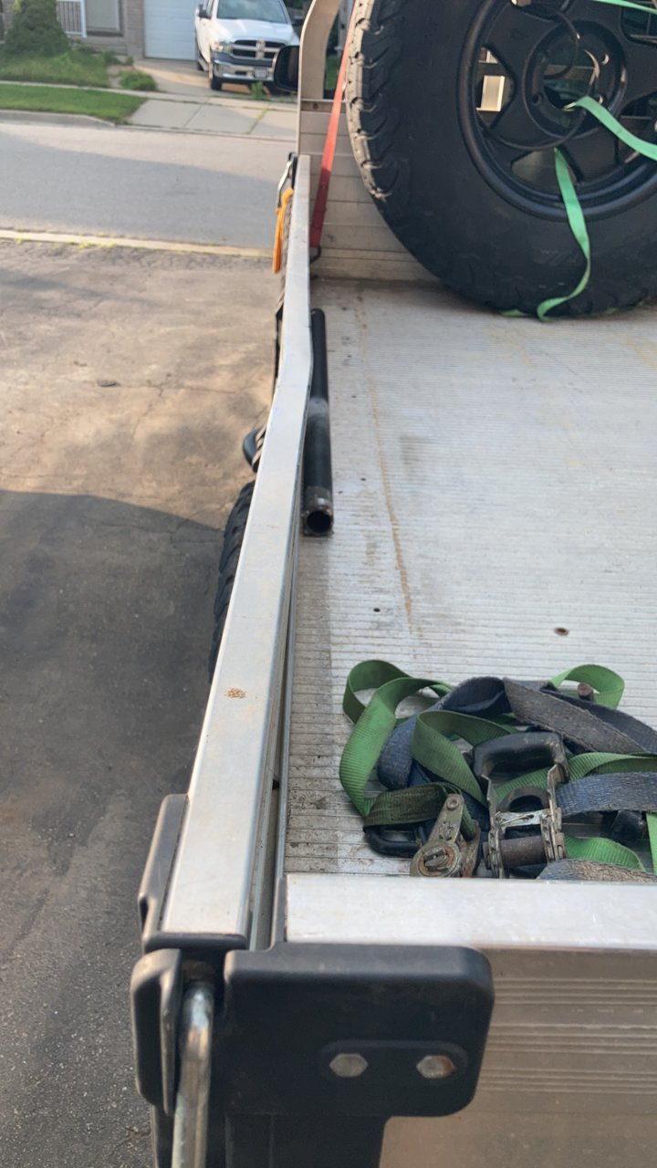

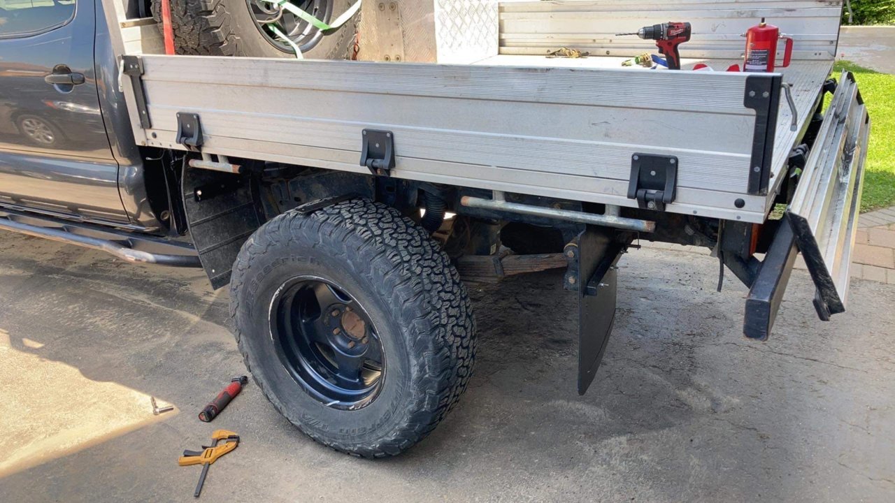

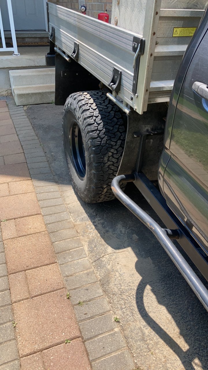

    After damaging and loosing a mud flap on my last trail run I made some new ones that have a bit more coverage and hopefully won’t get caught up on stuff.
    271E07FF-C8AC-4F8D-89F9-DF4353265193.jpg D030C84C-BCED-467B-862A-F416855215FC.jpg

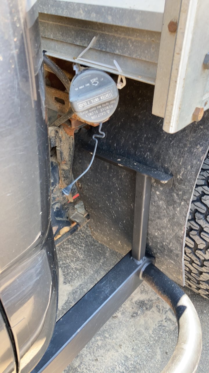

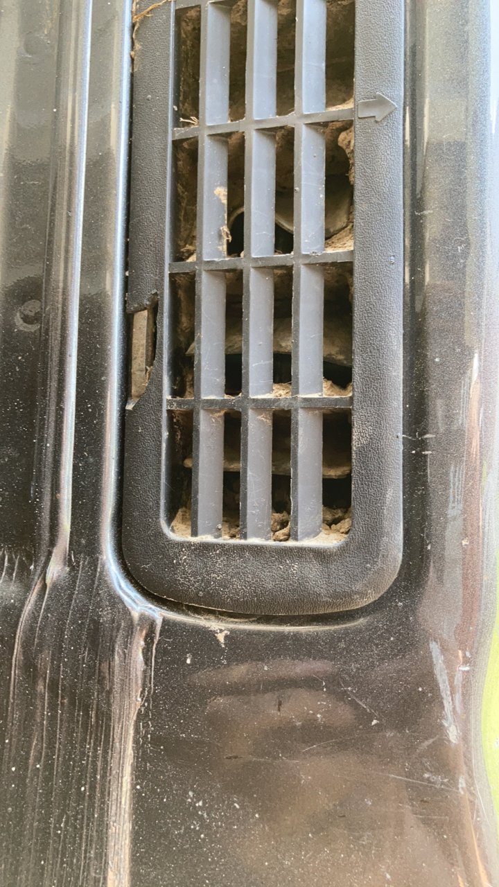

    Really happy to have the front flaps as it should keep the filler clean 7C51F71A-88D0-4CD6-82F5-ED7F6919473D.jpg
    also should keep dirt out of this vent too which I still have to clean out.

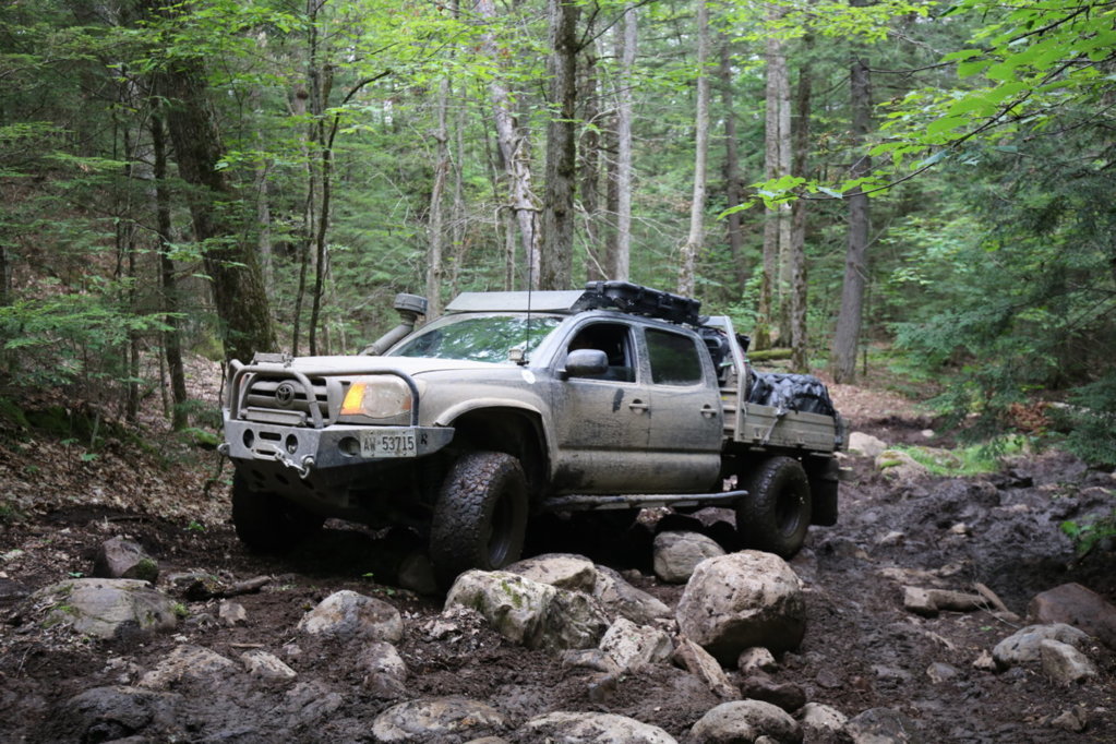

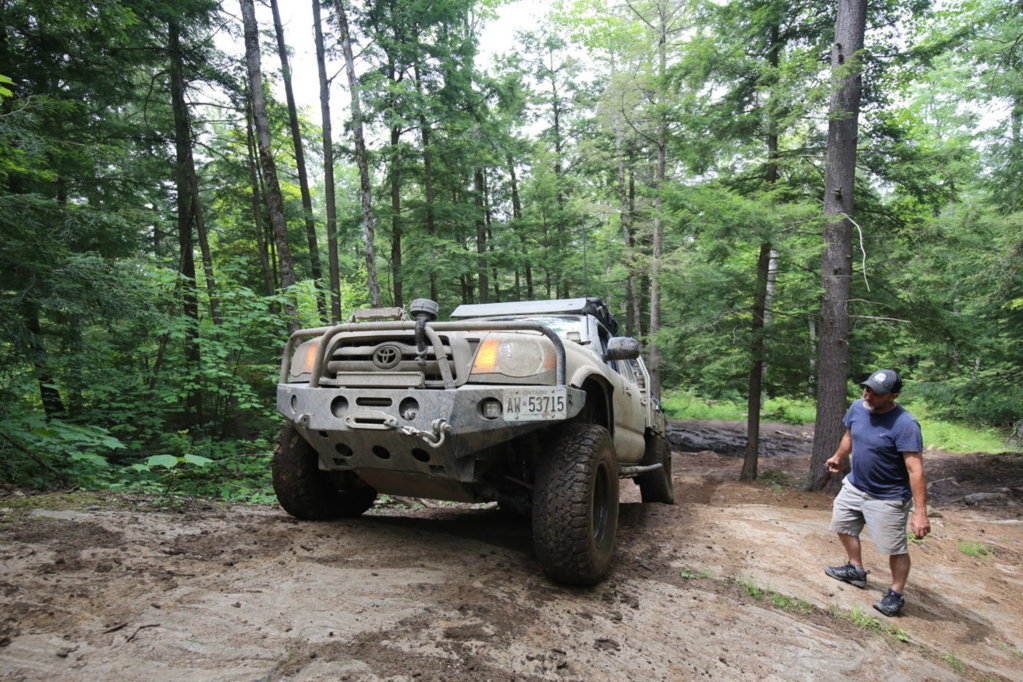

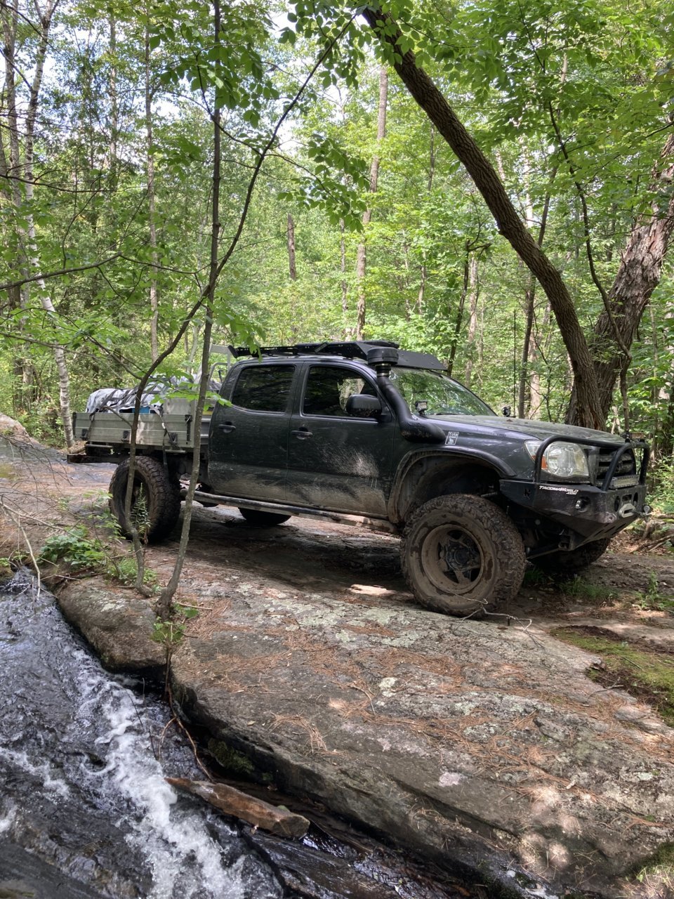

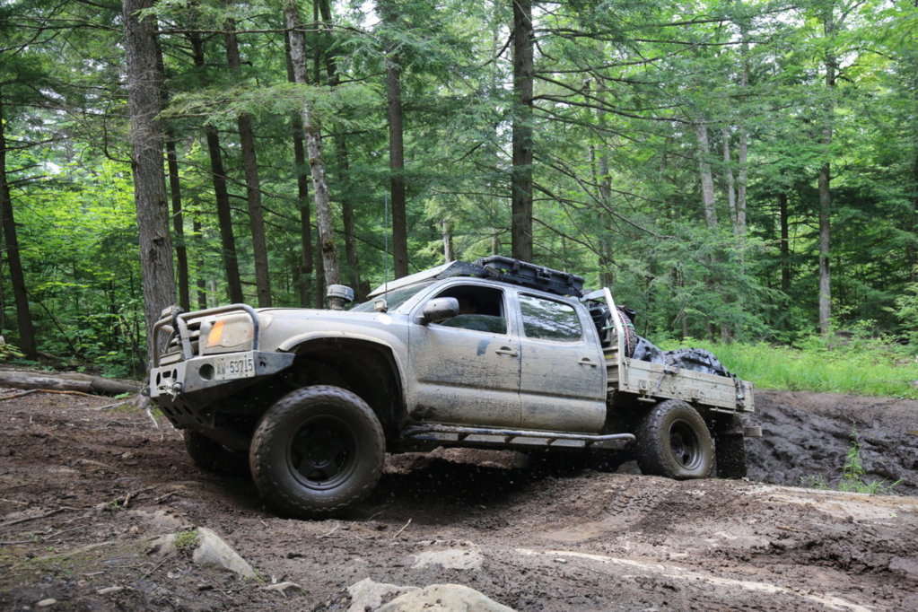

    Some pics from the last trail 2 trail runs

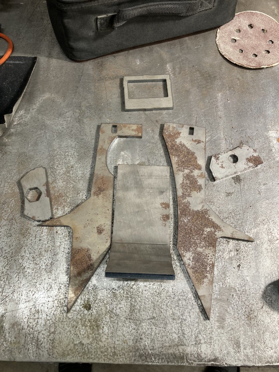

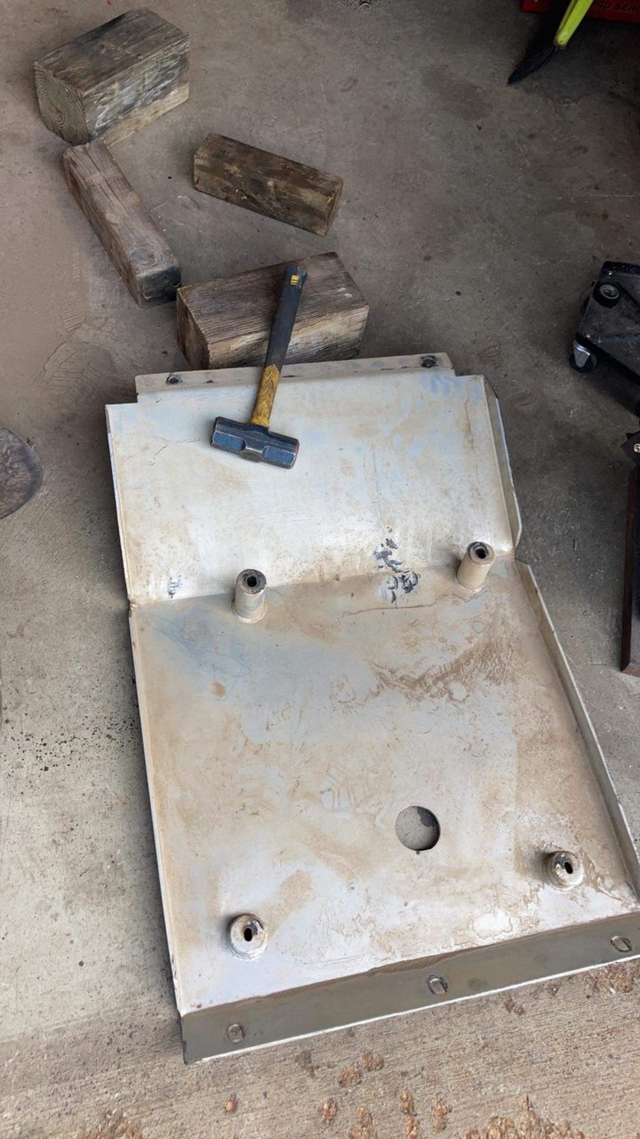

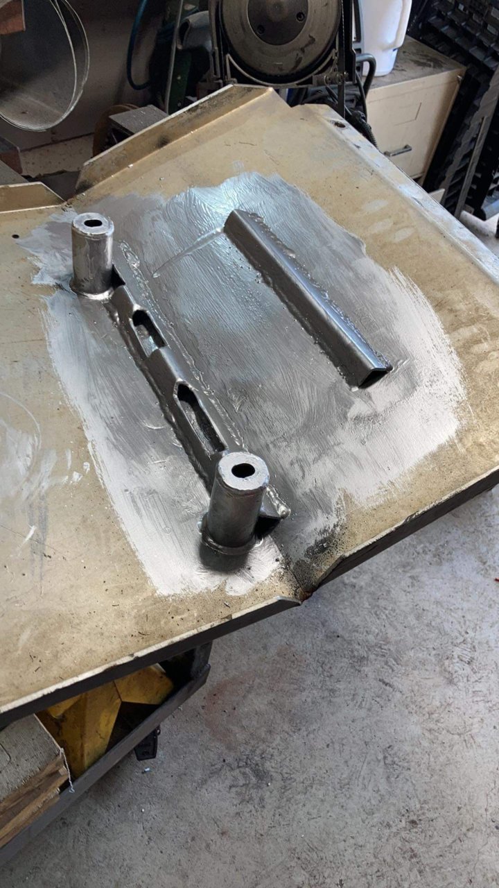

    Last few trail runs were hard on the front skid. Had a decent size dent in the front.
    Beat it till it owed me money
    then just welded some scrap angle I had laying around. Won’t do much but may help a bit.
    also the bottom of my skids are painted an aluminum colour. Helps to see if there is any oil leaks or anything collecting on the bottom. Thanks @Norilsk for the tip.

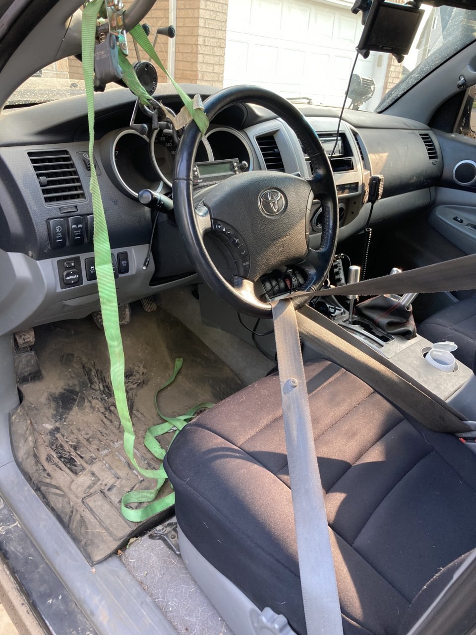

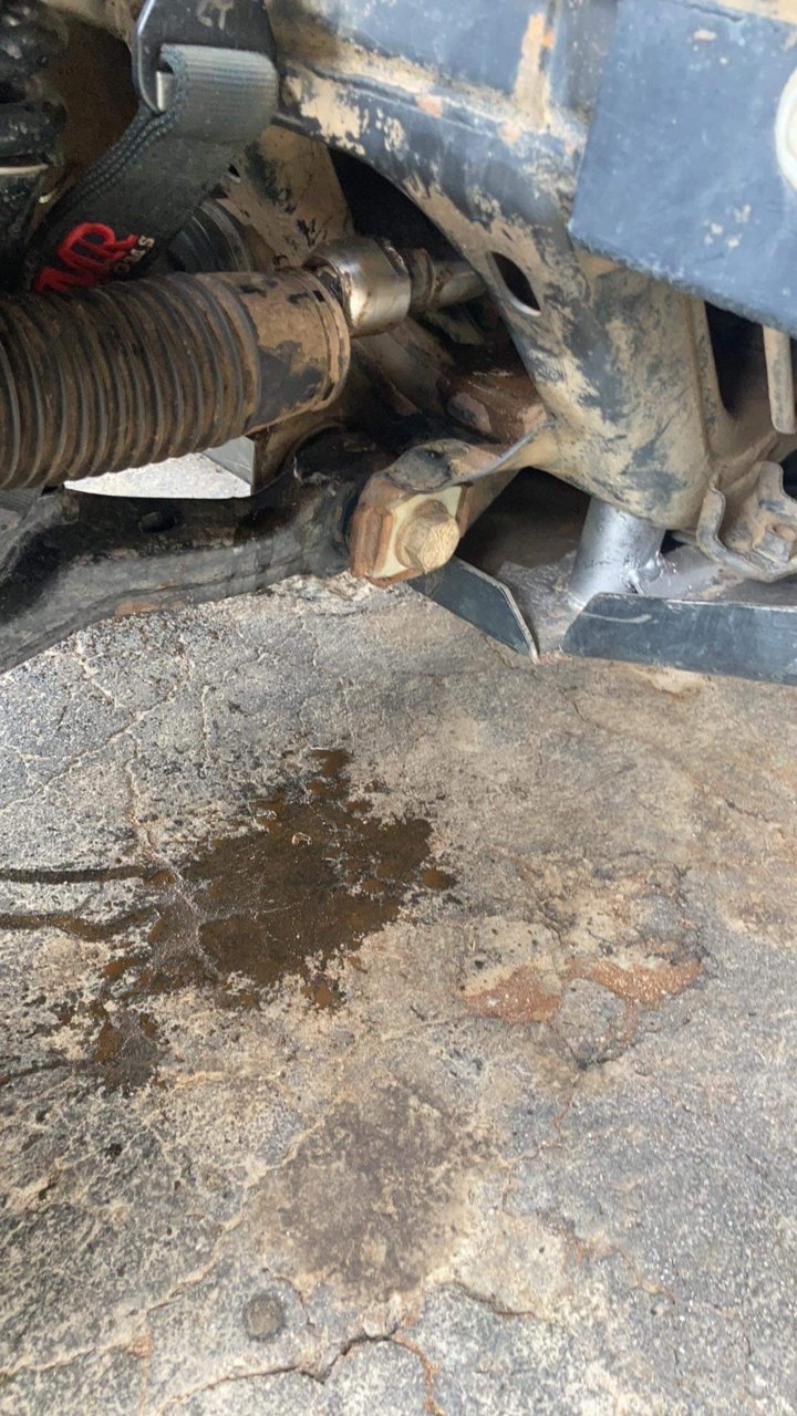

    Was hoping to run concessions this past weekend. 15 minutes on the trail and the steering rack stopped working. Got to the point where anything other then a 1/4 turn left or right was needed to be muscled. Interestingly fluid didn’t drop so I’m thinking I bound up the steering by skipping a tooth or something.
    220k kms on the stock rack. 33’s at 90k and 35’s at 180k. It didn’t owe me anything.
    Fluid that came out. Thinking mainly mud which didn’t help the rack im sure.
    clock spring ain’t breaking today I hope.
    and rack out in about an hour. I did cut the one bolt instead of removing the alternator. Will buy some new ones and thread them from the top. May drill a hole and put a cotter pin.

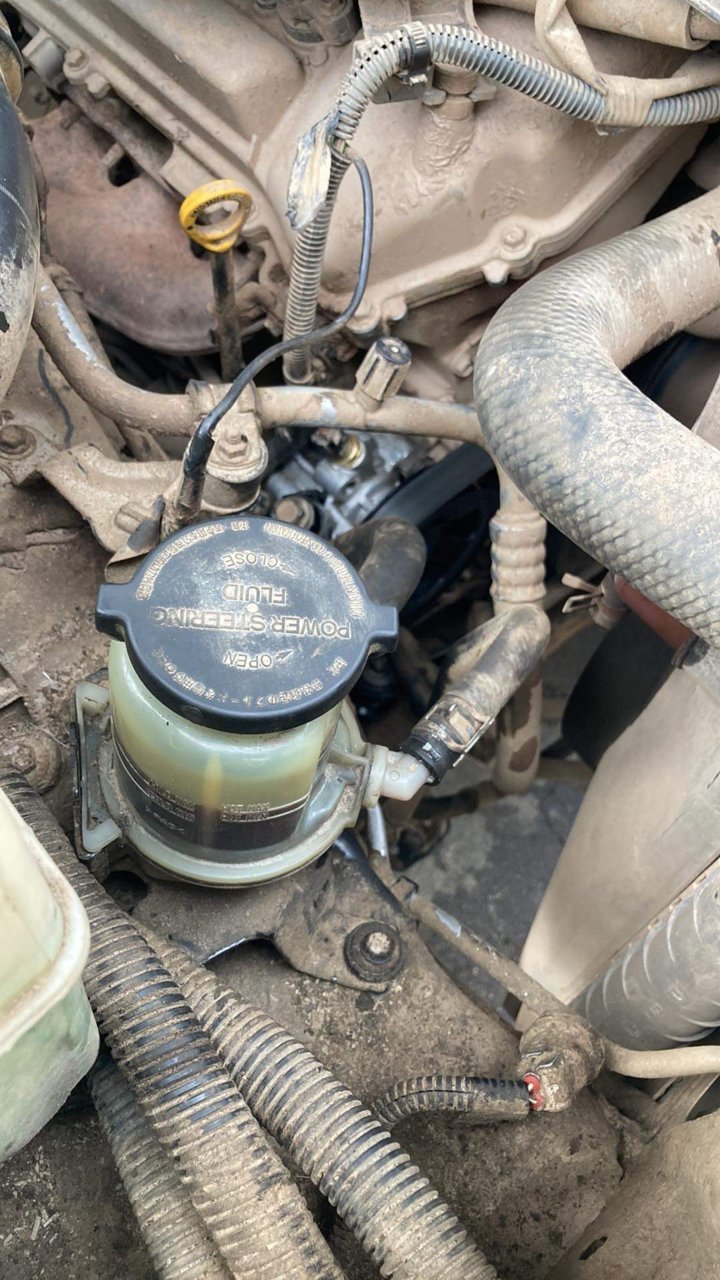

    Trucks back on the road for now. I ended up putting a new pump on as well.
    Only pic I got. Cleaned the reservoir really well and bled the system a few times over a couple days (let any air get to the top of the system).

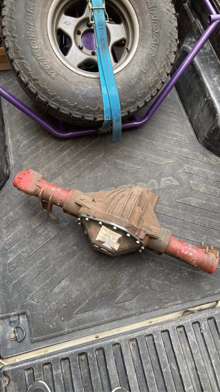

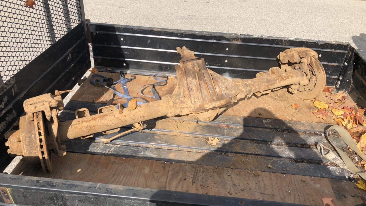

    Essentially picked up this 14 bolt for the shave kit that was bolted on it. Was cheaper then just buying a shave kit alone.
    Cool thing is that now I have a center section that has already been machined for if I get crazy and decide to make a 14 bolt front or a steering rear axle lol.

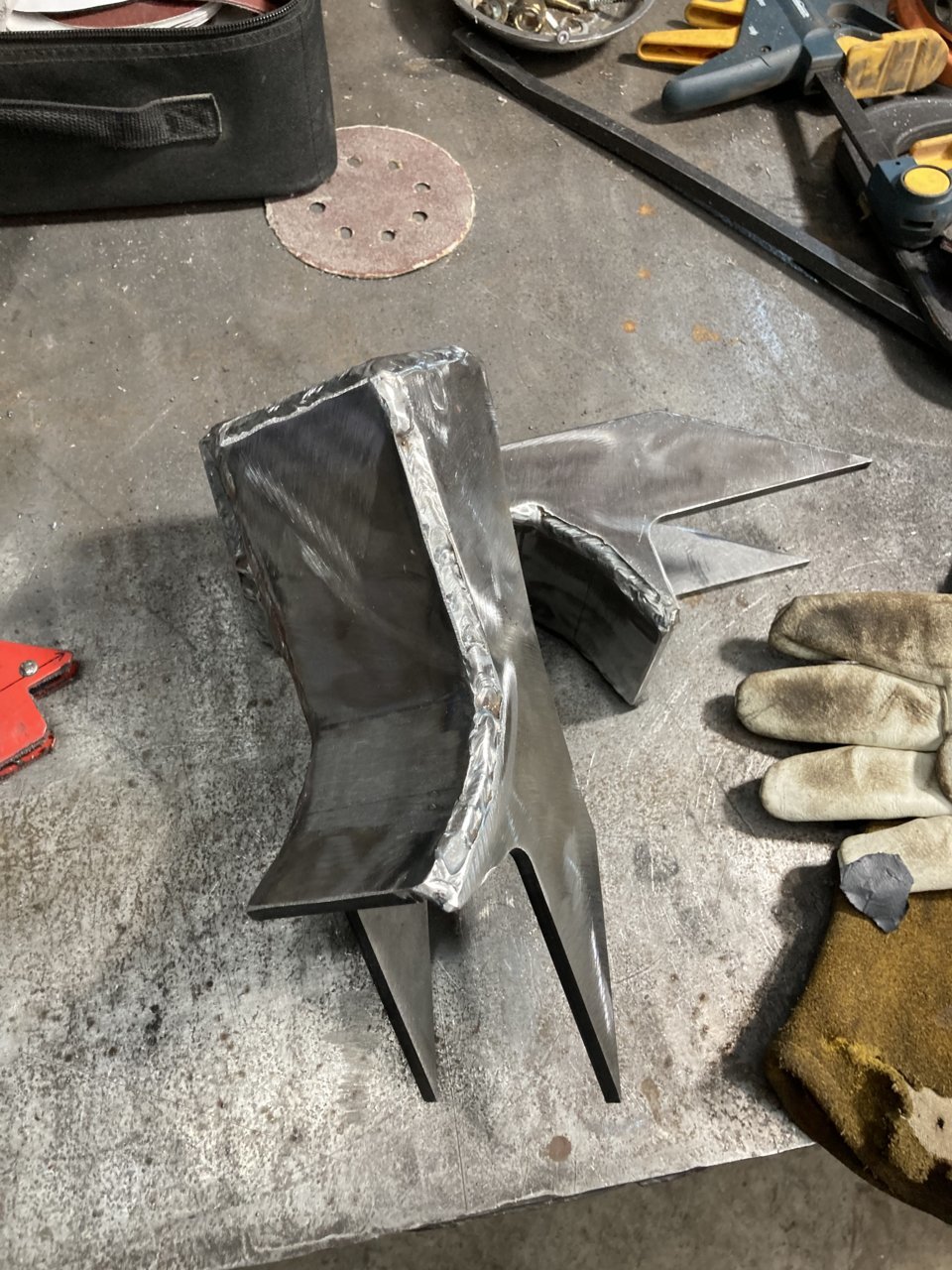

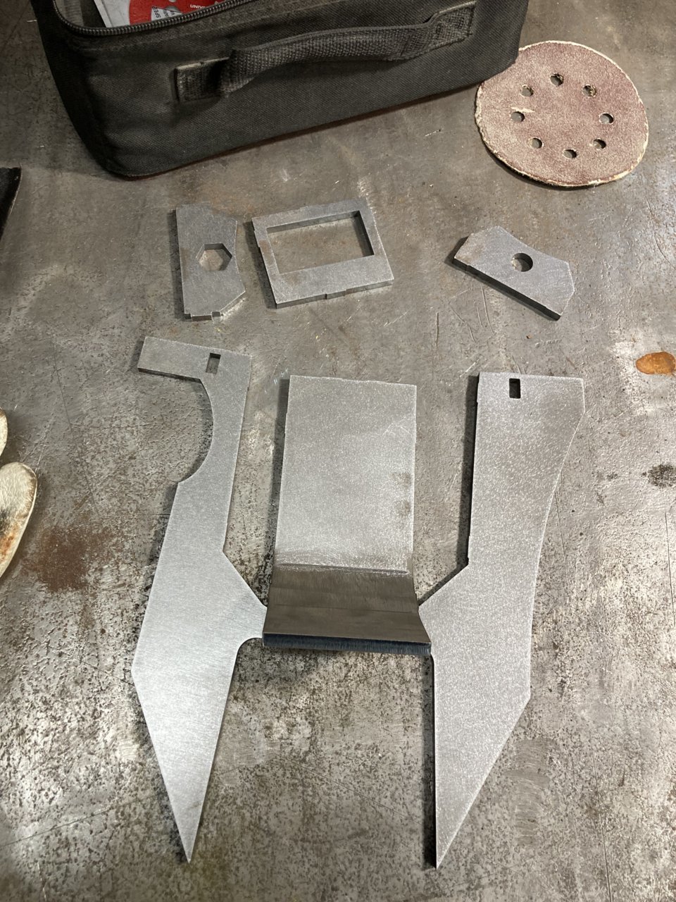

    Burned these up for another future project….figured less of a chance of loosing pieces if everything was together

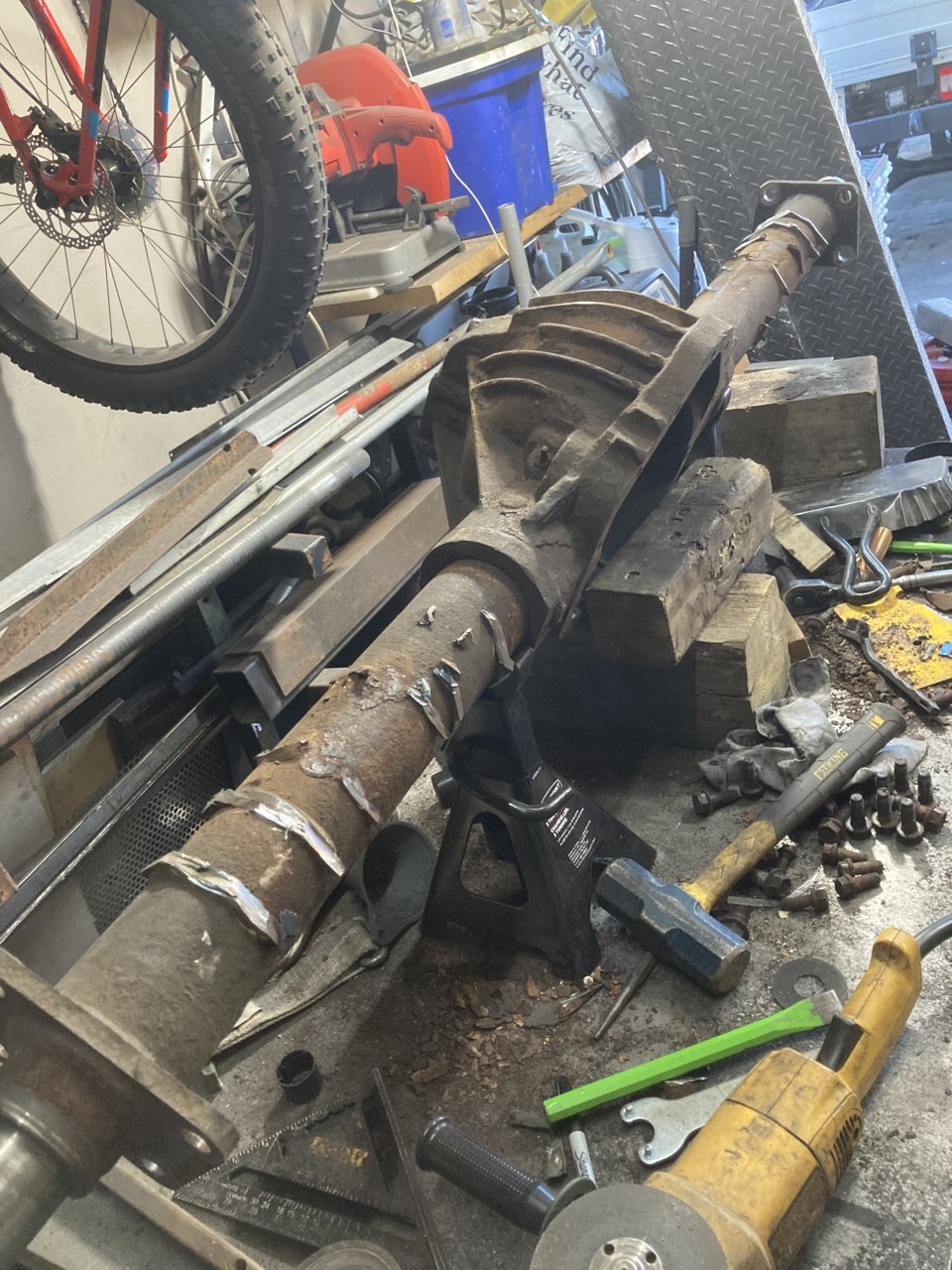

    Been just messing around in the garage.

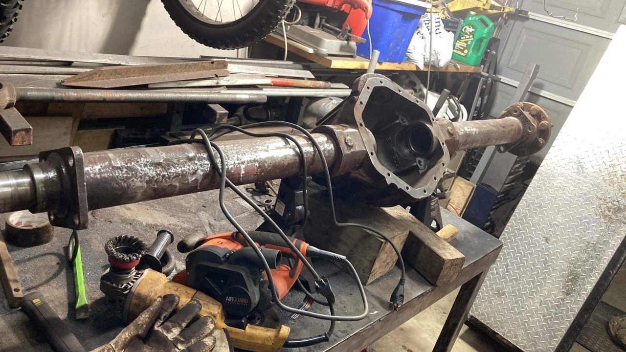

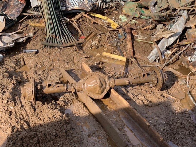

    I got this 14 bolt a while ago for $80 at the scrap yard. It has factory discs and I believe it is 68” wms to wms.
    C69FF047-DC9C-4E2E-8939-B6C6F4F72BBF.jpg B0A78F07-57CC-4829-BA46-EAA387B877C8.jpg
    I finally got it in the bench and stripped it down after it sitting in the garage for a year or so.
    EC3DE6A6-82DD-42A0-B2FF-20A9286CF025.jpg 0DDB3616-77B6-46AC-BD3B-35840C2175C4.jpg

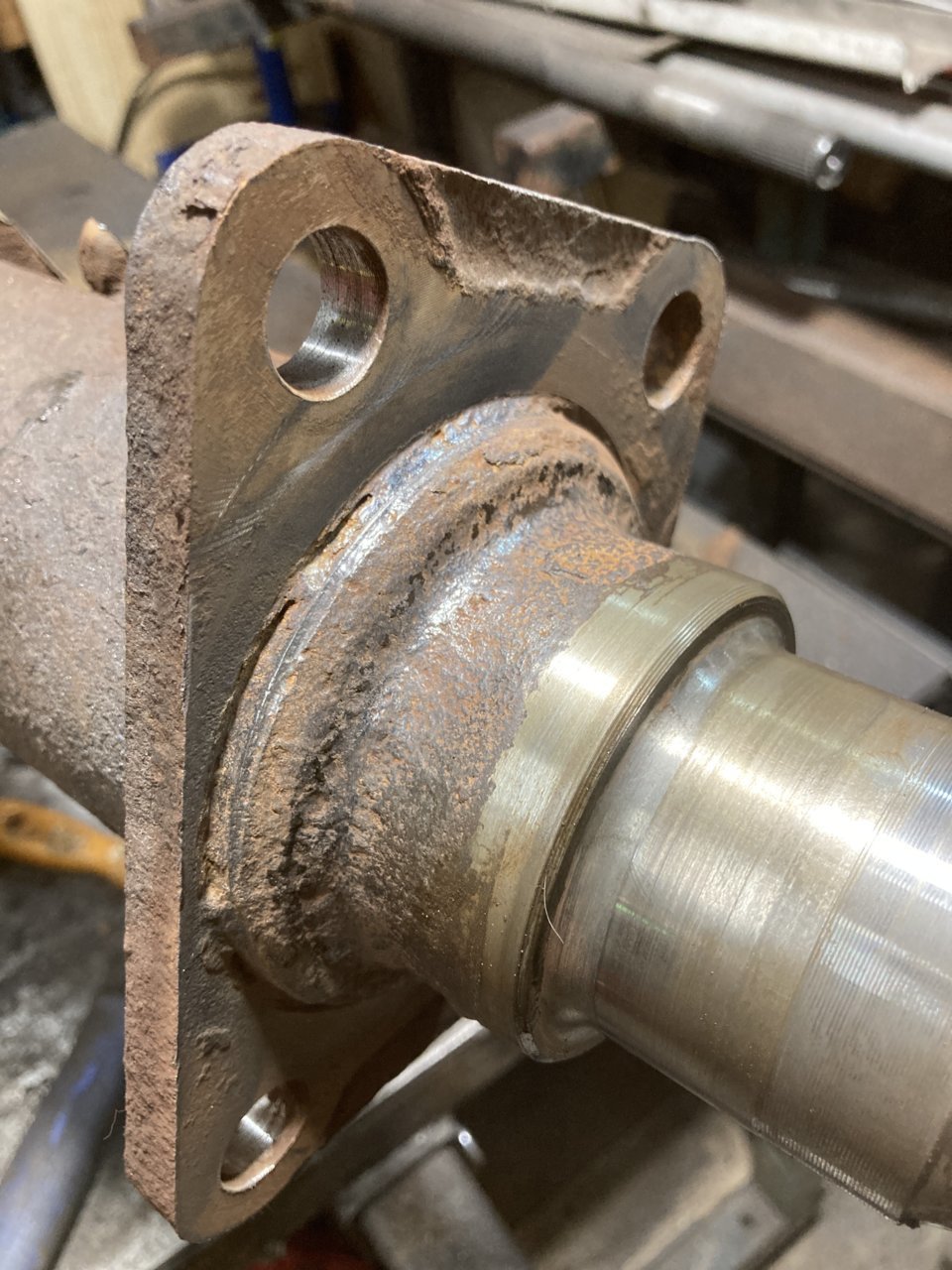

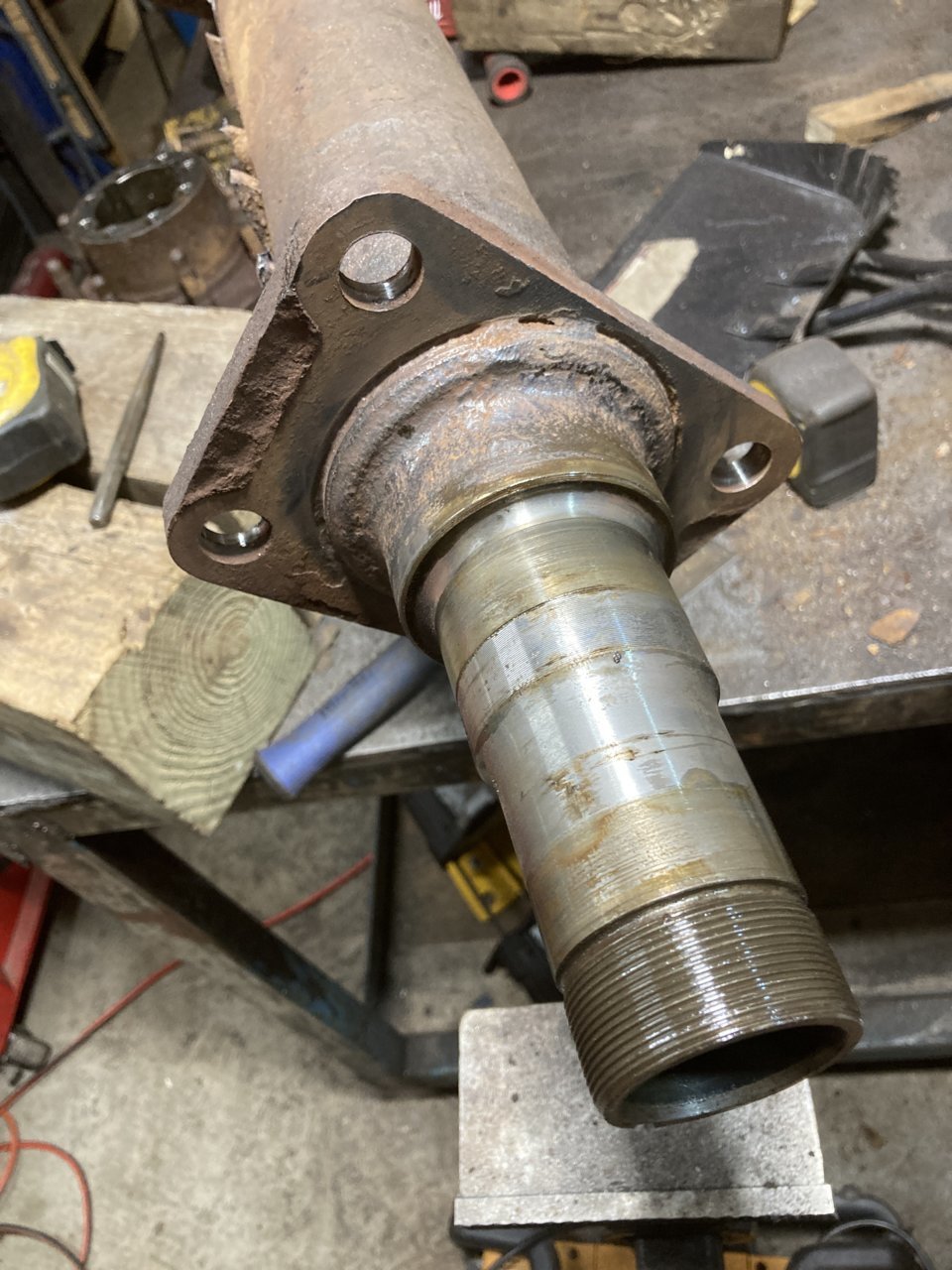

    The spindles on it look okay, but I’m not sure about this surface. Pretty sure this is for the disc brake bracket so it shouldn’t affect the hub seal but I’m not sure.
    535408E6-F012-40B2-8A59-10D9A26059D0.jpg 0A9D47AA-77C1-443E-9E7D-D73F7B945ECB.jpg
    The plan as of right now assuming this axle doesn’t need to be retubed is to shave it, gears and lockers (have to check either to run 5.13’s or 5.29’s with 37’s-40’s), and then I just need leaf springs perches as I have shock mounts already. I believe I’ll be sticking with factory brakes if I can (has a parking brake assembly which is nice).
    that’s it for now….slowly dragging this out as I figure out what I am doing.
