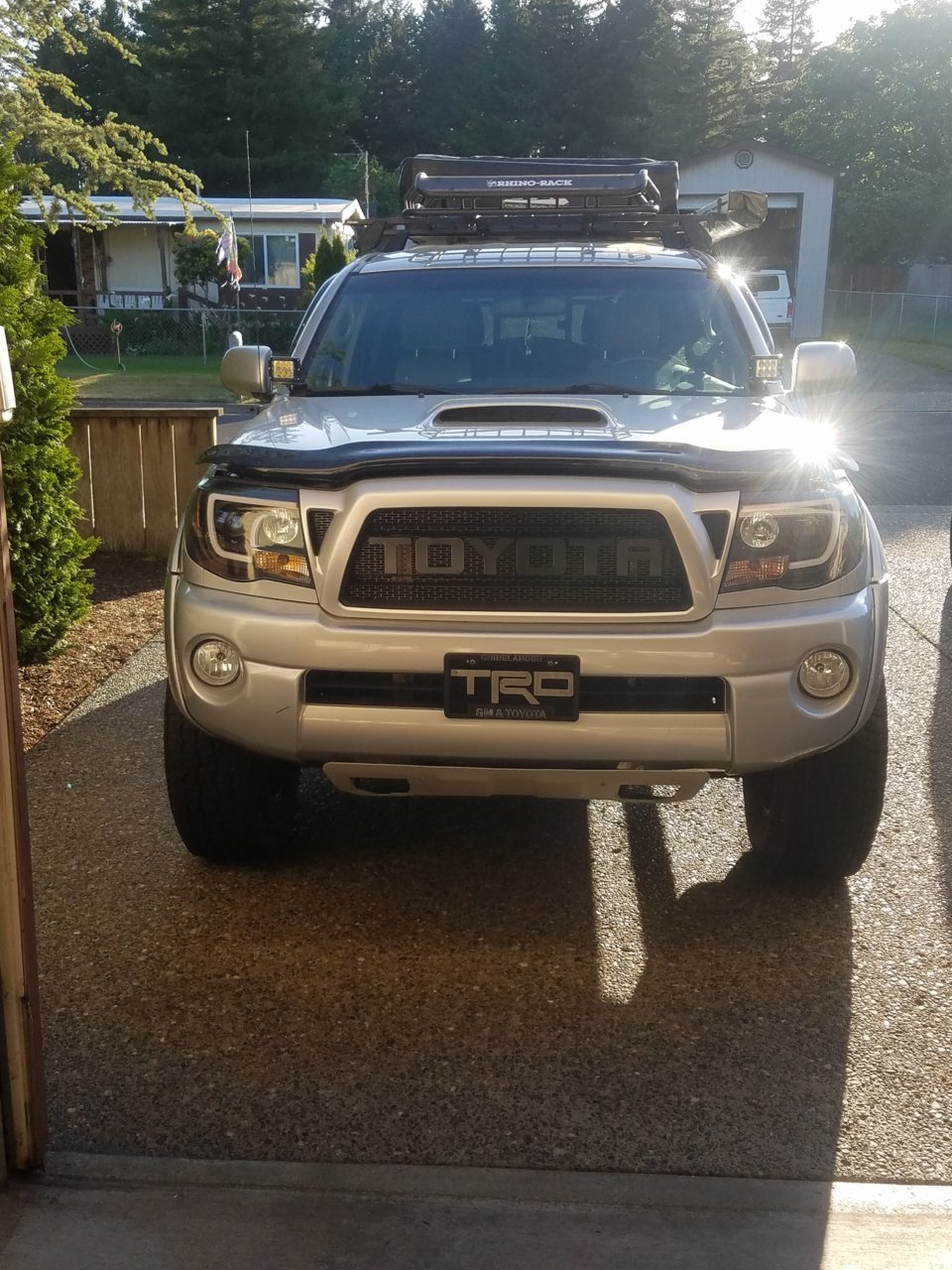

    Here you go
    20180526_192901.jpg 20180527_211928.jpg later that same night
    Benzdriver81, JAHGB2 and Steves104x4 like this.

    Great look. Thanks for sharing. Now I can see how the grill I want (or darn close) will look on a sport too! :thumbsup:

    Hey man. I just installed mine and really like em. I was looking at your pics and it almost appears as though you have side marker lights in. There are orange lens on the side, but I didn't put any bulbs in there. I just plugged the connector for the DRL into the side marker connector base that was swapped over from the original headlight housing (this is what the original side marker bulb would have plugged into). Maybe it's just the light from your DRL that makes it look as though they are lit up, or maybe you spliced the wires to both light up with the side marker wiring? If not, I missed doing something.
    Other than my questioning whether there should be a side marker bulb, I really love the look of these suckers. I definitely want to find some smaller profile fog lights to "blend in" better. I wish I could find some projector style fogs that have a black housing around them that were direct plug in and direct mount. So far, no luck. I was thinking of possibly buying the black fog light covers (inserts) for these models, and cutting the centers out to adapt some smaller projector fogs. We'll see. One fog lamp is cloudy, so they are getting replaced anyway. I just need to find the right style.
