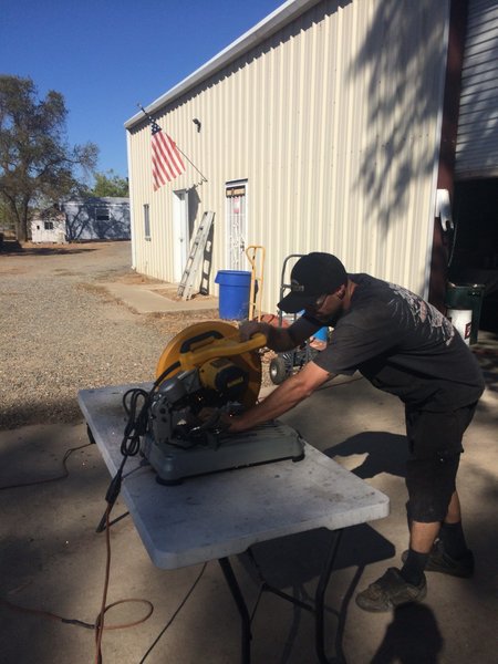

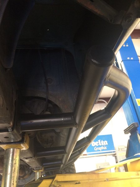

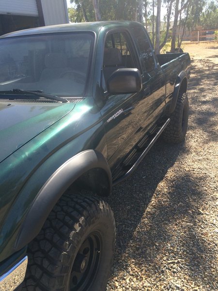

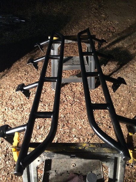

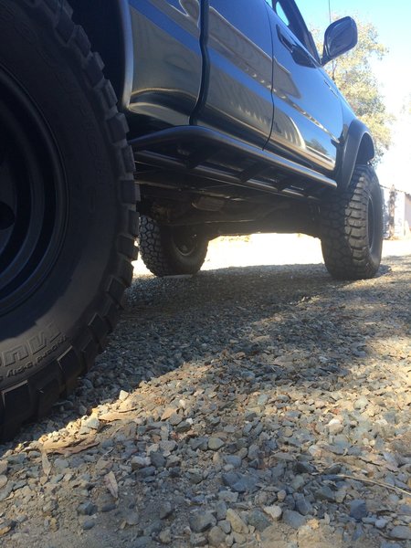

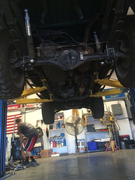

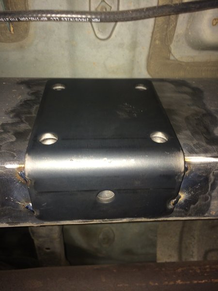

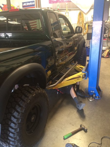

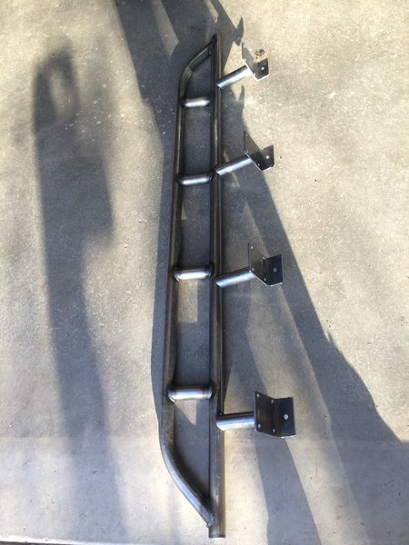

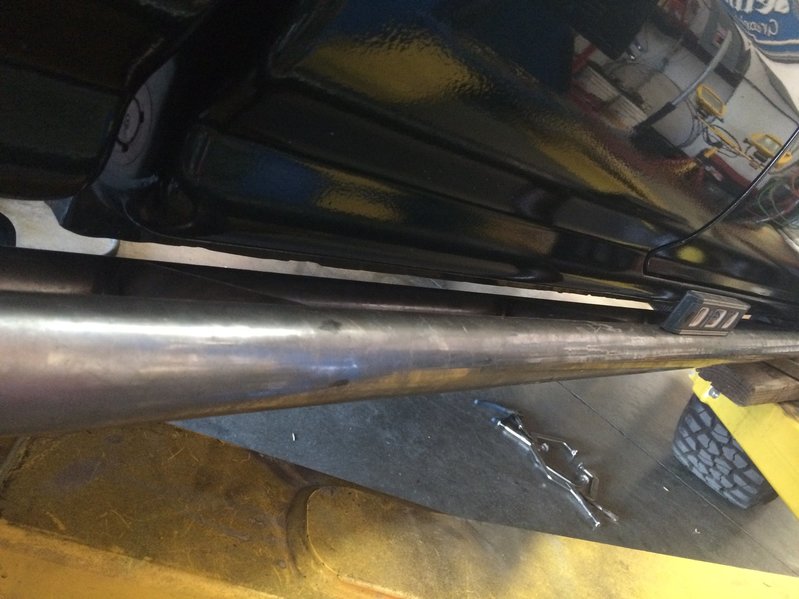

    First. Set them up with the lift and measured the cut for the leg length, then cut and deburred themimage.jpgimage.jpg image.jpg then measured for the mount brackets and tacked them on. The rear body mount gets in the way so had to move it forward and even out the mounts to that.image.jpgthen tack the legs to the mounts image.jpgafter that. Take the sliders and measure to where they need to go and the angle you want, and mark with a sharpie.image.jpgused the doors and frame to level. The level didn't do much. After that removed everything and my good friend that had this shop and races modified 350s welded everything up. He's also a professional welder. All around perfect welds. So this seemed cake easy for him.image.jpg then painted them up. Had to sand off the paint on the mount brackets because accidentally painted them before welding permanent to the frame.image.jpgthen lifted the truck up and welded onimage.jpg image.jpg image.jpg image.jpg
