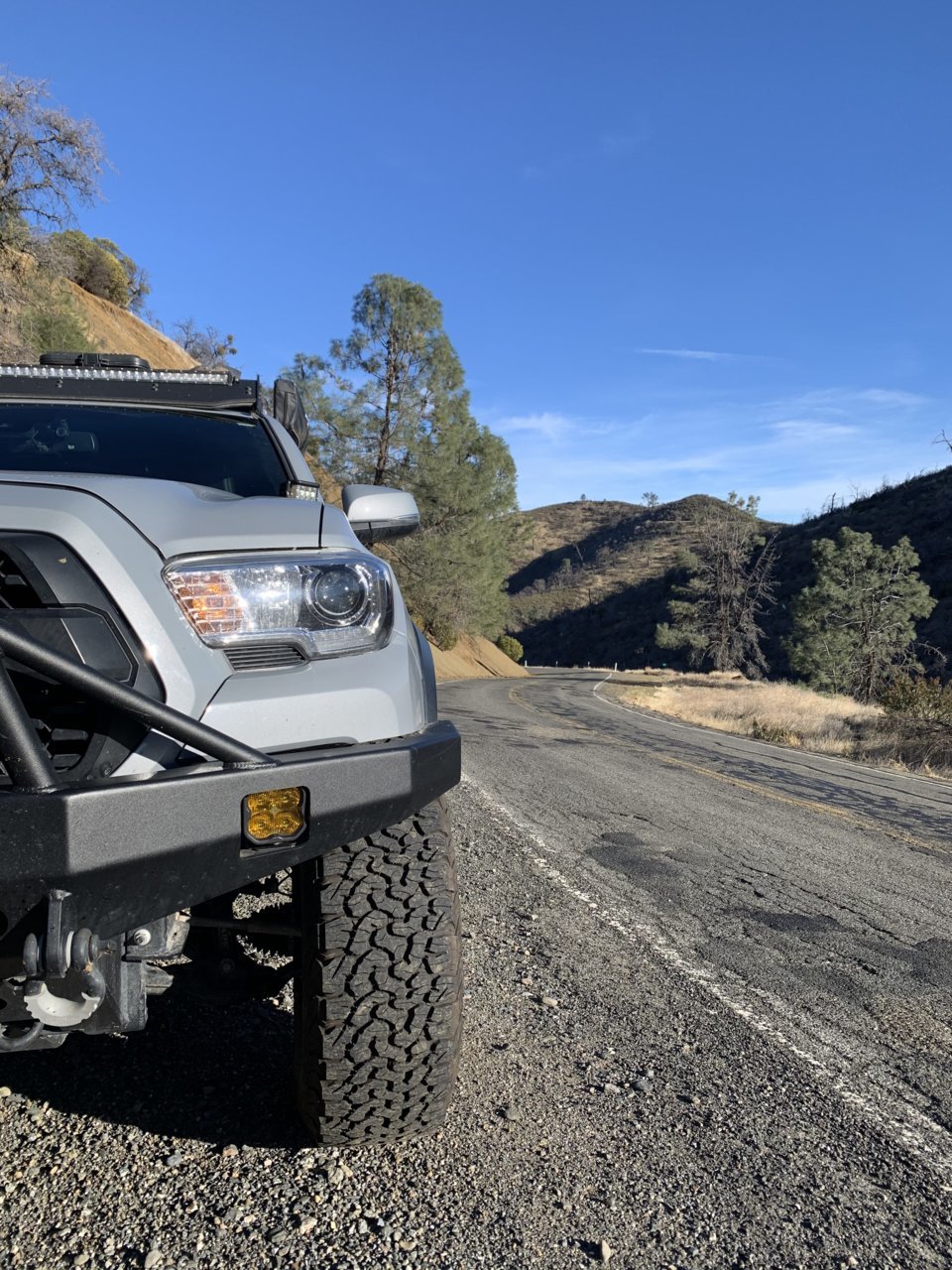

    A while back I switched my Caliraised amber light pods over to some Diode Dynamics Sport SAE fog lights. The Caliraised pods were good, but the pattern wasn't appropriate for use on road. These Diode Dynamic ones have a more road appropriate pattern and still project a lot of light. So far I really like them, thought I do wish they offered an amber version instead of yellow. I hooked them up using the Caliraised adapter pigtail so they're controlled by the factory fog light switch.

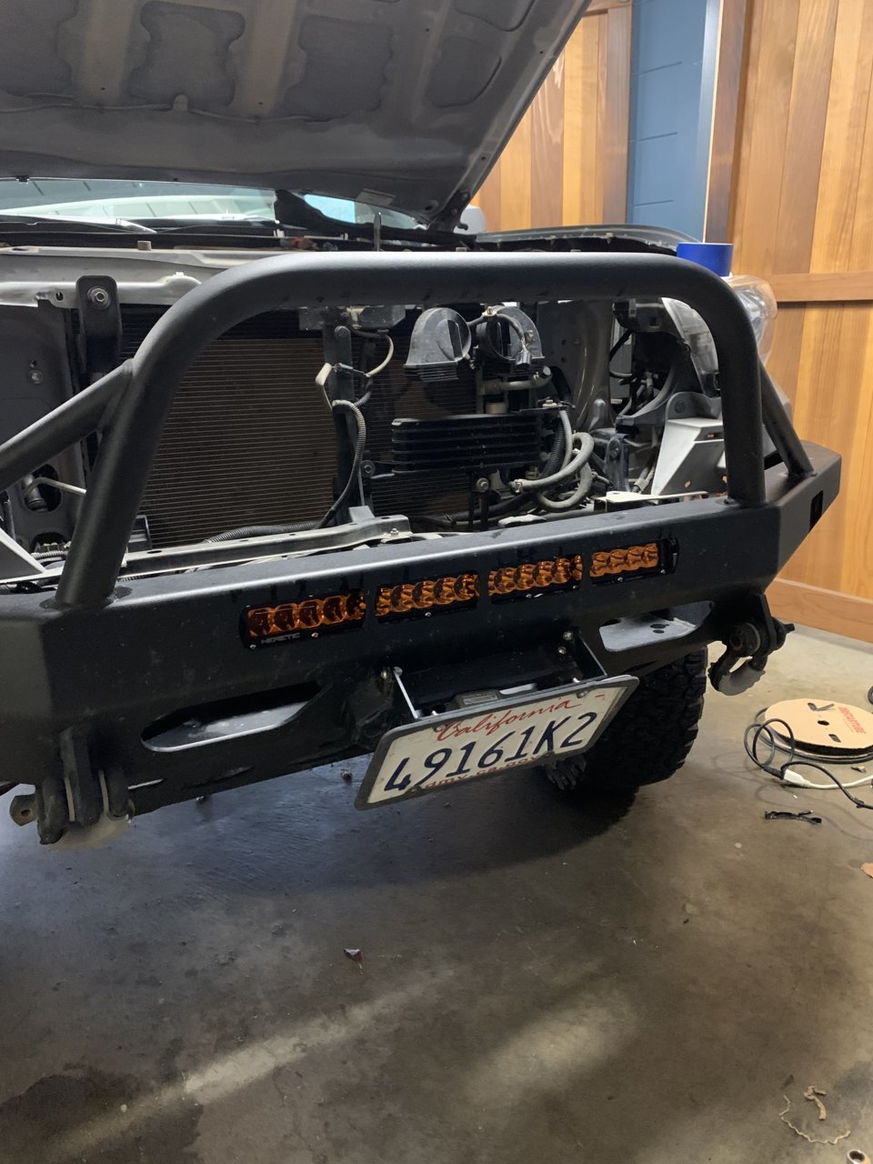

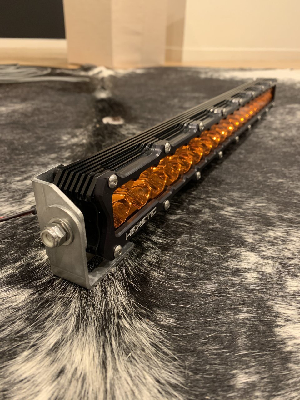

    I also picked up a Heretic Studies 20" amber light bar. A few things drove me to them. First, I really wanted an amber light bar down low to cut through dust. Second, the light bar cut out in my bumper is around 22" and a lot of the other 20" light bars would have left a gap on either side. Finally, the price for the quality seemed to be right on. I can't speak to how it compares to BD or Rigid, but price wise it makes way more sense, and build quality seems top notch. All in all, I'm totally pleased with it. Install was relatively straight forward. I've got it wired up to the same switch as my rooftop light bar for now since I'm out of open switch spot. I haven't gotten a chance to really use it yet unfortunately. Somehow I've had my shit well enough together that I haven't been rolling into camp after dark lately!

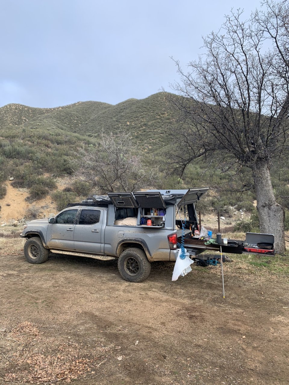

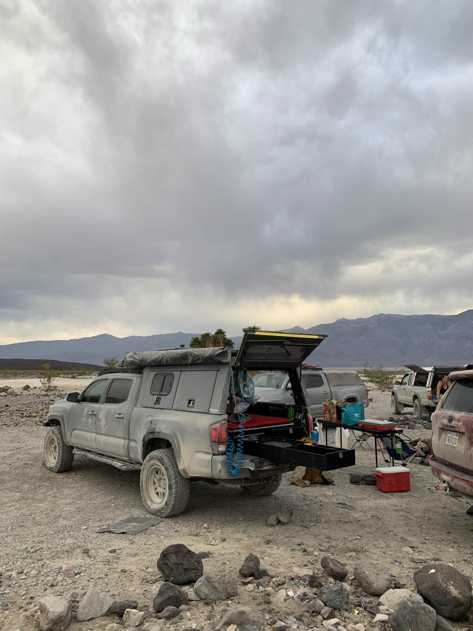

    And some more pics from some weekend adventures.

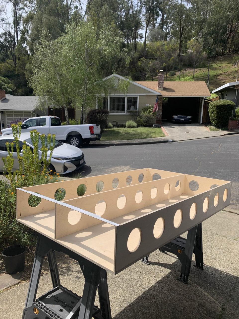

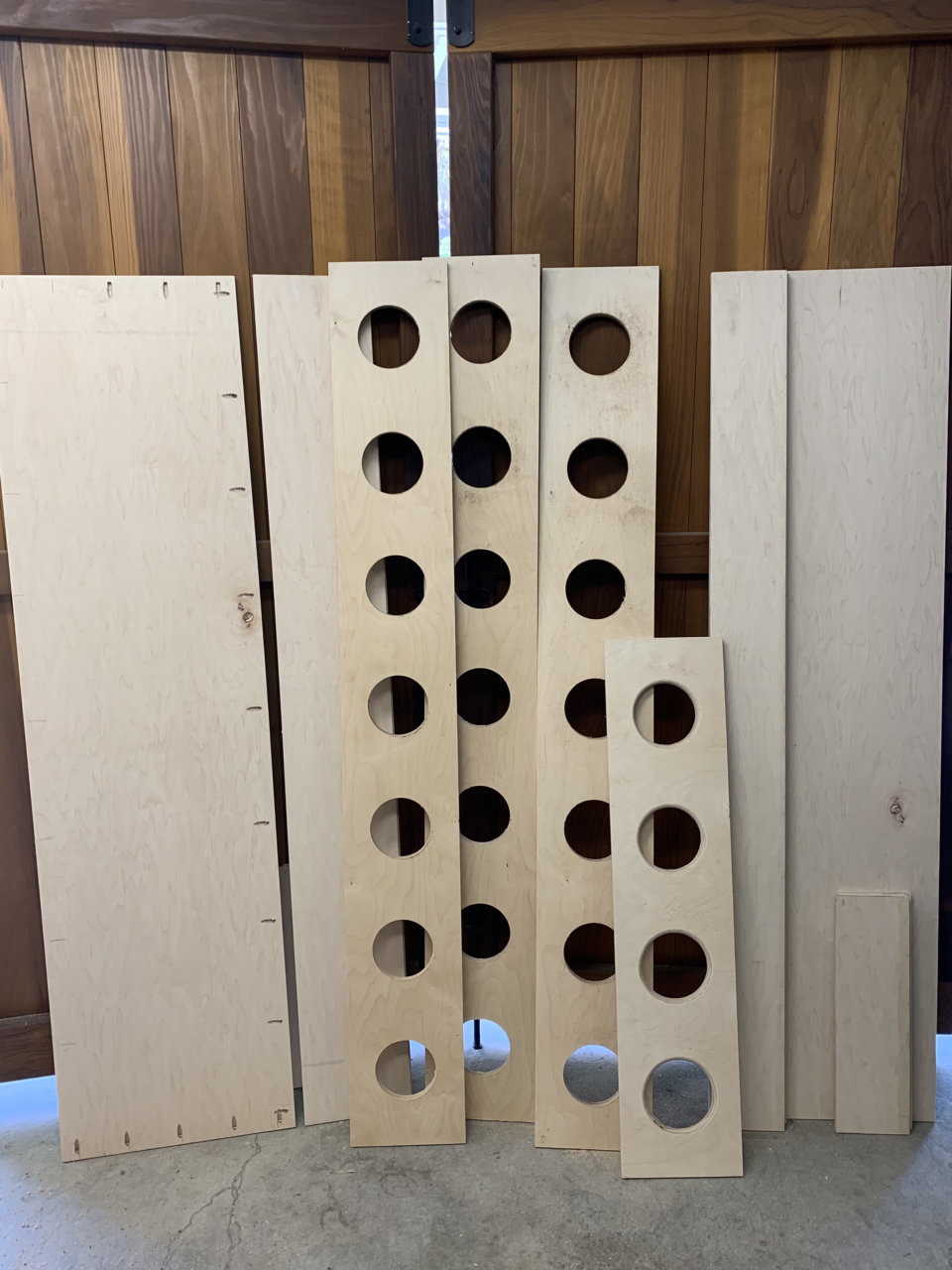

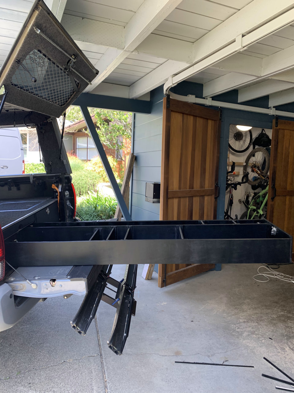

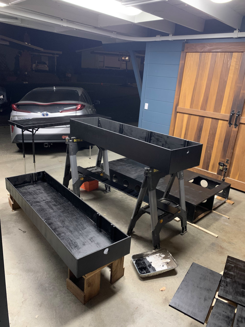

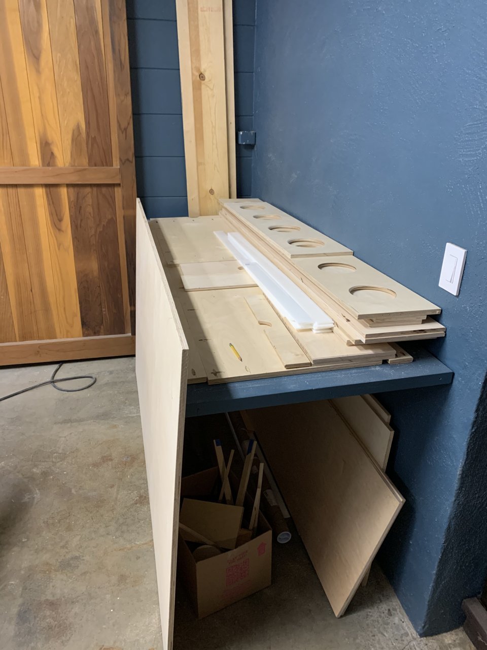

    Started on drawer build 2.0. Most everything is cut and drilled. Just need to glue, screw, and finish. I thought zipping 5” holes with a hole saw would be fairly quick and easy. Man was I wrong.
    E4ECCE99-334D-4D28-9CCA-3EEF5103A3A3.jpg DFDBD28D-8D28-4F51-B7DA-D7E36D03E9D7.jpg

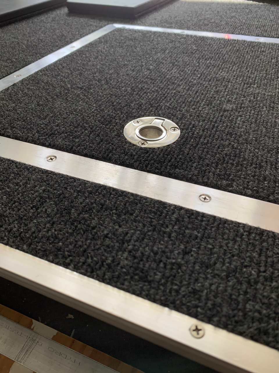

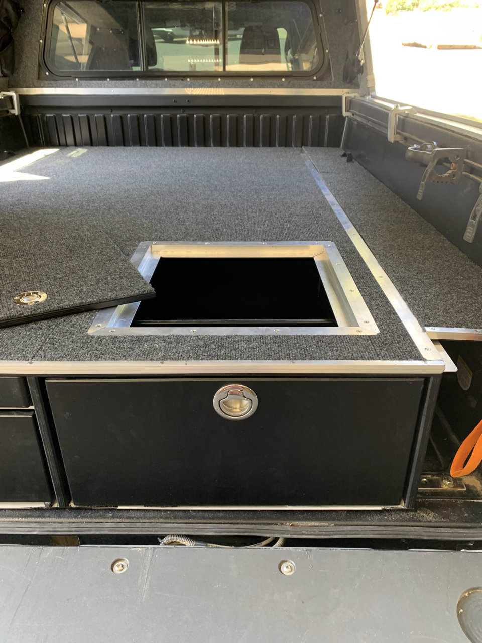

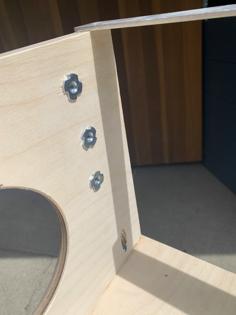

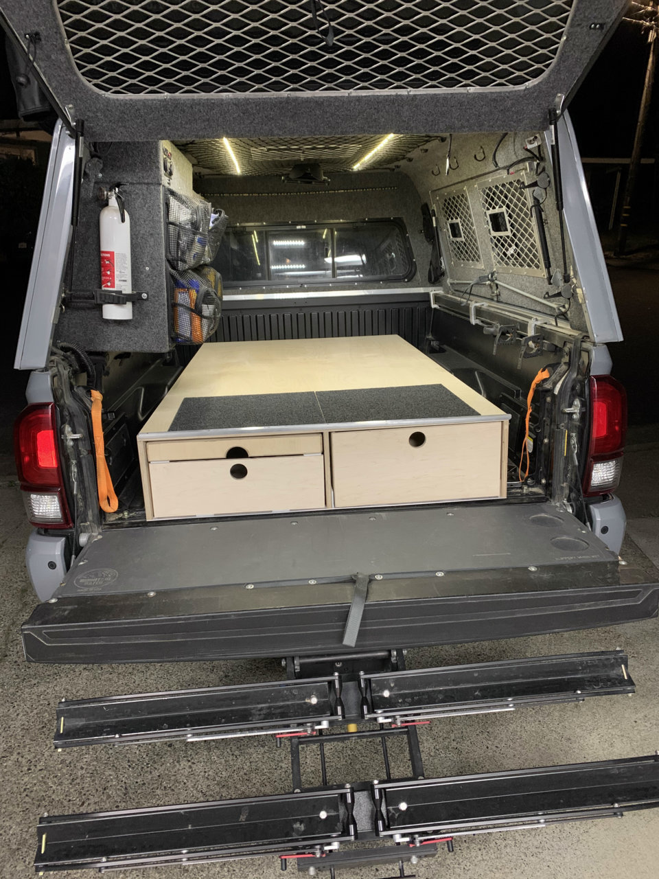

    Guess I never updated this with my finished platform.

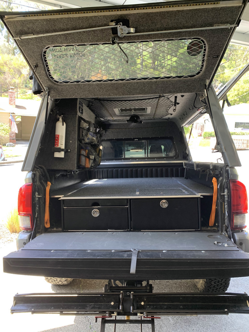

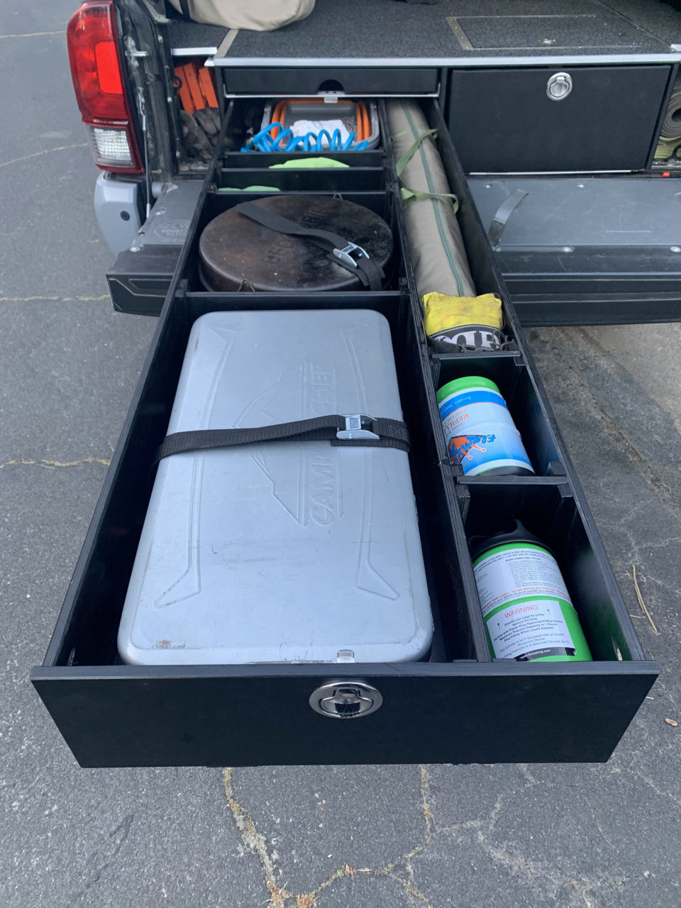

    What a friggin marathon that was! Overall I'm really happy with how it came out. Lots of test fitting and figuring as it came together. I didn't have a game plan as far as organization when I started but decided to go ahead and build in organization dividers into the drawers. Everything has a home. All the dividers are removable so if I ever need to just have big open drawers it's no big deal.

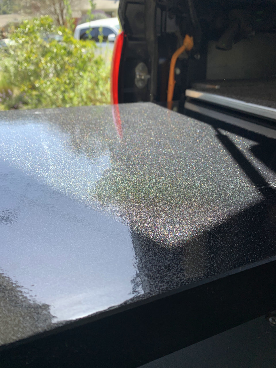

    I ended up staining everything with a black poly-urethane stain. I was really torn about doing this because I'd put so much work into keeping all the corners tight and flush, and I feel like the black just hides all the detail work. In the end, I opted for function. Camping is dirty business and black does better at hiding dirt and grime. But god damn there was a lot to stain!

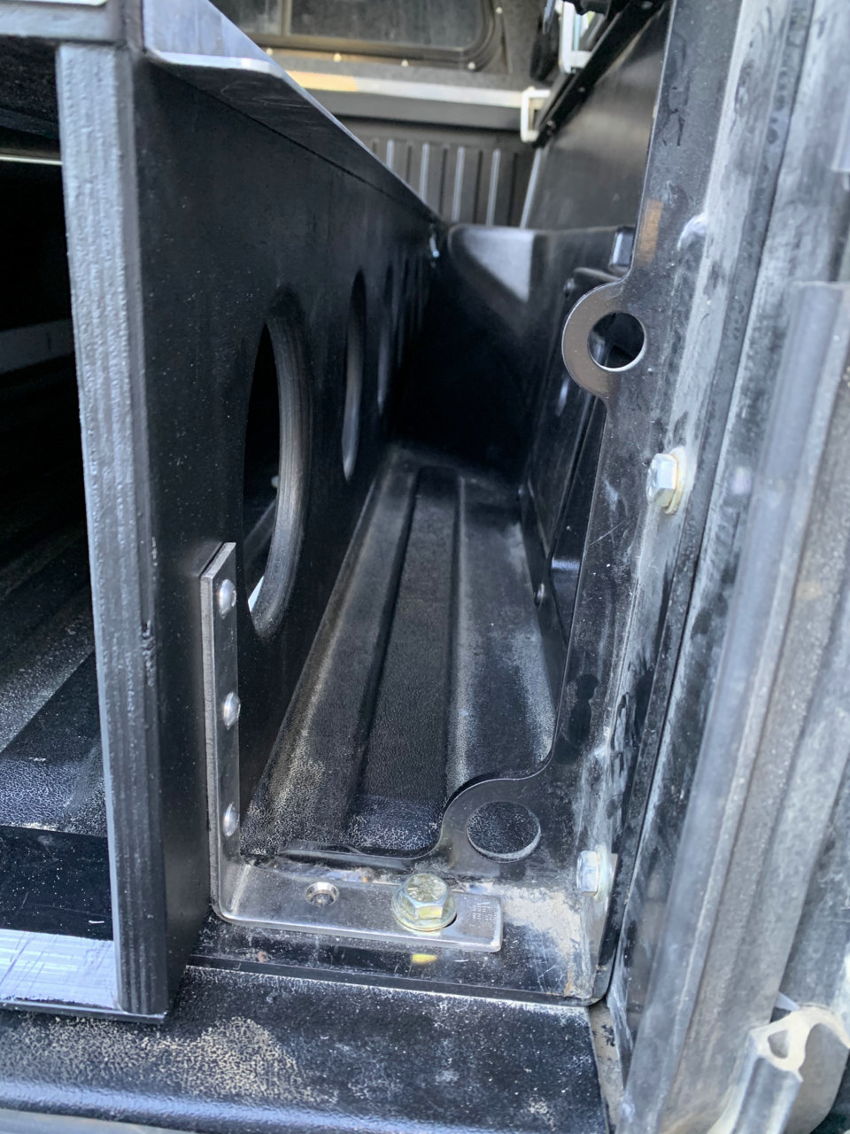

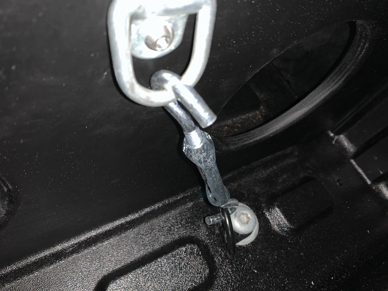

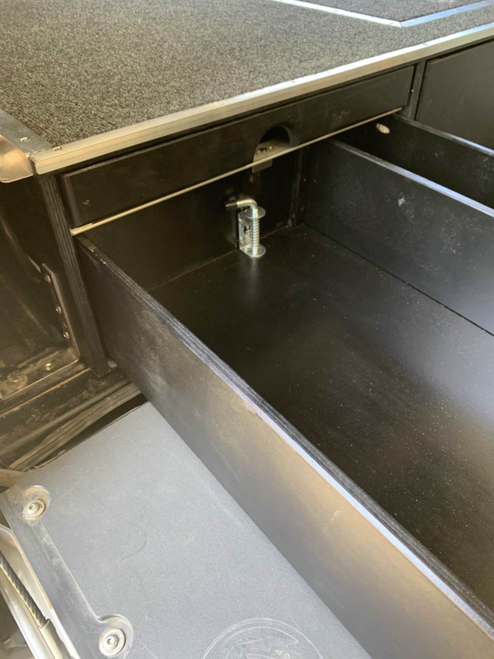

    I changed up how I secured the drawers a little bit too from last time. I used some 1/4"-20 T-nuts inserted into the plywood which I totally love, and then modified a SST bracket for the front to secure it to the tie-down bolt up front. In the rear, I used the OEM tiedown loops from the front and put them between the bed bolts and washers, then used a turnbuckle to hold it down. This seems to work a bit better than my brackets before and having the T-nuts and some button head hardware keeps from having too many sharp things to catch your shirt sleeves and skin on.

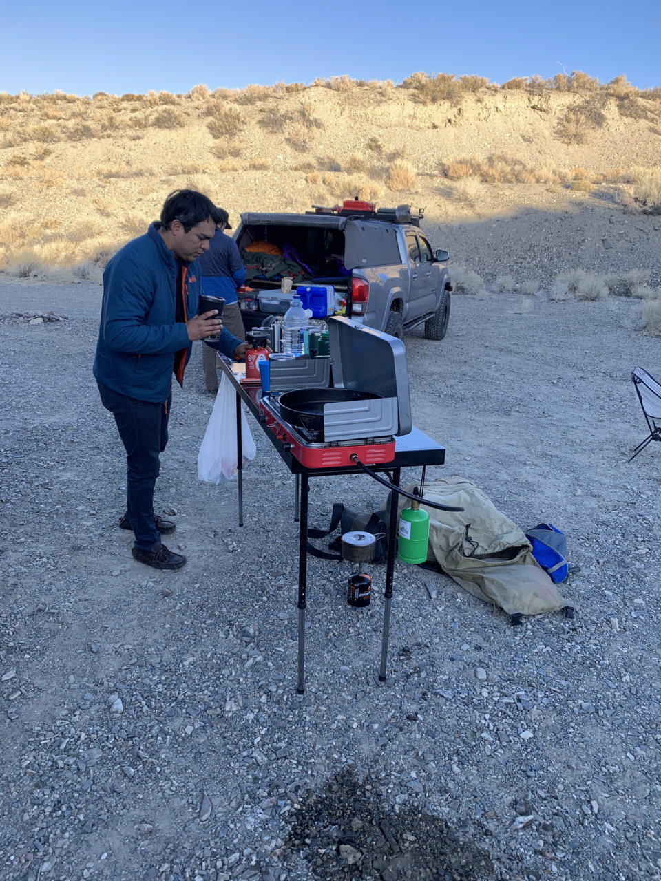

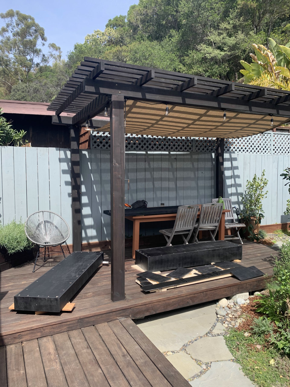

    The table is an absolute game changer. It's pretty amazing how as soon as you set up a bar-height table at camp it instantly becomes a gathering spot. It can also be used as a shelf/table just extended from the platform. I covered it in some vinyl countertop material which is okay, but it's already proving to not be as durable as I hoped. I may have to find a more durable laminate to use down the road.

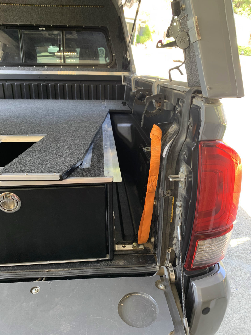

    I've got a couple tweaks to do to get the drawers to slide as smoothly as I want them to, namely I think I need to get rid of the Mountain Hatch tailgate panel because it sits up about 3/16" higher than the stock panel and so the drawers have a bit of an interference when they slide out. I ended up chamfering the front lip with a hand router but it still just isn't as smooth as it should be. The drawers are all out of 1/2" ply which is more than adequate for the weight. No problems or concerns extending them out all the way since they are supported by the tailgate and limited by a latch that catches on the aluminum strap on the bottom of the platform.
    IMG_2120.HEIC.jpg IMG_2148.HEIC.jpg IMG_2121.HEIC.jpg IMG_2123.HEIC.jpg IMG_2124.HEIC.jpg
    I ended up using peal and stick carpet tiles from Wayfair to cover it. They're pretty cheap and I can replace individual pieces if necessary. For the parts covered in trim, they're well protected. For the exposed edges on the side panels and hatch I stapled them down in addition to the adhesive backing. We'll see how they hold up but so far so good. Speaking of... more about the quick access hatch. I always found it a bit annoying to have to open up the tailgate and pull out the drawers to just grab a jacket or my flip flops. The side panels also just lift off like before, but using the aluminum Z-channel really maximizes the openings and makes it even easier to get stuff in and out.

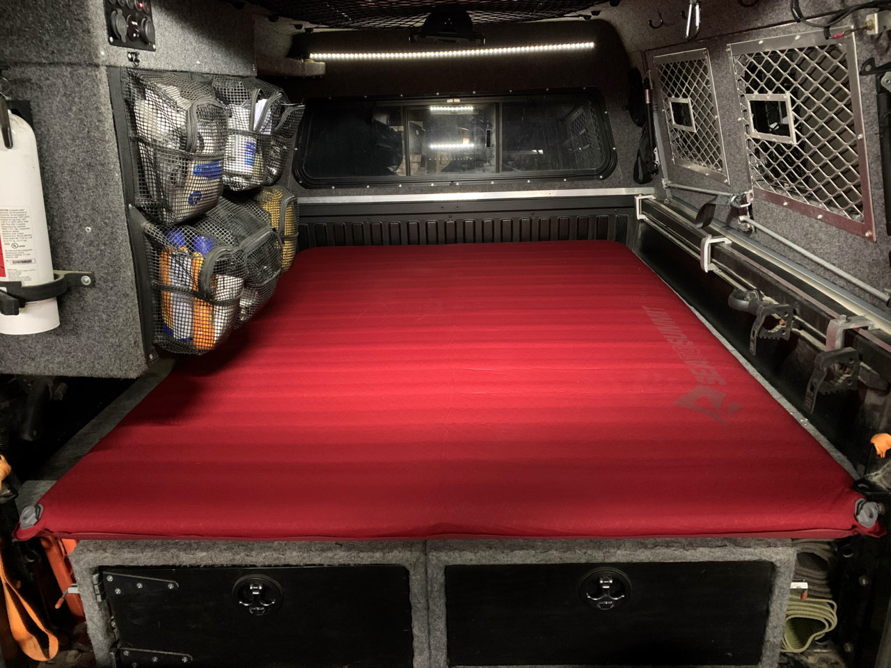

    The last change to my setup is I replaced the memory foam mattress with a Sea to Summit self expanding air pad. It always bothered me having so much of my bed occupied by the mattress when we didn't need it. This pad is super comfortable and fits perfectly. It's about an inch narrower than the memory foam mattress but still plenty wide and unlike some of the other pads it's only 72" long. https://seatosummitusa.com/collections/sleeping-pads/products/comfort-plus-si-mat
