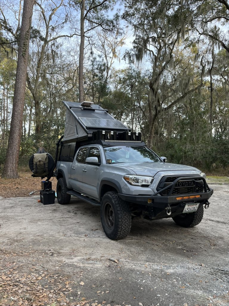

    Well it's been a hot minute since I've updated this.
    We got back on May 1, 2024 from our Wonderquest. Almost 9 months on the road, 27 states, 2 countries, and a ton of National Parks, Monuments, Forests, Historic Sites, and just flat out cool stuff. We pinched ourselves probably daily, asking if this was real. It was an incredible experience, and we are truly fortunate to have had the opportunity.
    We started our trip with a 3 week trip up to the PNW. We spent time with family near Bend and Seattle, before exploring the southern tip of Vancouver Island, then jamming down the coast back home. We learned a lot on the trip about how we want to travel, what we needed to prepare for, and what was important to us. The biggest thing we learned was that we needed to give ourselves more time, and limit how much we drive in a day. We decided to adopt my parents' 3/3/3 rule: 3 days at each spot, 3 hour drive between spots, and arrive by 3 pm.
    It was a great shake down test with fortunately few surprises and changes that we felt we needed to make before starting the big trip. So at the beginning of September, we finalized our setup, finished getting our house ready to Air BnB, then headed out on the grand adventure.
    I did my best to document our trip on our Instagram page, though I still owe some final updates. In total we drove about 17,000 miles, including a massive back-track from Az to Tx for the eclipse. We excountered all different types of weather: wind, rain, snow, heat. There were some low points, and lots of highs. We spent about 80% of our time camping in our truck, and peppered in some Air BnB's in some cities we wanted to explore, or stayed with friends and family in various places all over the country.
    We started off in Yosemite, camping on the north side of the park with my folks, before heading across the Sierras into Nevada and eventually Great Basin NP. This park is a real gem, highly recommended!

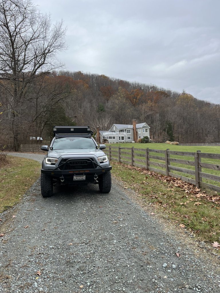

    Up into Kentucky for a few nights exploring Mammoth Caves NP, and a quick stop in Louisville for some bourbon before staying with some friends outside of Indy.
    IMG_1581.jpg IMG_3795.jpg IMG_1536.jpg IMG_3790.jpg IMG_3803.jpg IMG_6030.jpg
    We shot across Ohio and stayed at Hocking Hills SP, which was actually quite cool. Then we headed into West Virginia, which was my other surprise favorite state of the trip. Rugged, expansive, and a bit wild. New River Gorge NP was really cool to experience, but probably 1,000x better in the summer. It was mid November and getting cold, so we booked a cabin for a few nights in Black Water Falls SP while we explored Dolly Sods Wilderness.
