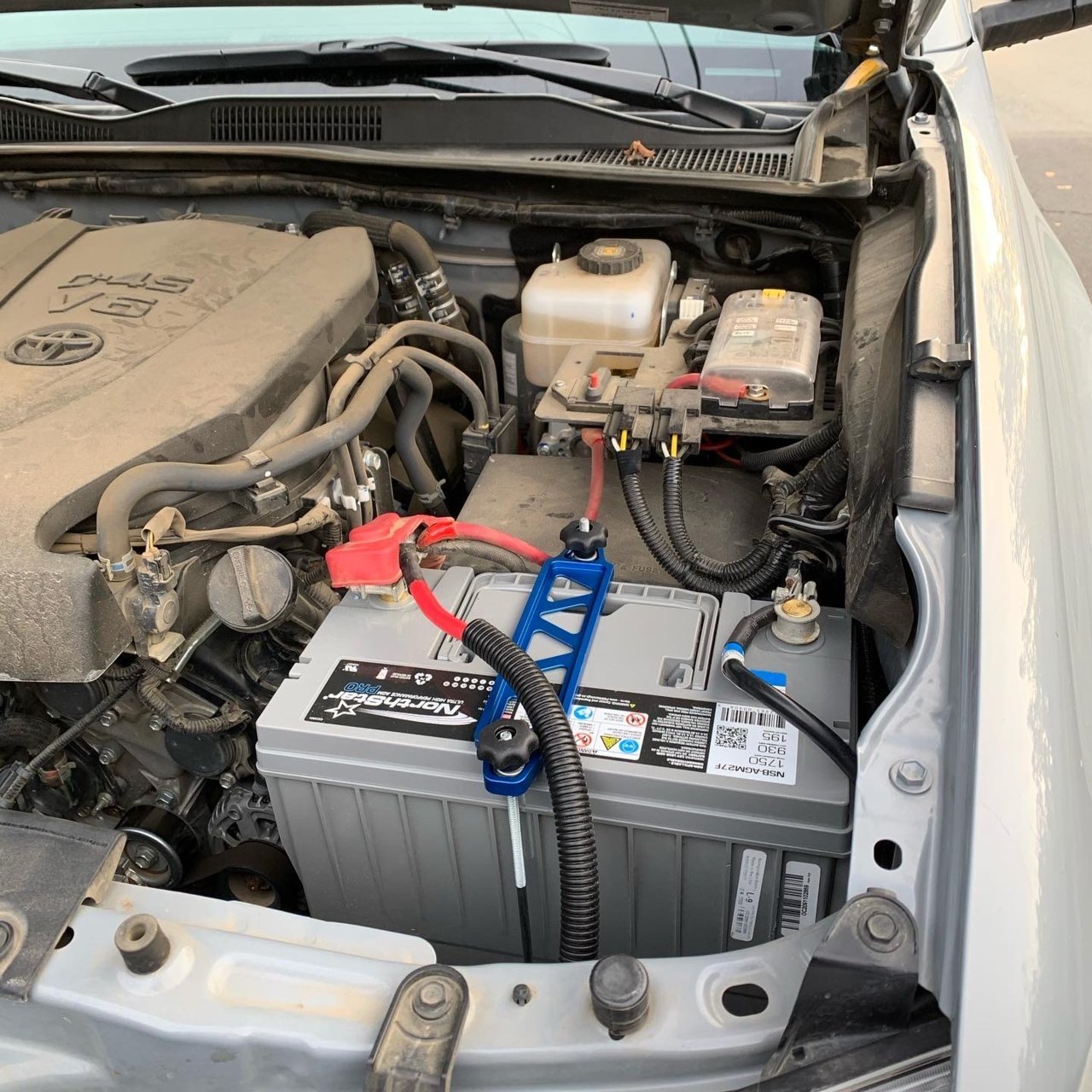

    Jeeez, spoiler alert! :rofl:
    Yeah I got the Northstar installed.
    I'm planning on doing the same thing as you. I picked up a NOCO genius G7200 to top off the battery when needed.

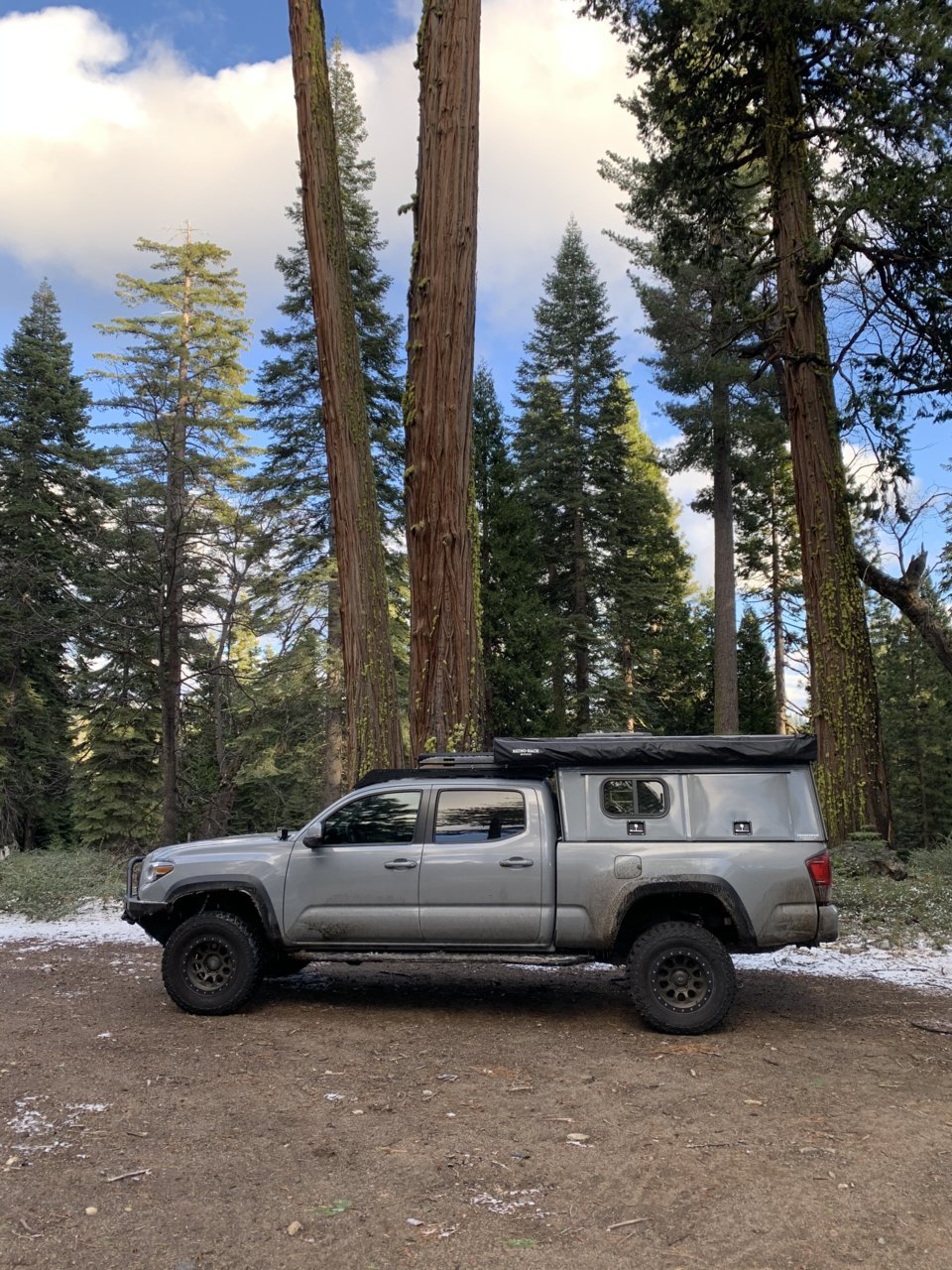

    keep coming back to your build page to just look at the ADS suspension, I have not yet installed mine. Need to get around to it but the snow has been to good to not go to the mountains. Anyways, How are they? Impressions after having them on for a while now? Had to adjust them much?

    You’re going to love them. I unfortunately haven’t had a chance to really take them off road yet. Hoping to remedy that next month. I lowered them down a little from my initial settings to get me at about a 2 5/8” lift up front. I haven’t done much with the compression adjusters yet because I have liked how it rides. I’ve got it set in the middle right now. My only complaint right now is I think my UCA are maxing out pretty easily. I rode in my buddy's truck with a Fox setup and the same amount of lift but a uniball UCA and his doesn’t seem to top out at all. Who knows.....

    After doing a bit more digging in the ADS thread I'm pretty convinced I'm actually feeling my coilovers topping out. It's pretty rare, just when I'm dropping off a ledge or mobbing over speed humps. Going to do a bit of digging this weekend but I should have about 3" of down travel so I'm kind of surprised they are topping out. Apparently they have been working on a topout softener so it's less abrupt but I'm not sure when they are going to put that in the 2.5's. They also said that topping them out doesn't hurt anything which definitely makes me feel better about it, but I don't love how it feels. Hopefully by the time they're due for a rebuild they can add those on to mine. Either way, you're going to love your setup!

    Confirmed today that it was my coilovers topping out. The UCA still have more room to go. I had 1 7/8" of down travel and so I dialed my coilovers down a few turns and that seems to have resolved my topping out issue. Now to wait and see if I need to take a leaf spring out of my pack to get the height right...

    I’m at 3/4” of threads on passenger and 1 1/4” driver to compensate for the lean. That’s on 700#x14” springs.
