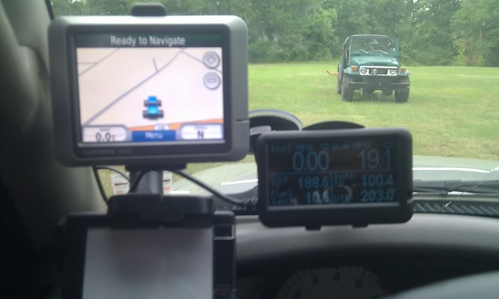

    that average wasn't really my average. It was after driving about ten miles of backroads.
    After studying different driving settings with the ultragauge my mpg in each setting are like this:
    backroads ~45mph ~19mpg
    interstate~75mph ~18mpg
    highways ~55mph ~22mpg
    city stop and go~14mpg
    backroads pulling mower trailer ~13mpg
    So a total average of around 17mpg so far. I think I can change my city average some, but the others I'm not sure about.

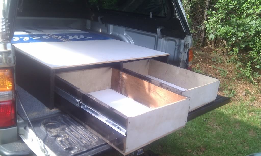

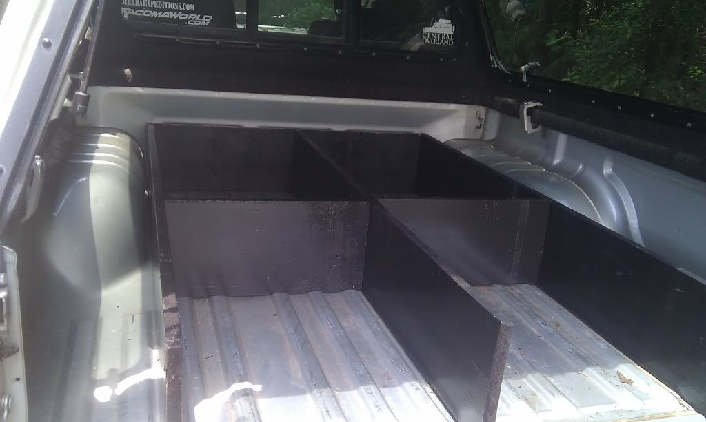

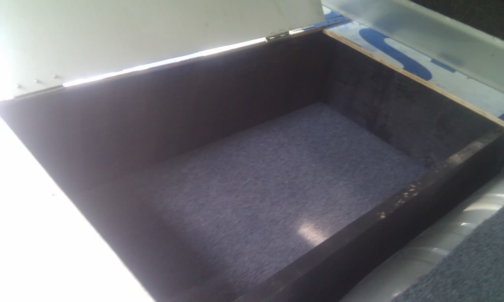

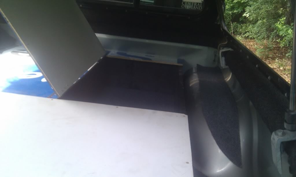

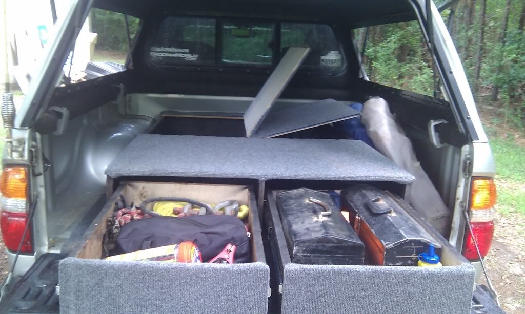

    I started working today on my sleeping platform/drawer storage system in the bed of my truck. All the wood I used was stuff laying around our sheds. So if I begin to use this and see it would better suit me designed a different way, I can use the same hardware and not out money for the lumber.

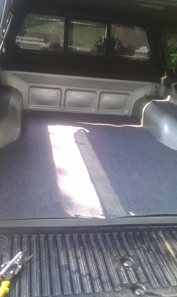

    started with carpet on the floor for protection, since tires used up my spray-in-liner budget.
    The frame is made out of 1x10s. I sprayed it black to help with looks.
    The rest is made out of plyboard. I think it's 1/2" plyboard. 24" drawers in the front. hinged doors next to the cab.
    I now need to carpet what is not black. But that will be for another day. I also plan on an addition to make the platform long enough to sleep on if the occasion occurred.

    Nice work.

    Thanks guys

    Looks good!

    looks great!

    Great deal and nice paint on the shell

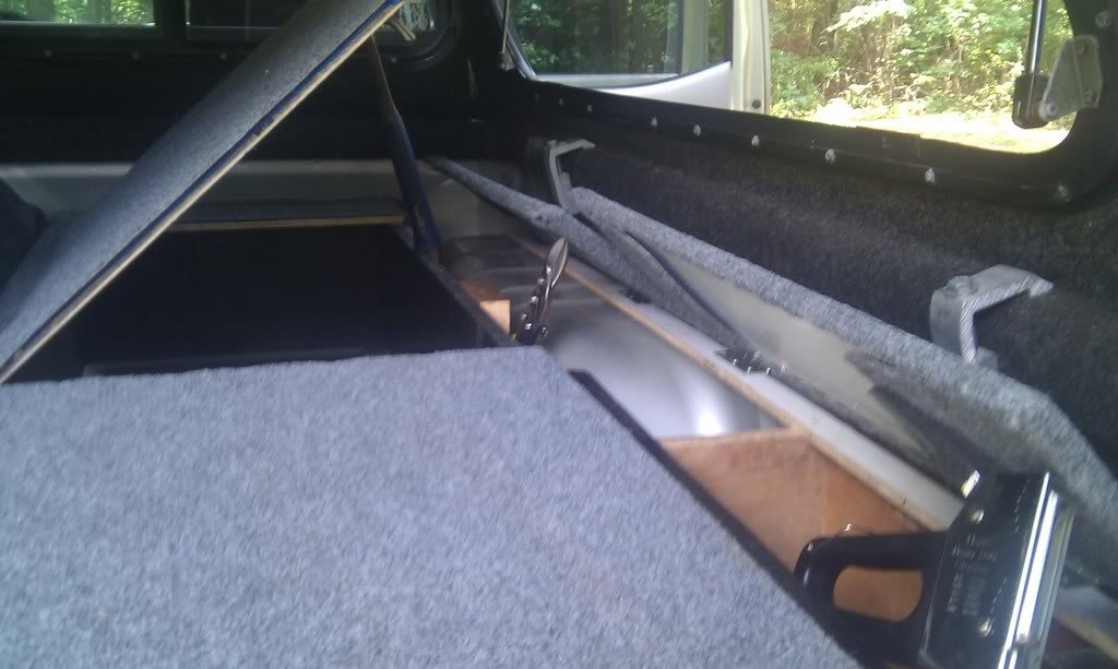

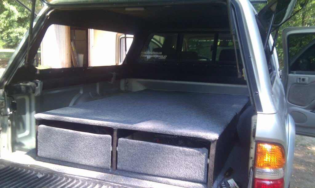

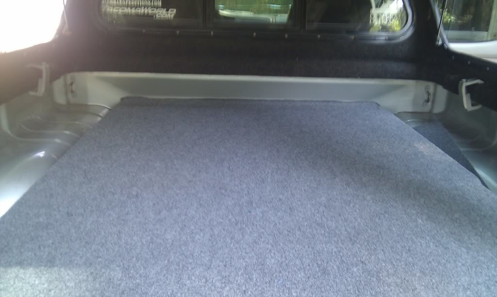

    Finished up the carpeting

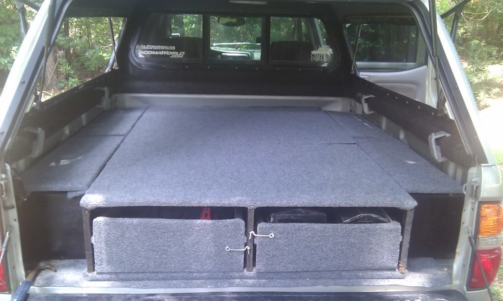

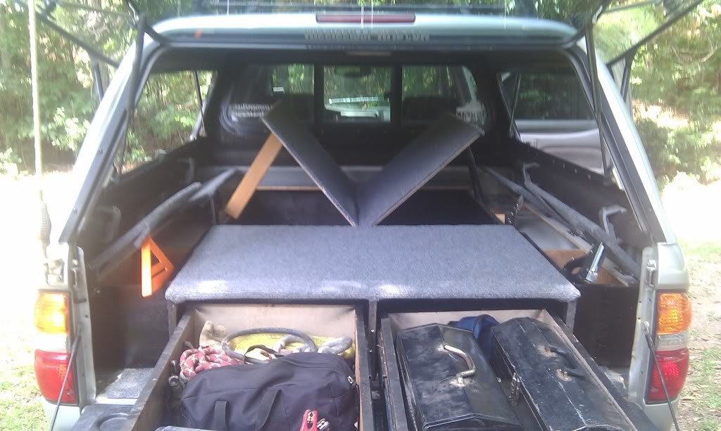

    Finished up the sides.
    Everything can be taken out if I need the extra space in my bed. It can all be done by myself within about ten minutes or less. With an extra hand I can take the shell off as well.

    wow that looks awesome!

    Thank ya thank ya thank ya
