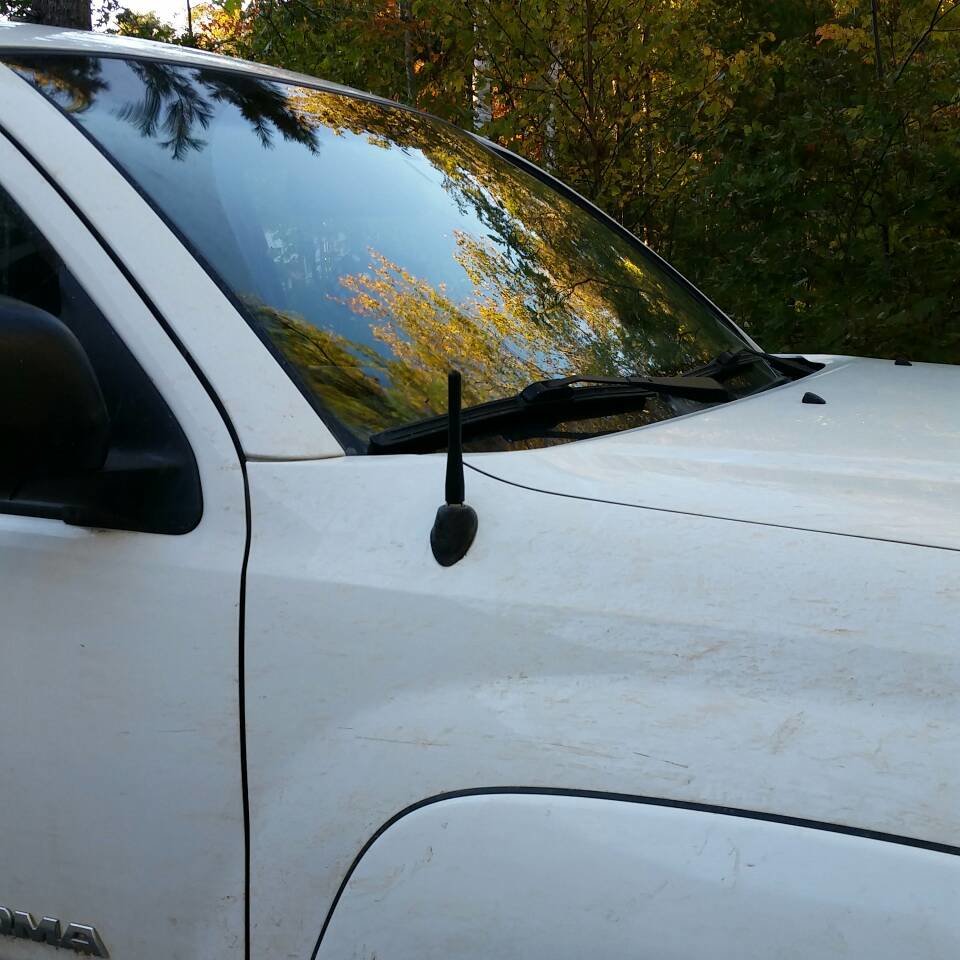

    Recently added a stubby antenna! Hopefully now it won't hit every tree known to man. Although if it does hit a tree, it'll probably break the mount. I thought it was a flexible one, I was mistaken!
