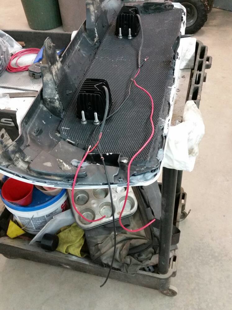

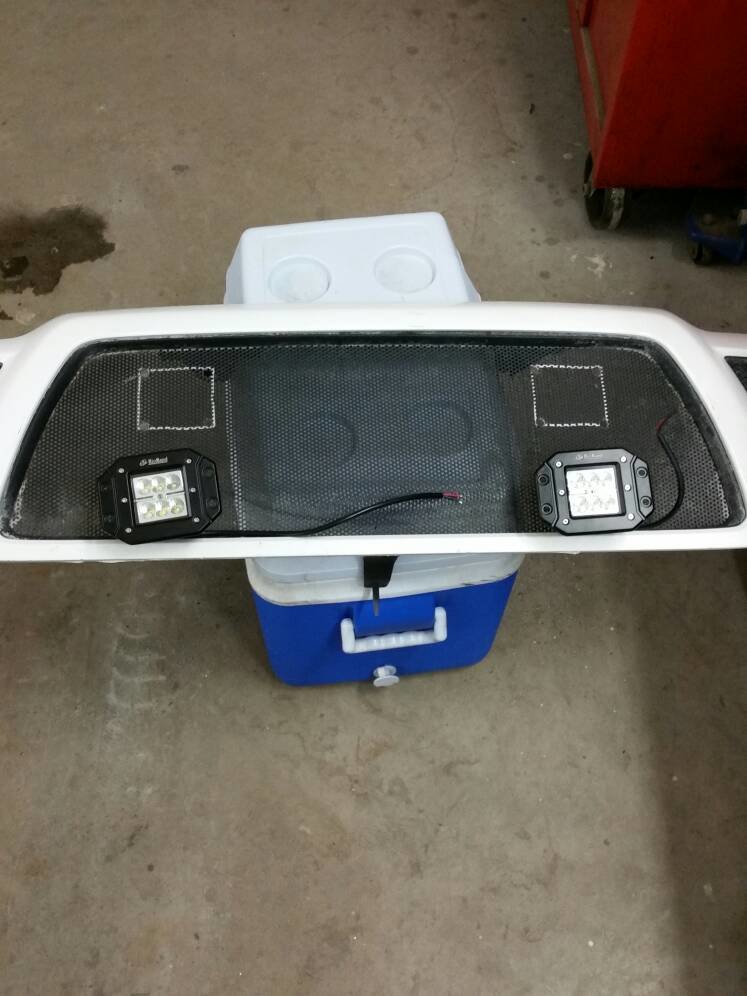

    Working on the grille still! Got the lights mounted and working on wiring them in.
    *the grille mesh is 1/8th inch plate and it's bolted in.. it shouldn't have any issues with the lights.

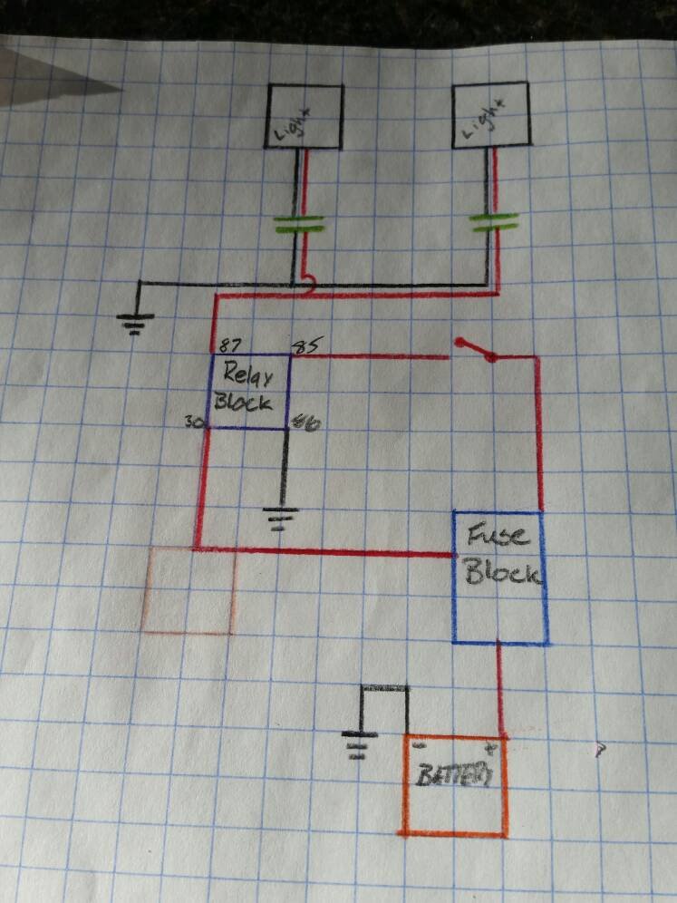

    I ordered a relay block with 4 relays in it, and my fuse block has 4 circuits in it, so I'll be able to expand while keeping everything neat.

    Mocking up wiring but decided to go a different route and use two, two pin connectors rather than just one. It'll make changing just one light easier.

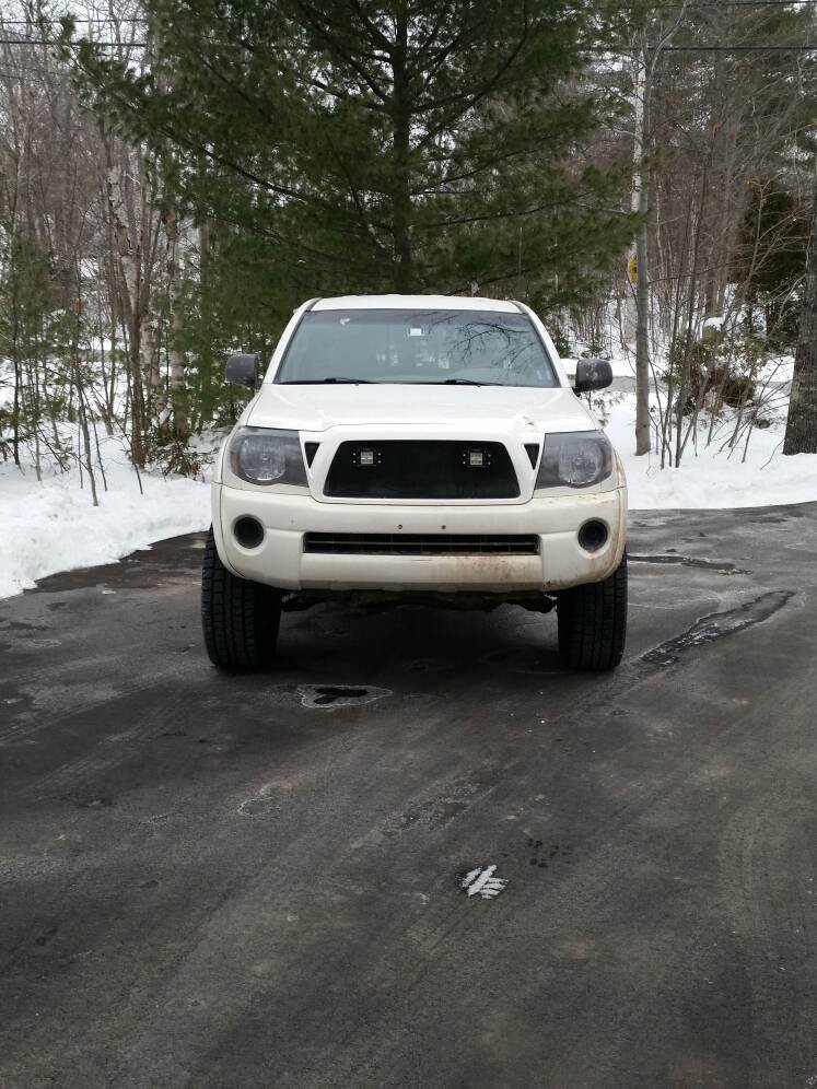

    All wired in!

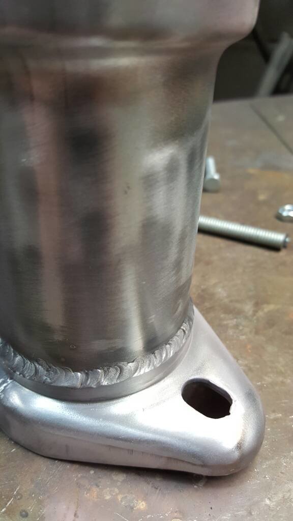

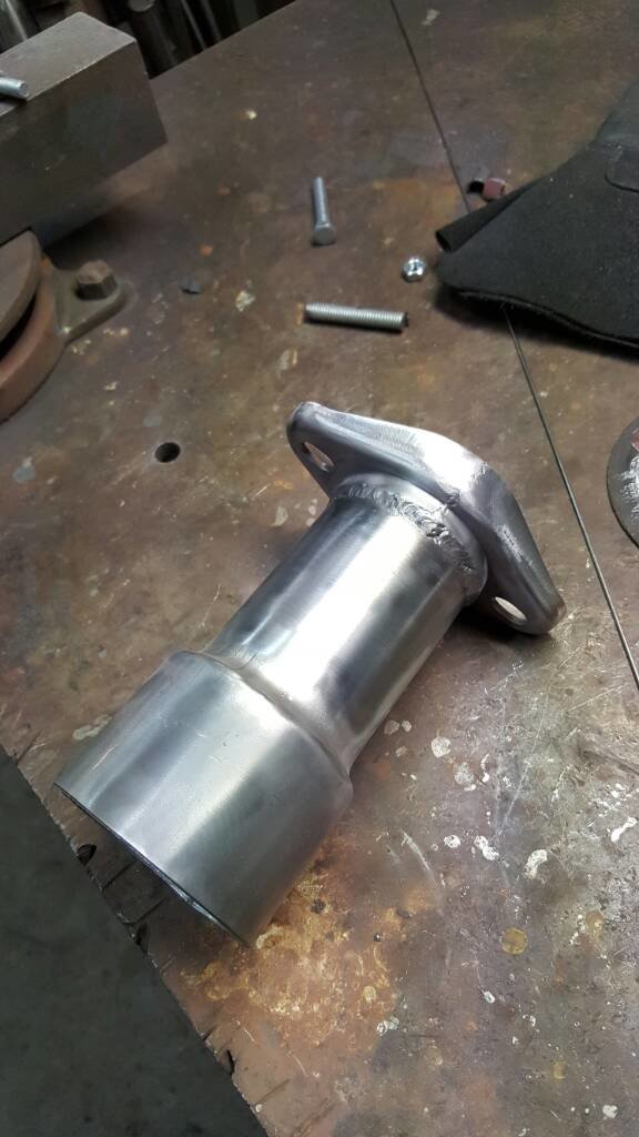

    Figured with safety coming up I should fix my exhaust.. might as well toss in the mid pipe that came with my exhaust (since it's for a V6 it needed some screwing around to make work).
