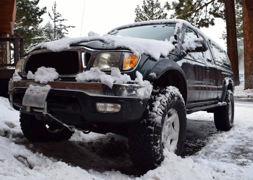

    9F95F50E-22C4-4411-8AB8-20D9588C6E16_zps_cf1c1b1c0167c2dd920c53b752503f91e0345e8d.jpg
    12/20/15
    093AF26C-BD38-47AF-99CE-BCF92790C0DD_zps_a6e731a4b01e3fffe6cfe584b14ddd62d94e916c.jpg

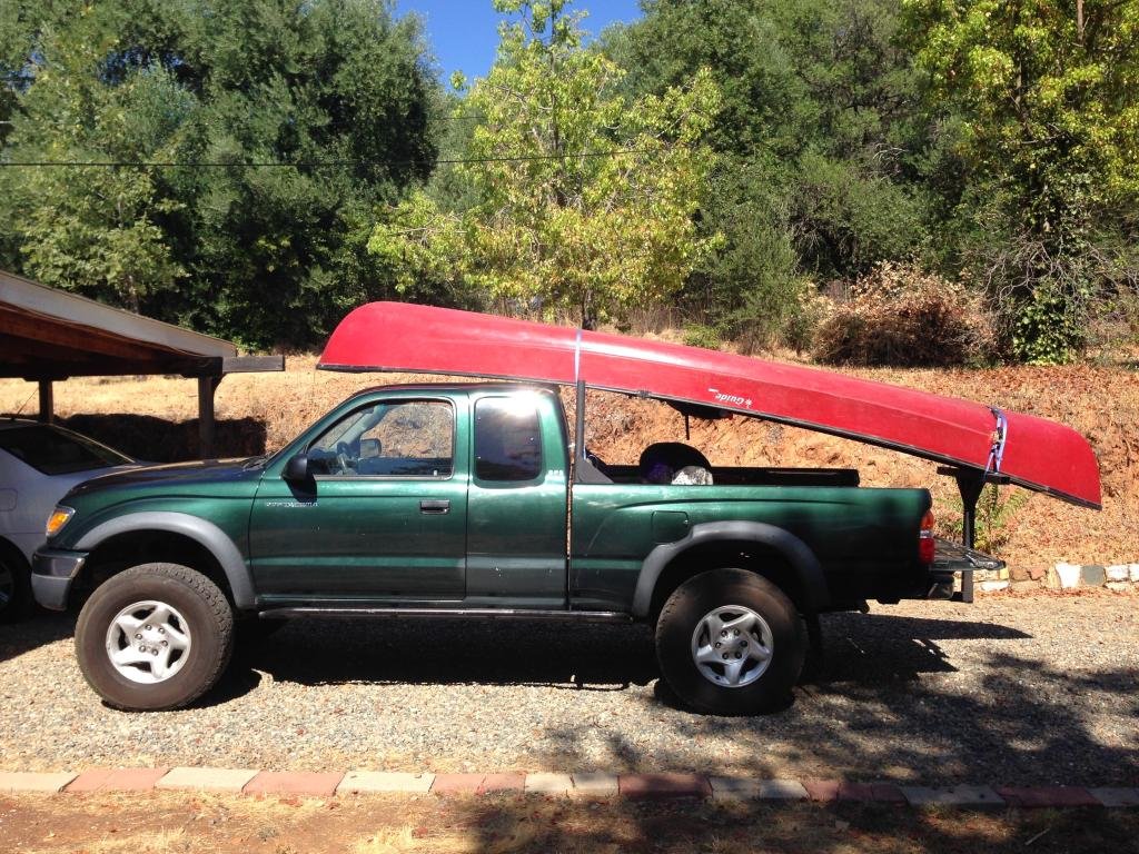

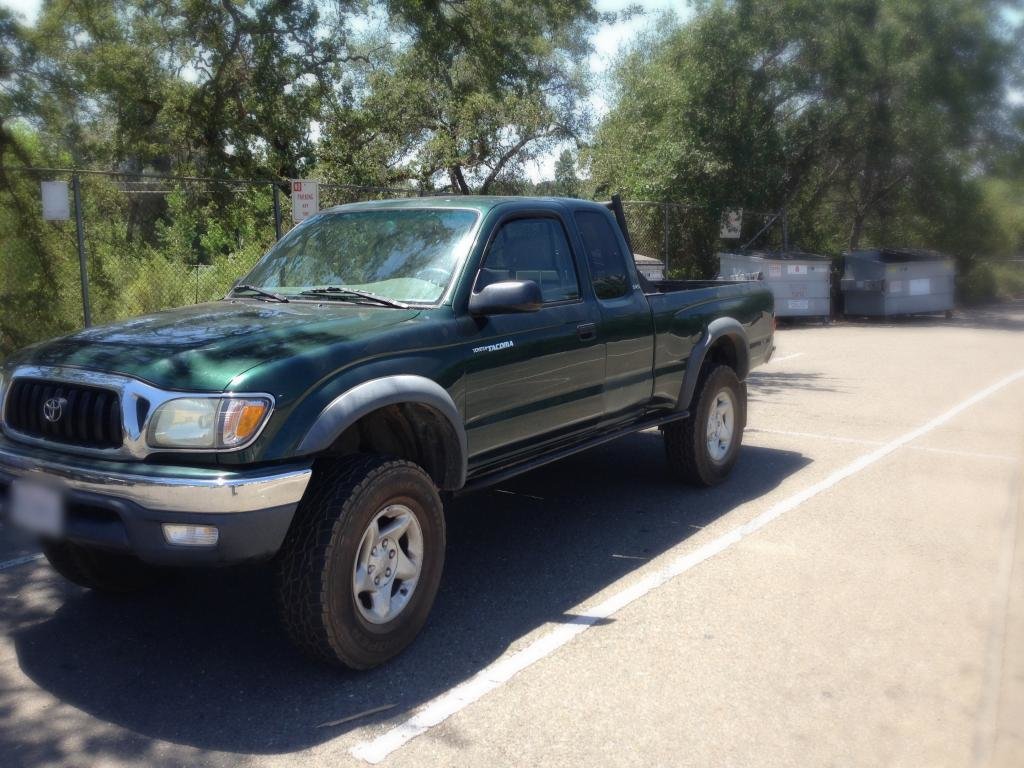

    Backstory:
    Recently sold my 94 Toyota xtracab 2wd truck in favor or buying a good friends 01 tacoma xtracab 4wd, for.... $750! Anyway, bad news was the 2.7 stock motor had over 200k and burnt valves. We bought a motor with 110k from a salvage yard and installed in less than two days under a carport, in winter, on osb because our driveway is gravel and motor lifts don't roll on gravel ;)
    So after installing the motor, new starter, radiator, belts and hoses, we prayed and started the truck up. Ran perfectly! So now at 118k on the used motor I enter TW to join ranks and search for mods.

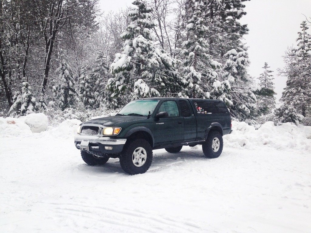

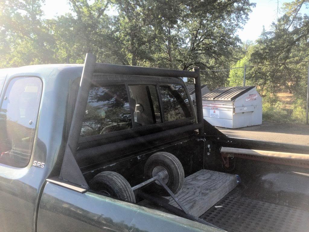

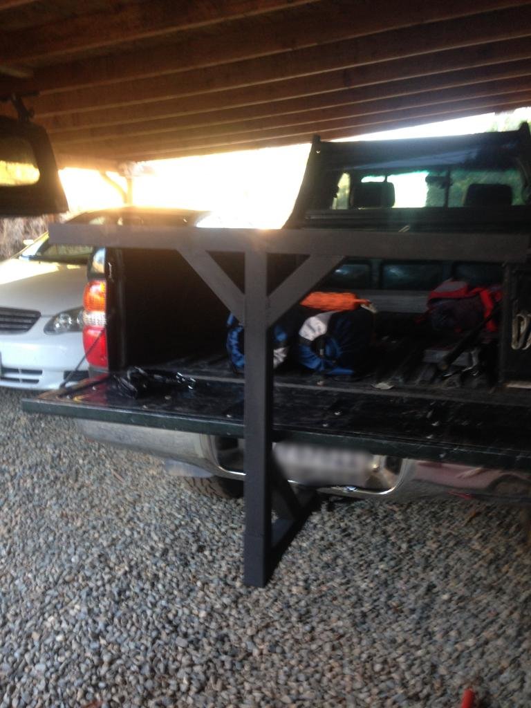

    Finally mounted my Allpro Rock Sliders! I cut down the overall length of the mounting bar because for my taste they stuck out way too far! It also helped that when I go them two of the four mounting plates had already been hacked off.
    To make sure I had my welding abilities up to par, I also built a headache rack with some scrap metal tubing I had laying around. Had to purchase a little more steel to build the receiver portion of my rack.
    d174ed8f-2c55-449b-b45e-91301ab2365e_zps_a1b9a65546577c46bc5cbd64a695f0c7574762ba.jpg
    C93136AC-C815-44E5-9F3D-92A459961E79_zps_bfed93b9f90a4dd449012f278d024376c3fcf865.jpg

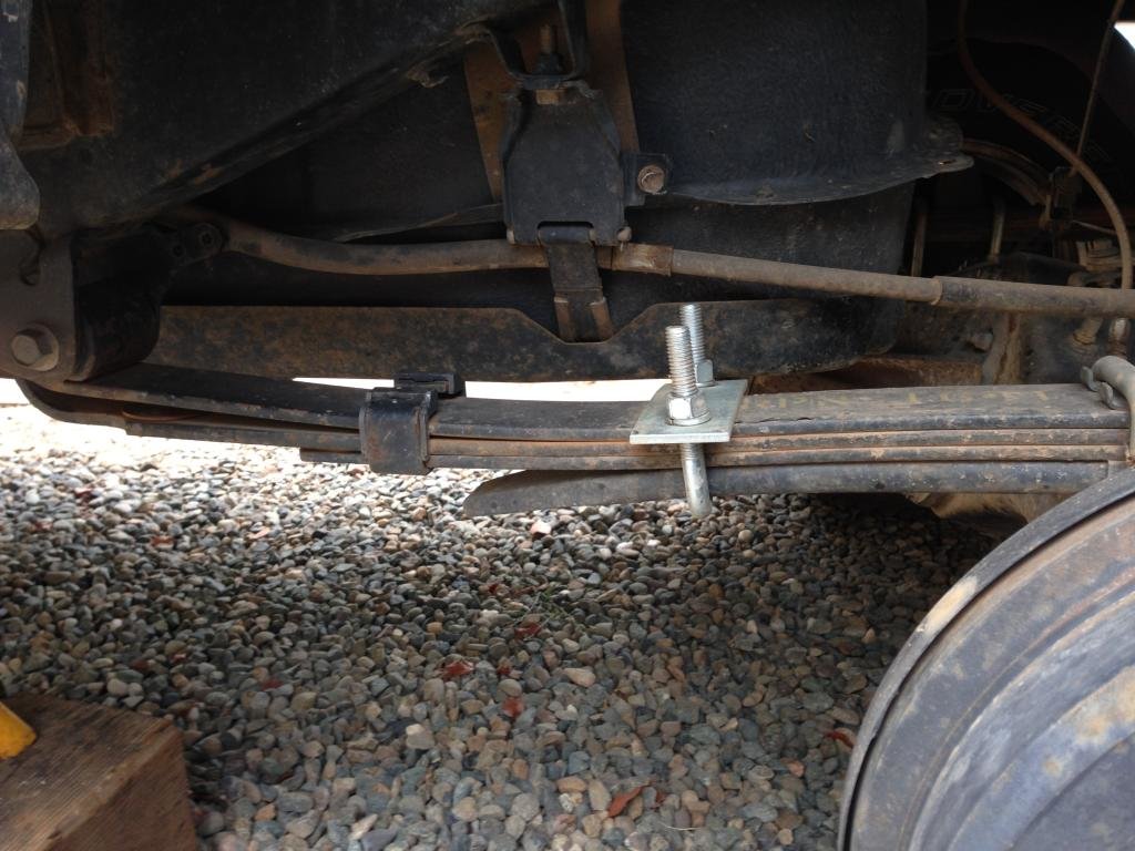

    Nasty reverse arch on the OEM springs

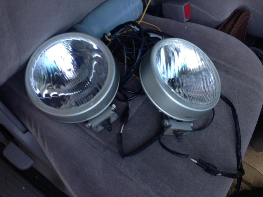

    110 Watt Super Rally IPF lights I just picked up
    87D20D9F-A37A-4C7D-B502-595063E89464_zps_1d6fb46a670e8794ae71d21294297ad737b1fcae.jpg

    Can I ask why your leaf springs are ubolted to overload?

    Its a ghetto way of extending the grace period between when you have to buy new springs and when you first realize you have axle wrap. There are a couple write-ups on here about it, after this result I would not recommend it!

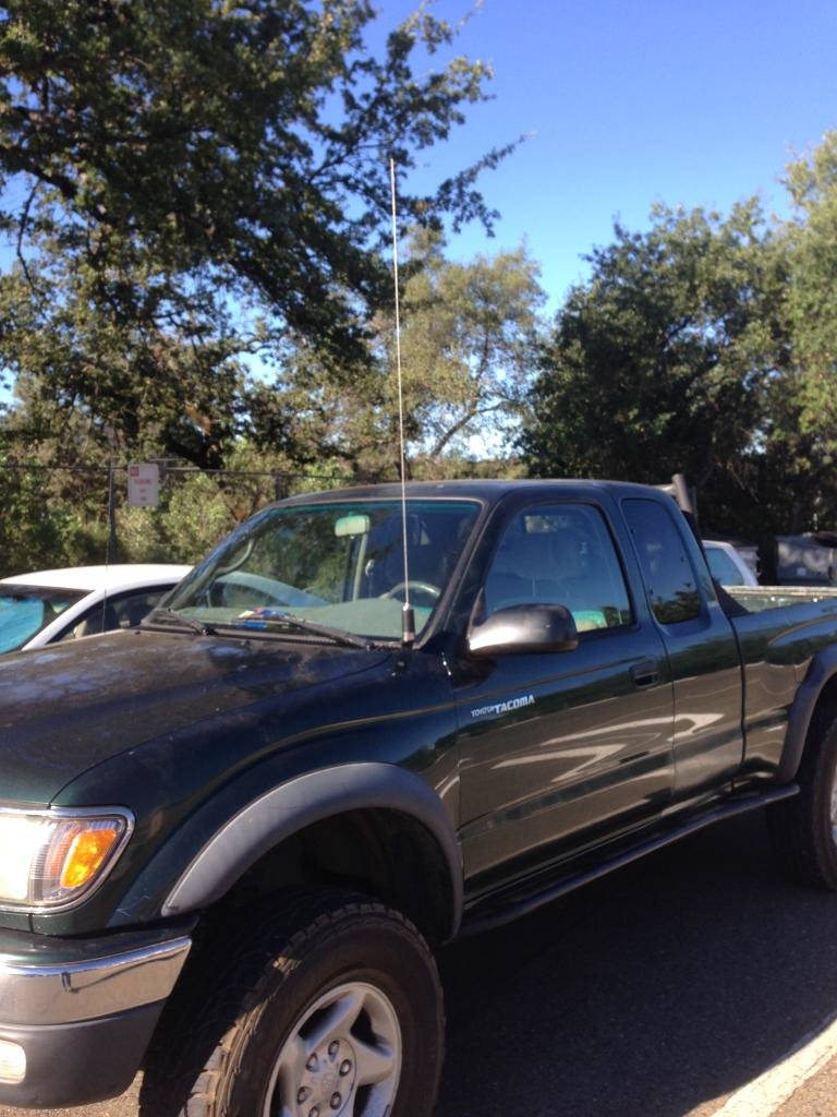

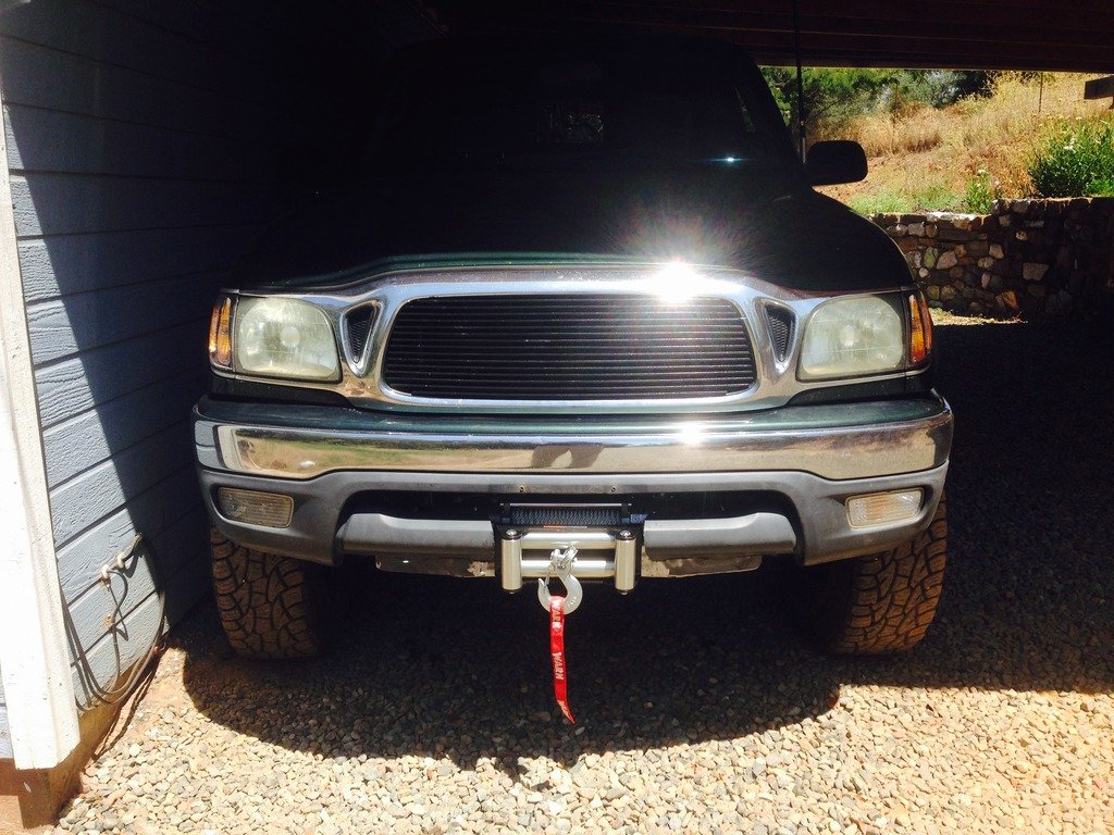

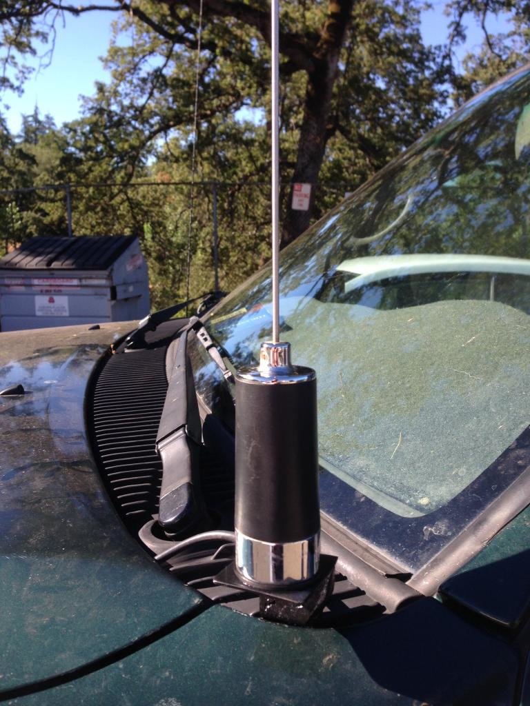

    After months I can finally say my CB works, buckled down and completed the antenna mount. Was trying to mimic the CBI design, kinda wishing I had paid them and could add another sticker to my growing collection. If it weren't those darn unhappy leaf packs I would be mounting a new 2-3' fire stick instead of this whip. :mad:
    46C444BC-7F2B-46A8-A033-9C408CD3D6E7_zps_ad3e9da9ccc6e663f6cb55c129c99f84d2d807de.jpg
    2CDD34EF-7D63-4B3C-8C28-18E290C56C1E_zps_674e74516257d4f5c2c54e2cba37231e846cac2d.jpg

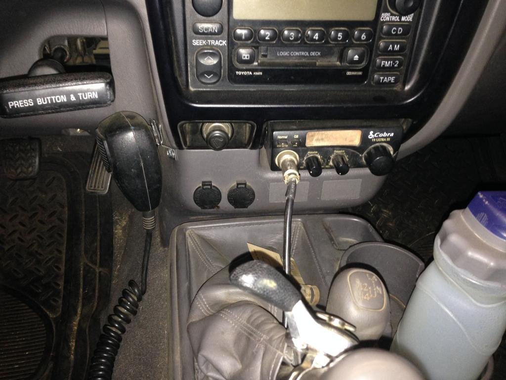

    Just a simple cobra 19 I kept when I sold my wrangler, pretty used and abused but still working well! 139ADA35-BA2C-4C4A-A240-1EFD8697F271_zps_3b2ea488c3ad0b28698dd00c9aaecd23acfb3822.jpg
