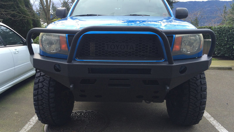

    It was too dark last night to get decent shots of everything on so I just ran out to snap a few more. Made some calls around to the local shops and nobody said they'd work with me on getting an alignment that wasn't oem spec. I'll be putting the stockers back on for now until I can bribe someone to give me more caster.

    Dynamic Diesel and Bear Alignment in Snohomish will. Just tell them to max our your caster and not go OEM spec. $109 for my last alignment.. Unless you try it yourself.

    Bit steep but thanks for the rec! If I fail horribly trying out jberry's diy I'll be giving them a call.

    As for the alignment, pretty much all shops won't adjust out of spec for liability reasons. I have the lifetime firestone alignment and take it there regularly. The people at the front desks won't play ball when I ask to get it to certain specs I want. So I just hang outside the bays and catch the techs when they pull the truck onto the rack and tell them what I looking for and usually hook me up.
