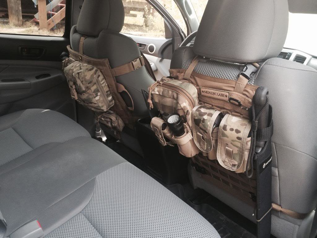

    OVERLAND / TACTICAL / BUGOUT:
    Spartan Tactical VMP-C
    Blue Ridge Overland Gear MOLLE Seat Panel
    48.5" Aluminum MOLLE panel behind the rear seats

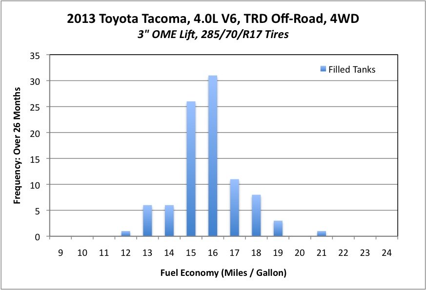

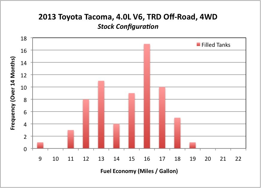

    FUEL ECONOMY:
    These fuel economy statistics were gathered through daily driving, trail riding, towing, and all other vehicle use. I keep my receipts from the gas pump and annotate the current odometer reading, and how many miles I drove on the tank I just refilled. I also make any relevant notes that might affect my fuel economy for that tank. I do not have a record of every tank of fuel put through the truck (receipt print errors, etc.), but I have a pretty good sampling. It is of relevant note that during the winters in Fairbanks, AK (October - April) I drove in 4WD all the time. I suspect that this would lower my fuel economy for those tanks.
    I have broken the statistics up by major modifications to the truck, such that I predict they would affect the fuel economy. They are: "stock configuration", "Post-Lift", and "Post Pelfreybilt Front Bumper" (plus Warn winch, IFS & Mid skid plates, and LED bars). I will post the statistics of the "Post Front Bumper" once collected, as I do not have any data for this phase of the build.
    STOCK CONFIGURATION:
    ODO: 307 - 20,192
    Date: 10 OCT 2012 - 11 JAN 2014
    Average MPG: 15.3 (miles / gallon)
    Standard Deviation: 2.1
    Number of Tanks: 69
    POST LIFT:
    ODO: 20,426 - 63,378
    Date: 15 JAN 2014 - 4 MAY 2016
    Average MPG: 16.3 (miles / gallon)
    Standard Deviation: 1.5
    Number of Tanks: 93
    I would have expected the "Post Lift" statistics to be lower than the stock configuration, however I think the truck wasn't broke in yet. I might have dropped fuel efficiency with the larger tires (without regearing), but gained more fuel efficiency with the break-in.
    I will be curious to analyze the fuel economy statistics after adding all of the weight in armor.

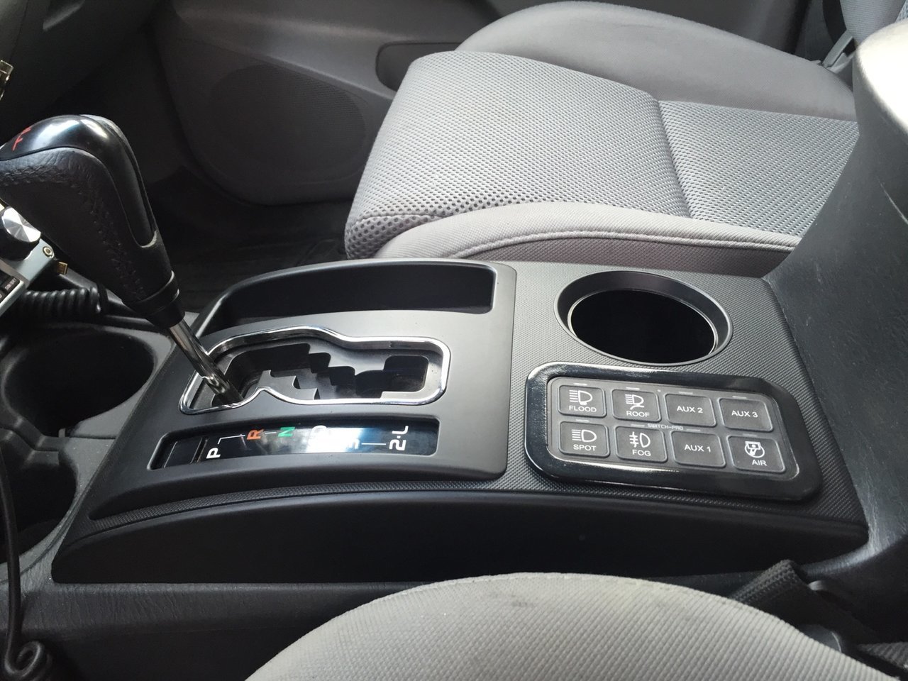

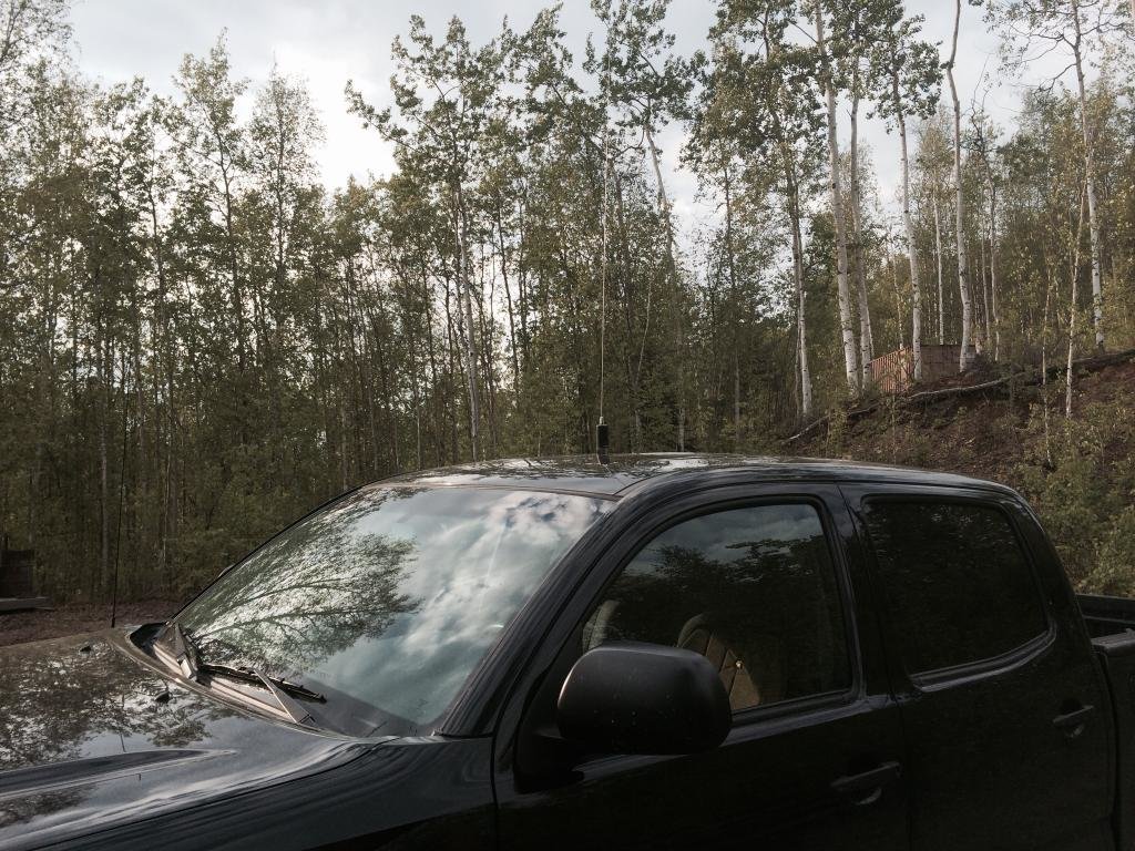

    I drilled a 3/8" hole on each side of the console to run the antenna cable (right) and the power cable (left). Other than that, I simply mounted the CB radio itself with industrial velcro to the bottom plane - one stack (male/female pieces) up front, three stacks in the back to achieve the seen angle. If the radio was mounted parallel to the bottom plane - one layer of velcro on the front and back - the radio would contact the top of the space, and it would have interfered with the cigarette lighters (lids, and whatever you wanted to plug in). The outer dimensions of the radio fit within the space seen. Also, the antenna cable plugs into the back of the CB, (I used a 90 degree angle plug here), which pushes it out about 1" from the back wall. If one were so inclined, they could remove the center console plastic, make a hole for the power cable and antenna cable, and mount the CB radio itself flush against the back wall. I will probably do this when I switch over to a HAM radio.
    The antenna was permanently mounted to the roof. A hole was drilled, and the cable was ran along the head liner, under the side curtain air bag, down the door sill and under the dash to the CB radio. See picture of antenna below:

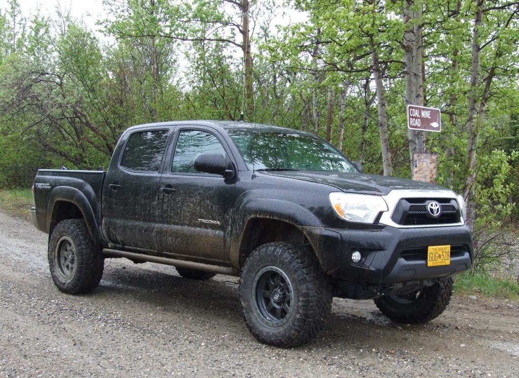

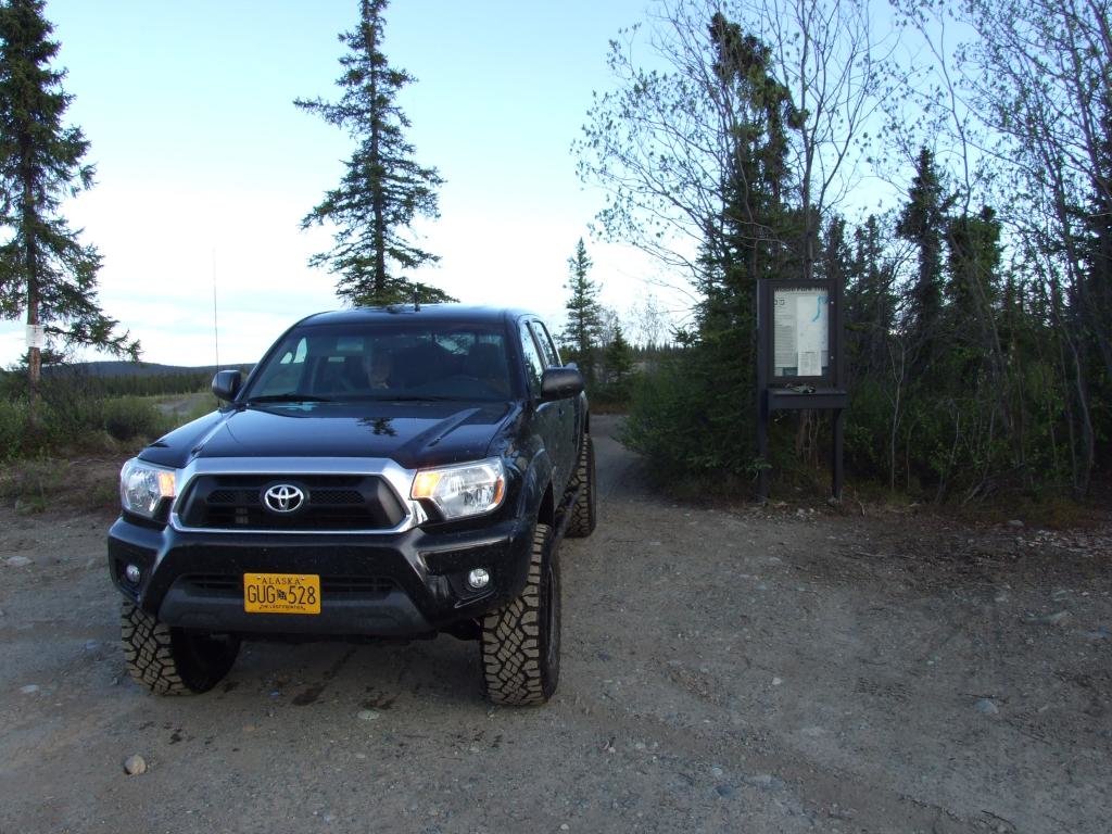

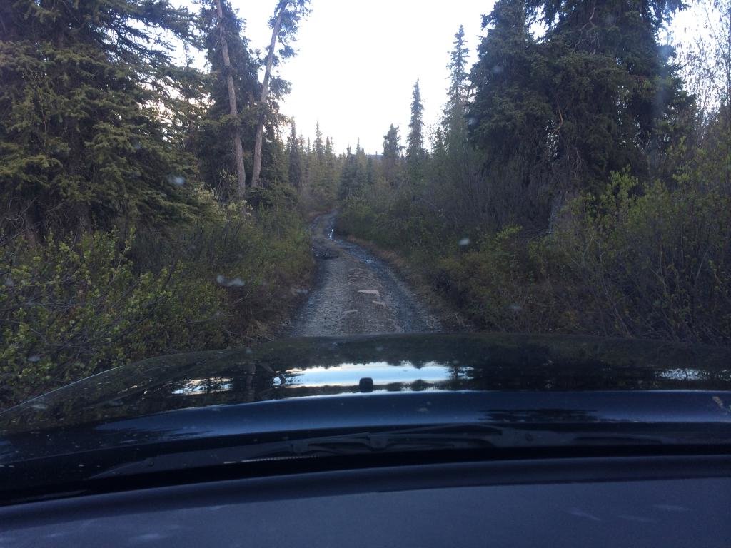

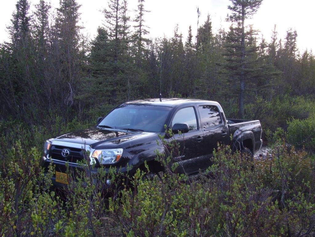

    Hey TW,
    I just completed my latest adventure trip in Alaska. My girlfriend and I were gone for five days, and drove over 1,300 miles. We started in Fairbanks, AK and drove south to Seward and Homer, AK via the Richardson Highway. On our return, we drove north on the George Parks Highway, stopping for a short visit into the Denali National Park.
    We took the truck on three trails starting off the Richardson Hwy; each one harder than the last. I have quite a few new scratches that run almost the entire length of the truck from a narrow trail meant for ATV's, not trucks. Oh well, it was quite an experience and worth it. I just had the truck professionally washed and waxed, and most of them came out. A few trail scars give it character :rolleyes:
    On our next trip, we will go back to Denali to try a jeep trail that we didn't get a chance to try. This trail should take us to the "magic school bus" where the student from Emory (e.g. "Into The Wild") died. We also want to make the drive up to Prudhoe Bay / Deadhorse, AK.
    Below are some pictures of the Tacoma along the way!
    COAL MINE RD: mile 254 on the east side of the Richardson Hwy
    FISH CREEK TRAIL: mile 190 on the east side of the Richardson Hwy
    MIDDLE FORK TRAIL: mile 169.5 on the west side of the Richardson Hwy
    Starting the trail...
    We survived! ... but we didn't go all the way down.
    A BEACH: near Homer, AK
    A BRIDGE: Glacier overlook off the Glenn Hwy

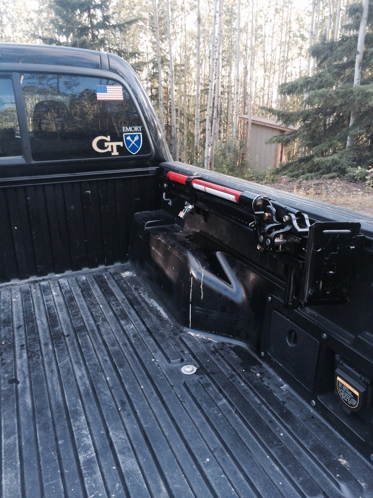

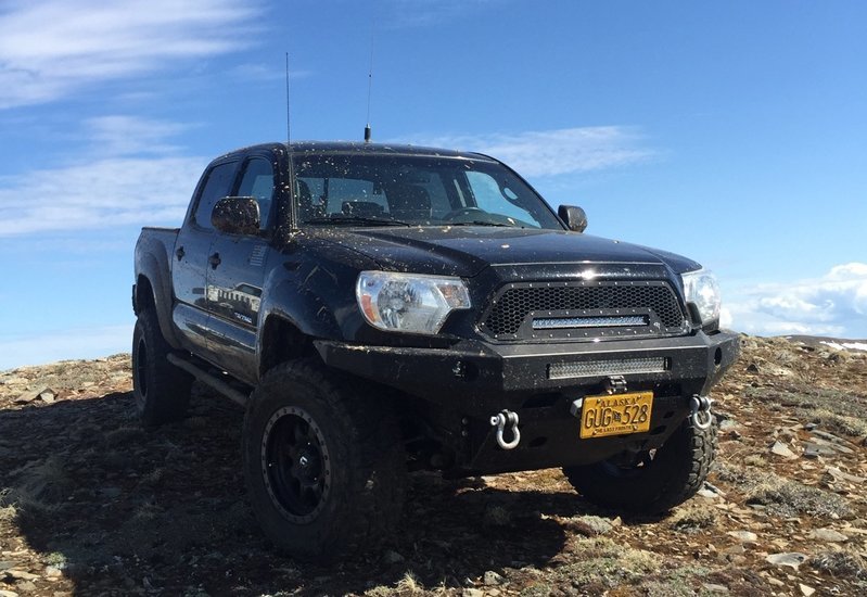

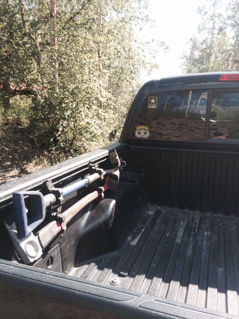

    Had a few soldiers get their trucks stuck driving around post; giving me a great excuse to pick up a HiLift Jack :)
    I then mounted my axe and shovel on the other side of my bed...
    I went on a quick "test" trip and found that the HiLift rattles a lot. I added a handle holder (single plastic slip on thing), so hopefully that will snug everything up.

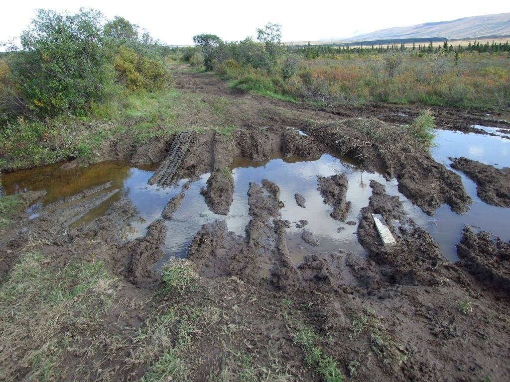

    Stampede Trail
    Entering Stampede Trail Driving down a river on Stampede Trail StampedeTrailRiver2_zps06724223_4d8700414c18589a14cb0fe2d31f78ef0ad92aa8.jpg
    Muskeg Mudholes. Many more than just this!
