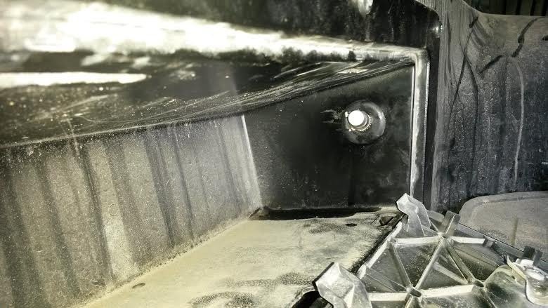

    Installed a Pop & Lock PL8540 today. Works with your remote and ignition key.
    It works great! No more stolen tailgates, and added security for the contents. Pretty slick item. A very easy install, except for accidently pulling the weather pack connector off of the wire. Grrrrr... it took half an hour and a wobbly pop to disassemble and repair. Also aligned the back up camera so the grid lines in the mirror display are now ligned up with the big-ass hitch.
    Also did the clamp mod on the tailgate a while back. It's a cheap and easy theft deterrent for the gate. The Pop & Lock is for the contents. I wouldn't want this posse of Husky's to disappear.

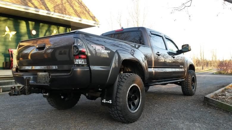

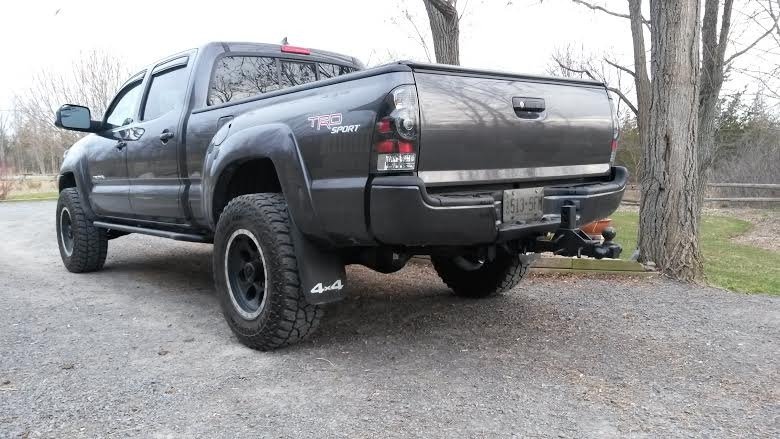

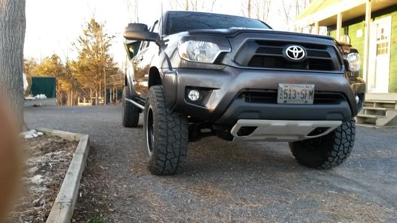

    Lookin' better today. I finally installed the front 2.5's set at 2" of thread for a real 3.5" lift.
    CH to fender measurements:
    Front right = 23"
    Front Left = 23"
    ... and a 2" AAL to compliment the rear 2.0 resi's and 1 " block. And cleaned up and painted the frame. Gonna repaint the diff and leafs tomorrow.
    Rear has a 1" block and 2" AAL
    Right rear = 25"
    Left rear = 24 1/2" (Full tank of gas)
    Ignore the butterflies and dragon flies in the background. It's a wifey thing.
    Goodbye and good riddance ReadyLift.
    Hey OZ, it now runs like a dream. No more bump steer or under steer while cornering. It rides and handles like a 'truck' limo. If you have the money, go for it! You won't be disappointed.
    I'm a happy man.
    Gonna try to install the front and rear Avid bars tomorrow too.

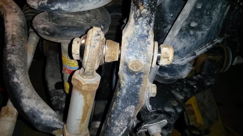

    While installing the Icons I discovered that the All Pro end links are all rusting to shite, and that's only since December.
    Gonna have to give them a call.

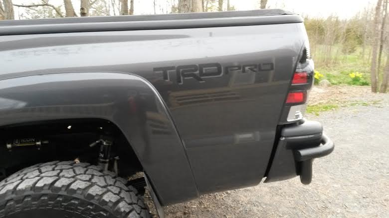

    I sweetened it up a little more.
    I put on some flaps...
    ... and a decal and some emblems...
    There's not one other like it in Canada.
    Let the shit storm begin!

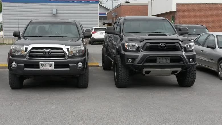

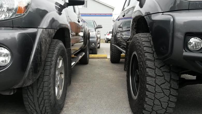

    So I park beside a factory issue TRD Off Road ...
    ... and took a closer look ...
    Which one is the Off Road vehicle of choice?
    I can't wait to park beside a factory Pro when I go to the US this summer.

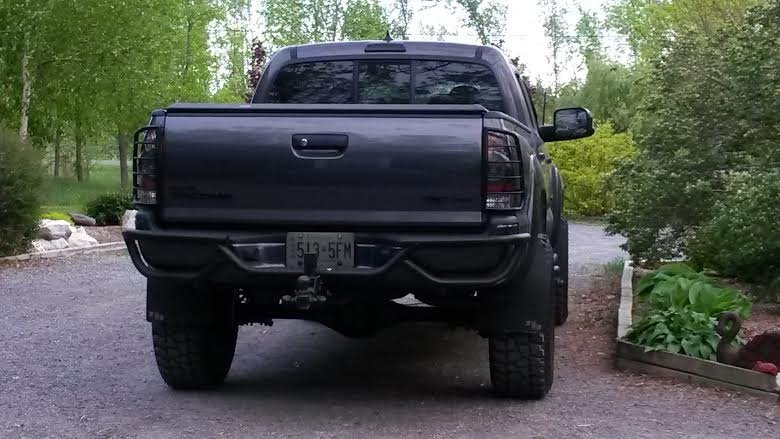

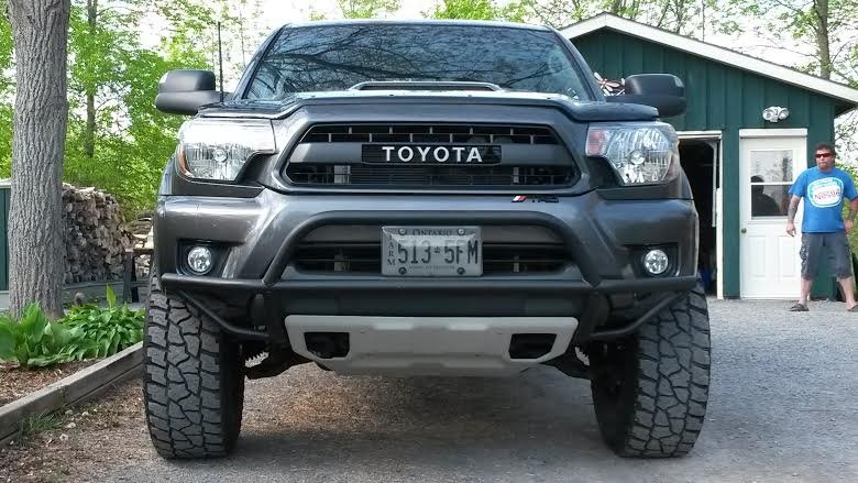

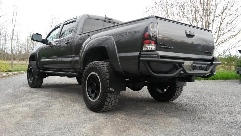

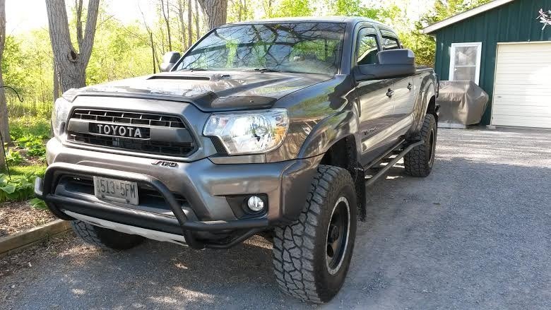

    I got some tail light guards that I bought brought up from MA on Sunday. I sanded them down, put three coats of adhesion primer, three coats of EZ Bedliner, and two coats of copolymer clear coat.
    I also installed the Pro Grill insert and smoked OEM headlights that came with them!
    I'm liking it...
