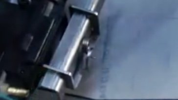

    Hi folks, was wondering if anyone else had this problem. I can't get the lock to work was wondering if anyone had a fix.
    What i'm showing in the video is when the tail gate is down, the lock stays locked, but when i raise the tail gate, the lock drops due to gravity.
    Thanks in advance.
    https://www.youtube.com/watch?v=b70K0gGJ80M&feature=youtu.be

    It happened to me this summer, there is a little spring pivot that keeps the solenoid from dropping back down when you raise the gate. It disappeared and could not find it inside the gate. I emailed them and they sent the spring out to me in a few days. It was not warranty, but just mailed it because the value of the part was not worth the hassle. Your solenoid is fine if it moves.
    You can see the spring in the center of this picture, the round coil. Sorry for the quality, I took it from an install video.

    Definitely missing the spring, thank you for the feedback!
