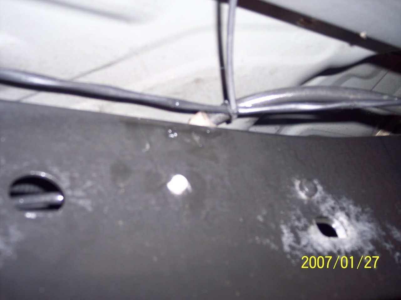

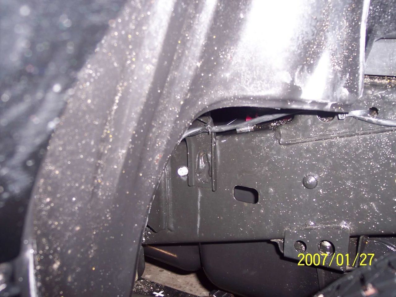

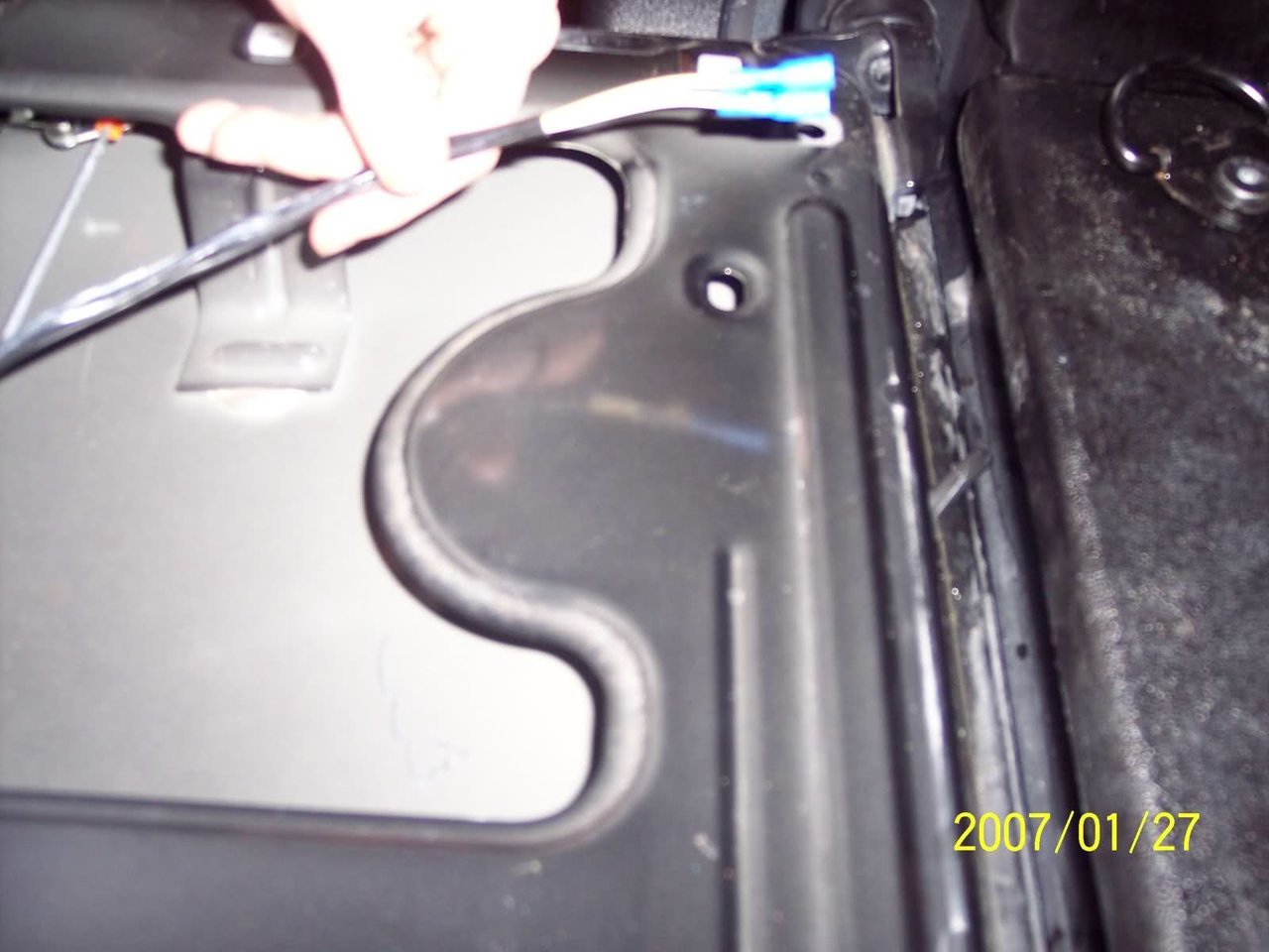

    Here are the pictures from the installation we did this weekend on my 2005 double cab.
    After removing the tail gate inner cover, using torx screwdriver.Short wire from kit is run threw tailgate drain hole closest to drivers side. This is tight, we used white lithium grease on the wire insulation to make the wire pull easier.
    Wire tie the cable along the frame, I attached them to the wire looms running along the frame. The wire ties come with the kit.
    More wire ties. The kit comes with everything you need.

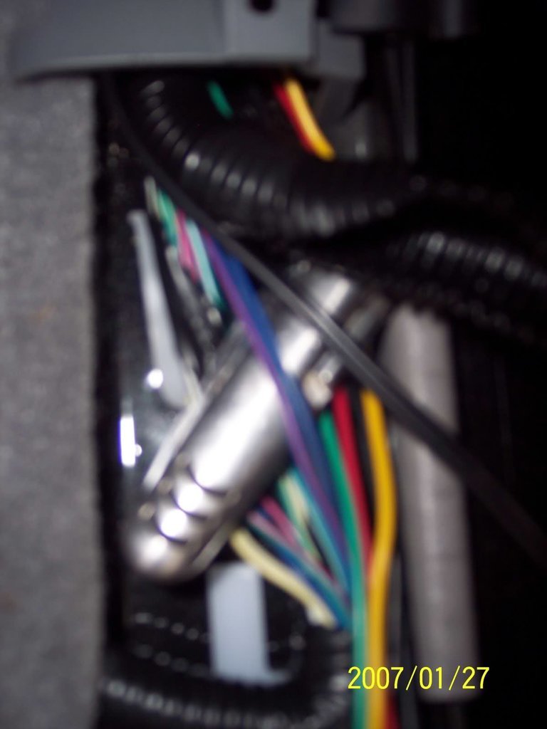

    We accessed the wires for the door locks under the sill plate on the drivers side. The technical support from DynoLock was awesome, I called with a question regarding the wire colors to connect to Jim answered all my questions quickly and accurately. This was on a Saturday afternoon !!!
    Wire colors blue with pink stripe and blue with black stripe are the lock/unlock on the Tacoma wire harness.
    This lock really locks down the tailgate. I purchased the heavy duty style, which has a lifetime warranty and a $2000.00 insurance policy against theft caused by breaking in threw tailgate. Installation time was 2 hours, I took my time and was dealing with a wet frame, from snow, which slowed up the wire tie installation a bit. I recommend this product, I hope this is helpful, thanks for looking

    Here is the picture of the wires underneath the door sill.
